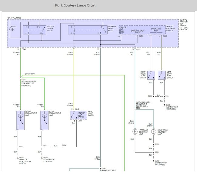

interior lights and four wheel drive lights quit working.
Feb 21, 2017 at 10:22 AM
Experienced Mechanic
55,603 POSTS

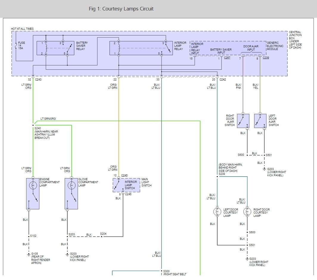

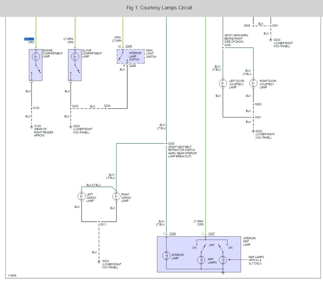

Hey Bobby,
It looks like there is a interior light relay that could be bad, here are some wiring diagrams so you can do some testing to get the problem fixed.
Relay test guide
Please let us know what you find so it will help others.
