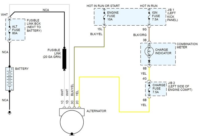

where is the alternator fuse located?

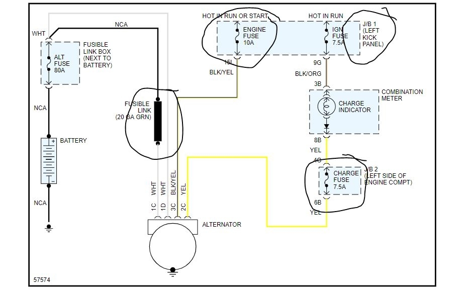

Good afternoon,
There are three. I attached a diagram and circled the fuses for you and the location is identified.

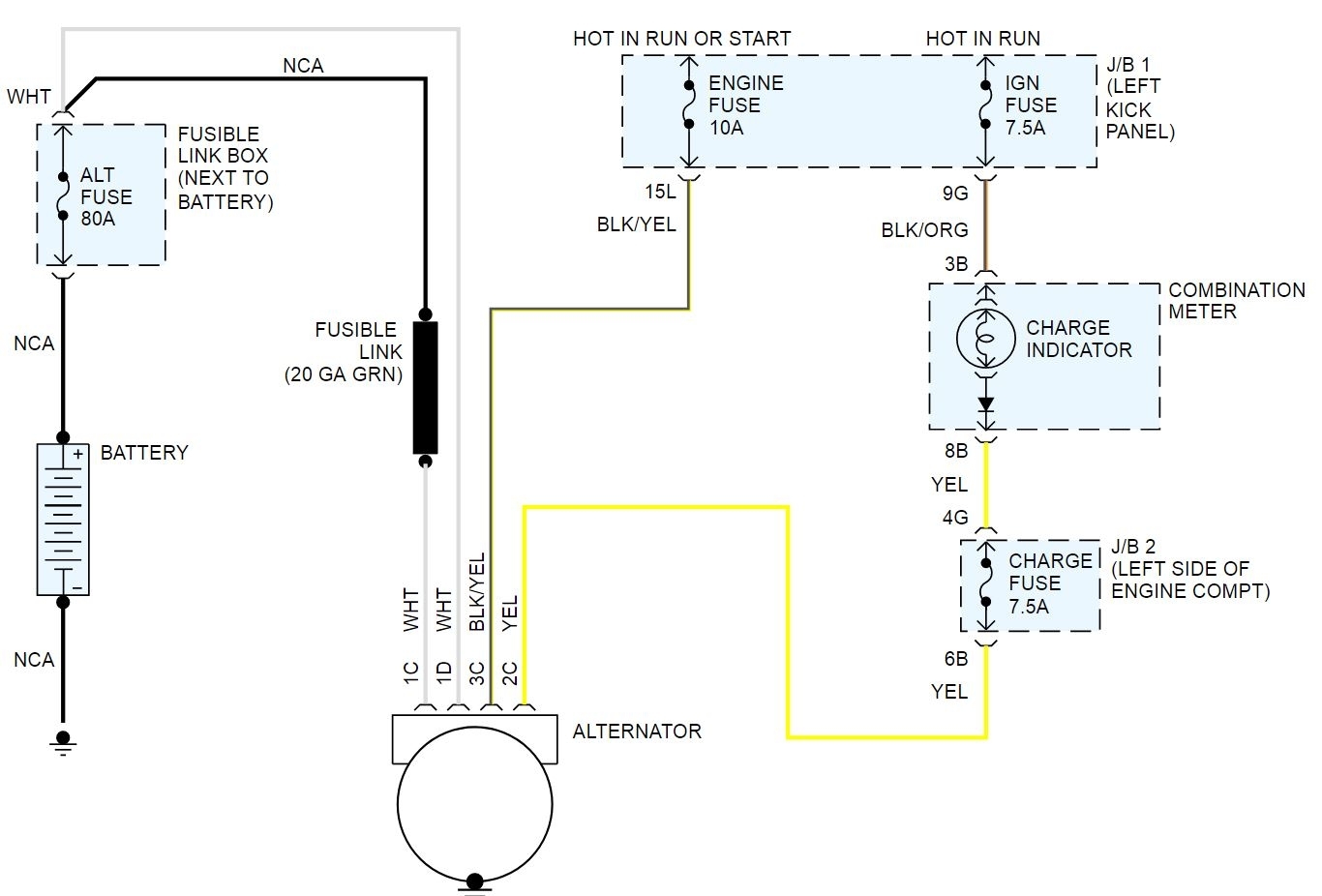

Welcome to 2CarPros. There are replaceable fusible links in the system. The main link is in a box nest to the battery. That is an 80 amp part. Then in the line to the alternator there is another fuse link that can fail.
