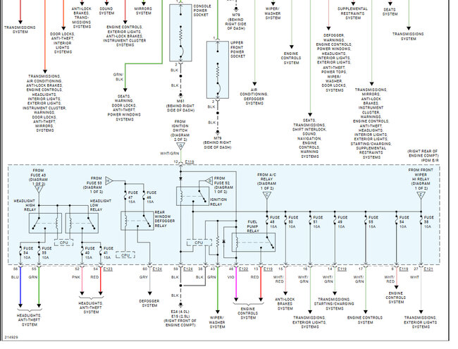

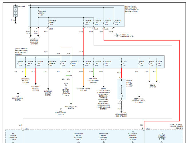

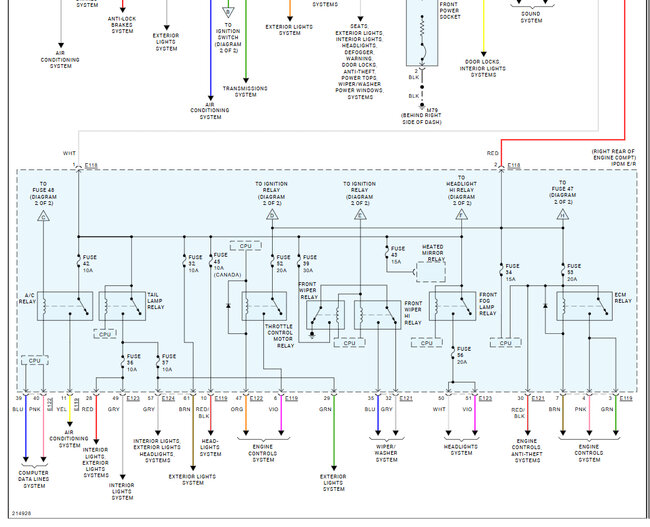

I need a pinout of idpf fuse box please
Apr 23, 2026 at 10:37 AM
Experienced Mechanic
55,616 POSTS
I don't have a pinout but here are the wiring diagrams so I hope they will work for ya. Check out the images (below). Let us know if you need anything else..
