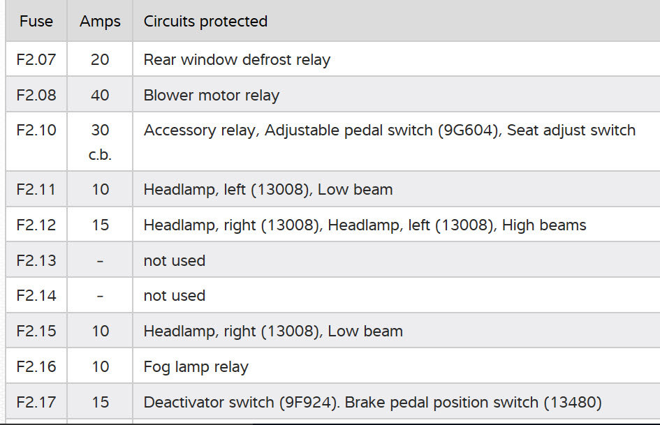

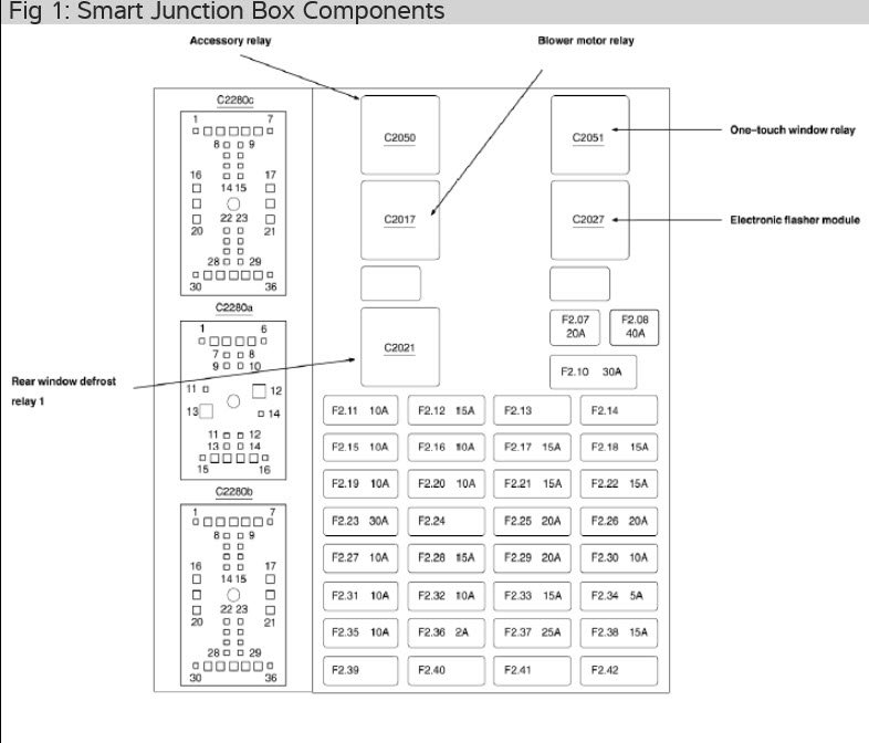

I need a diagram of interior fuse box
Nov 28, 2016 at 3:28 AM
HMAC300
Experienced Mechanic
48,601 POSTS

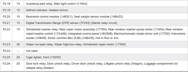

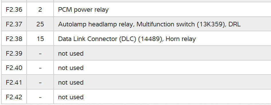

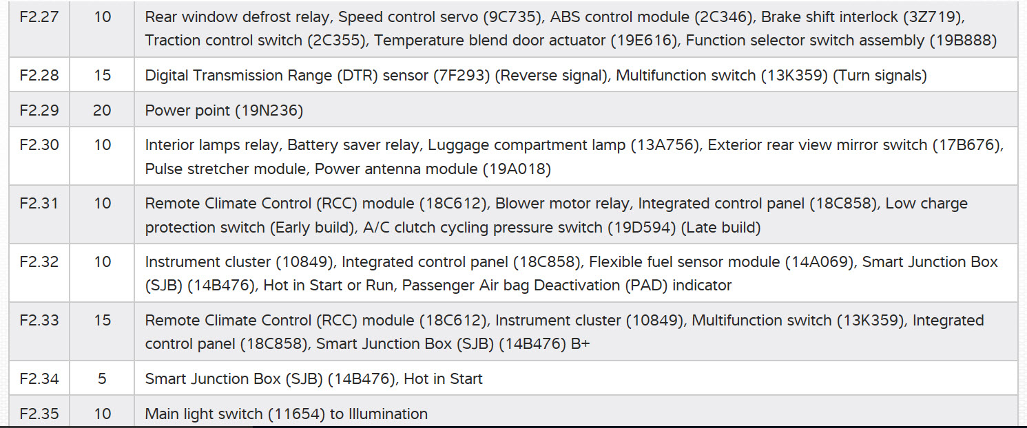

I hope you are meaning what fuse is for what. see pics
