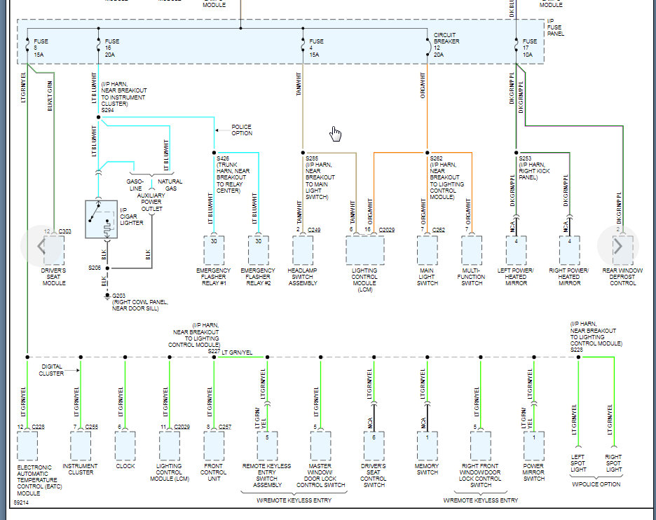

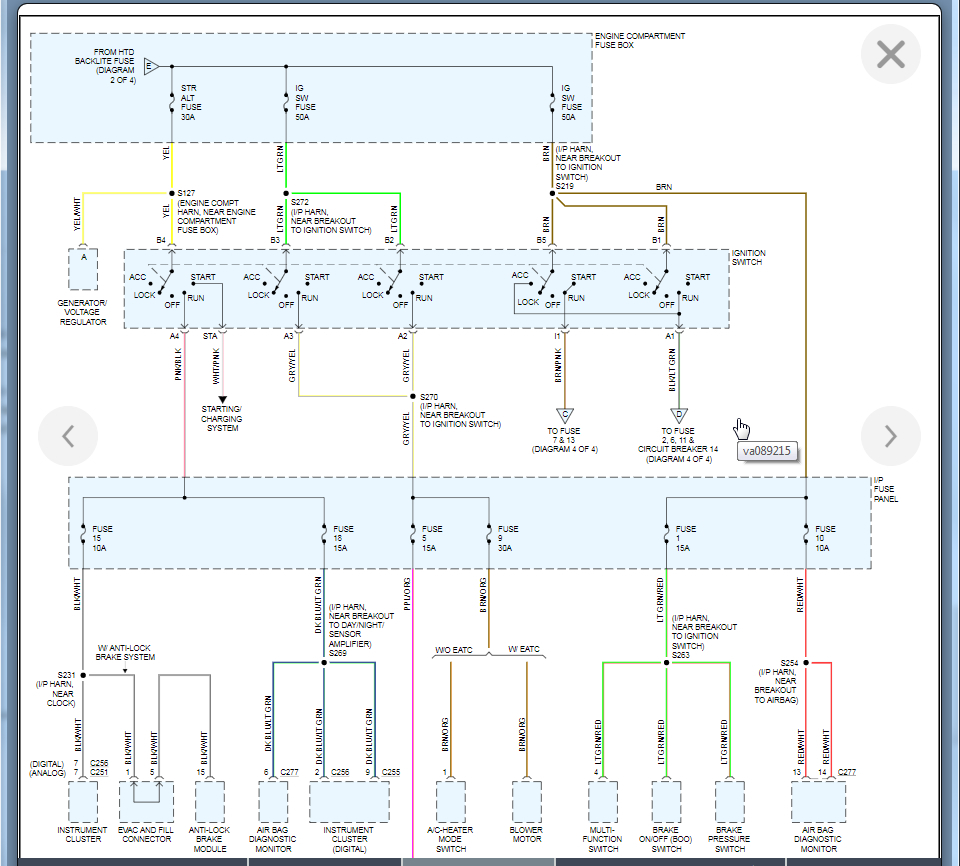

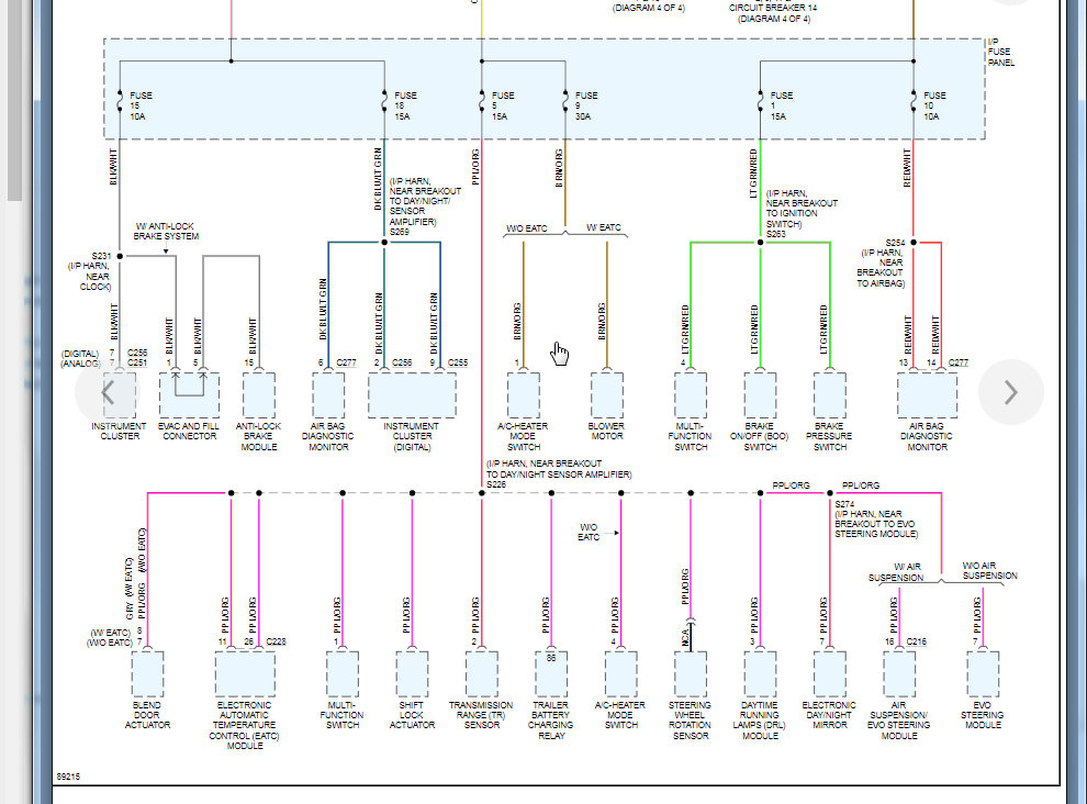

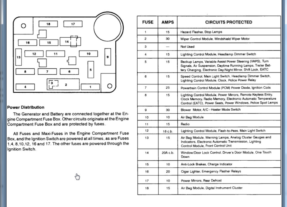

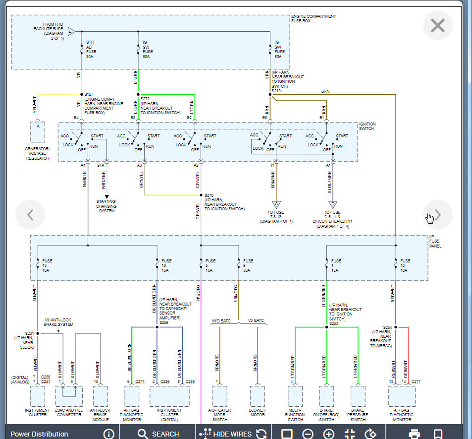

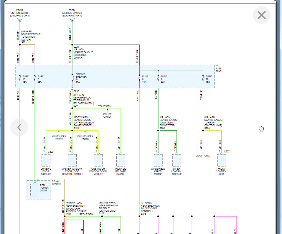

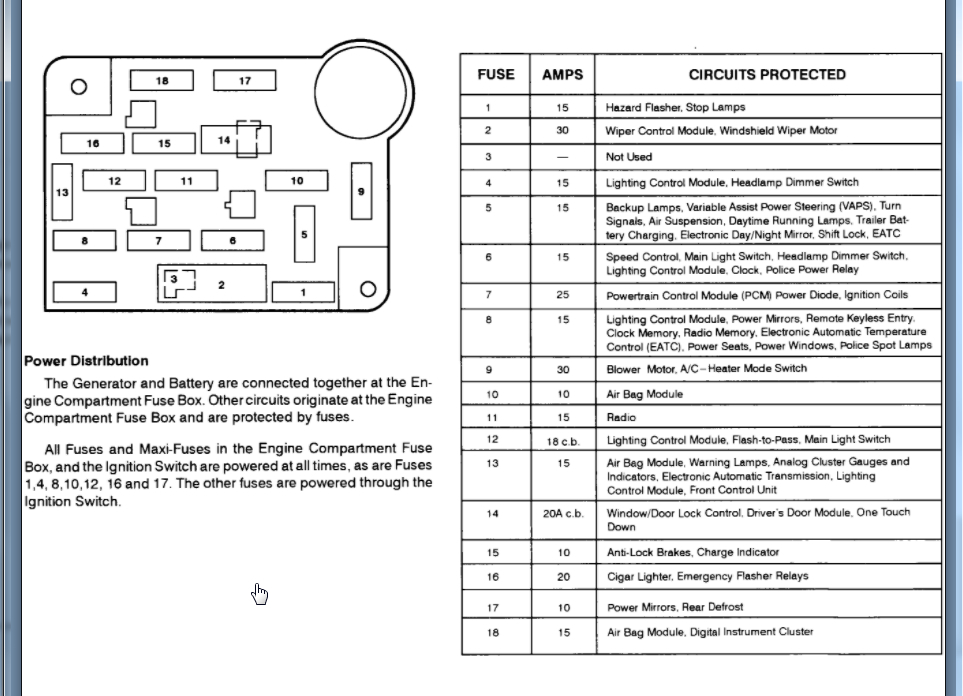

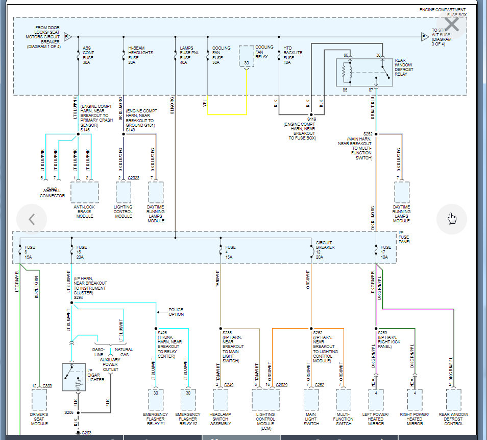

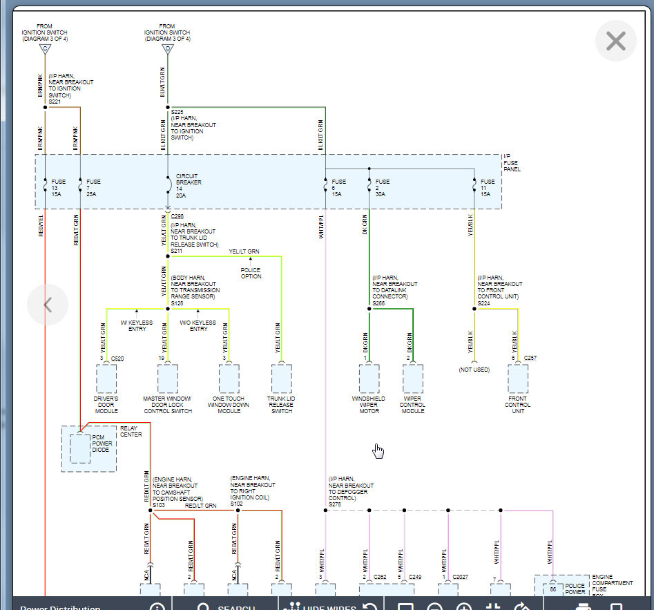

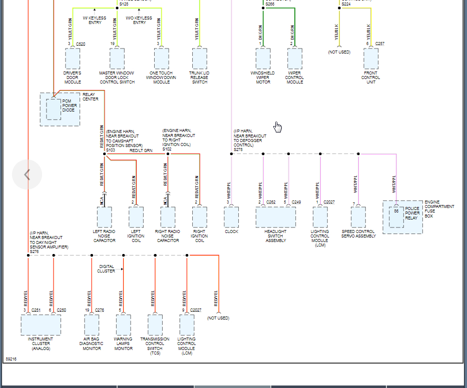

We can provide that but I just want to make sure what you are looking for because if you are looking for the wiring diagrams for each of these fuses, that is going to be a lot of diagrams. They don't have one diagram that shows all the circuity for all the fuses. However, they have what is called a power distribution diagram that shows the power flow from the fuses. I attached those for the IP fuse box.
Let us know if you need something different. Thanks

That's the fuse box inside the car. I need those under the hood.

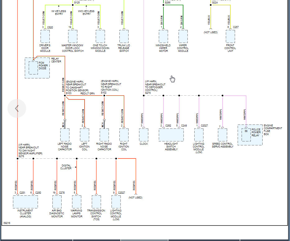

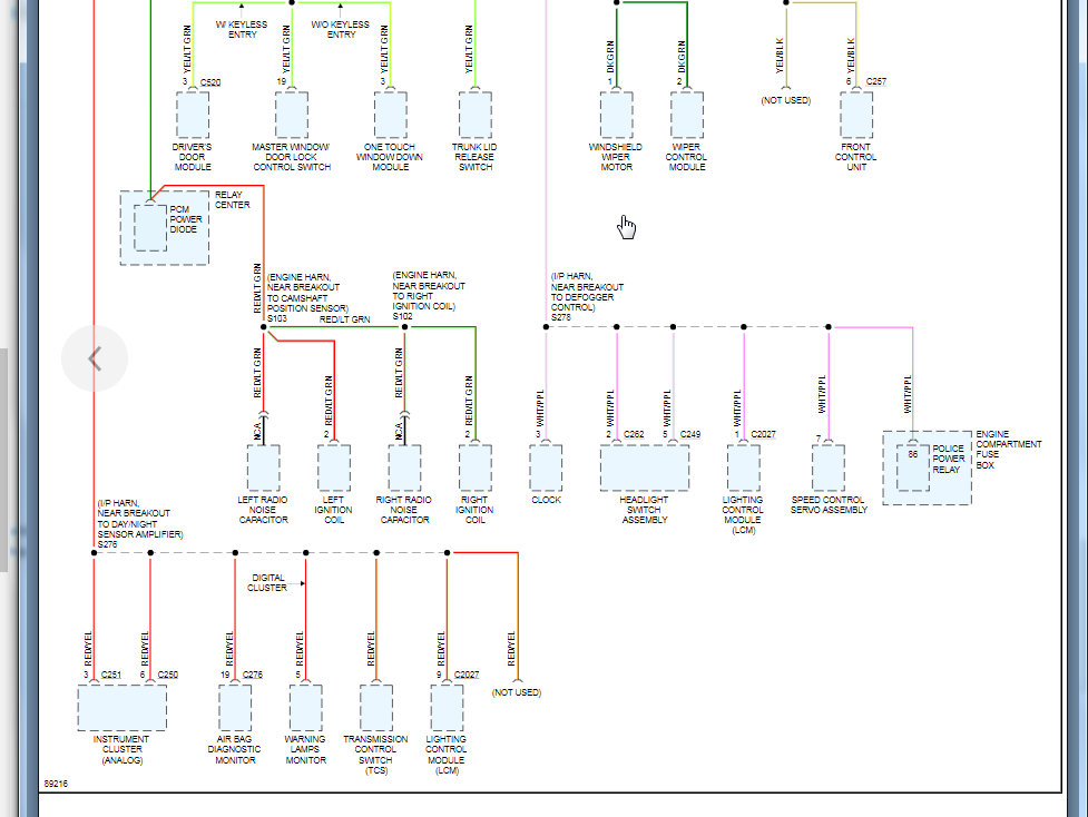

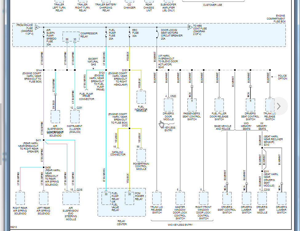

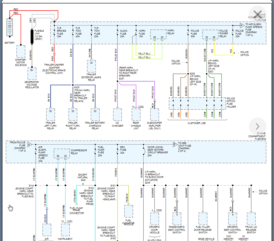

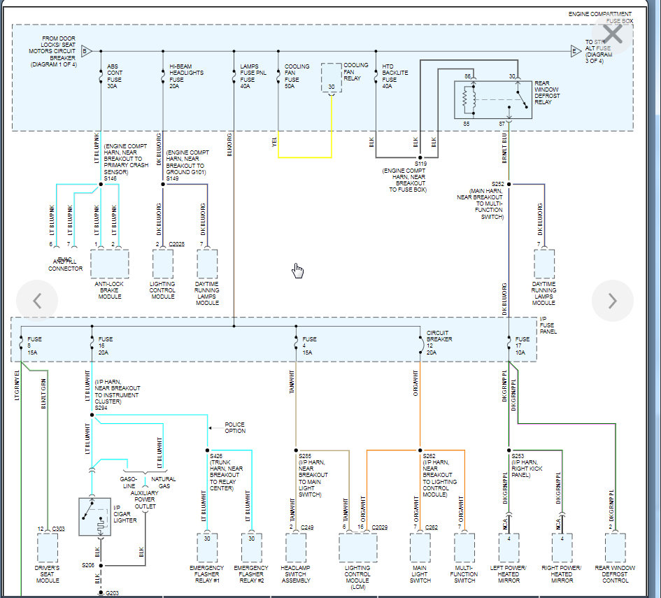

Unbelievable. You said that from the beginning. I don't know how I got that mixed up. Sorry. here is the other one:
