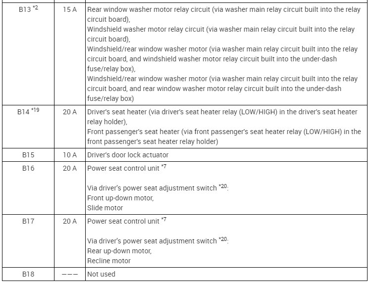

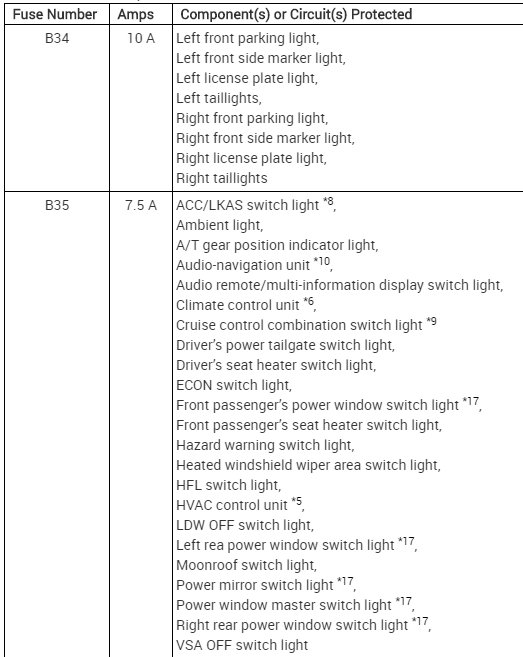

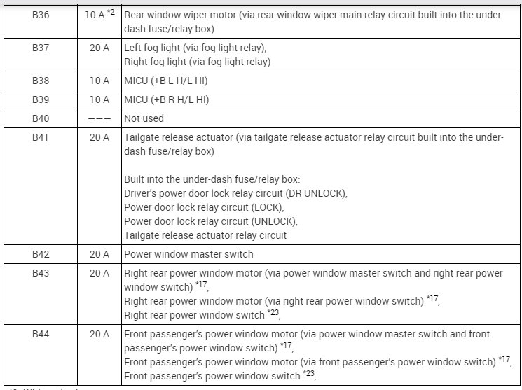

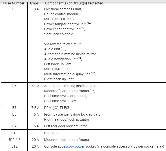

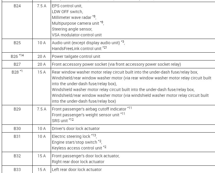

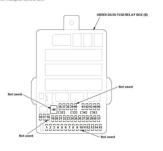

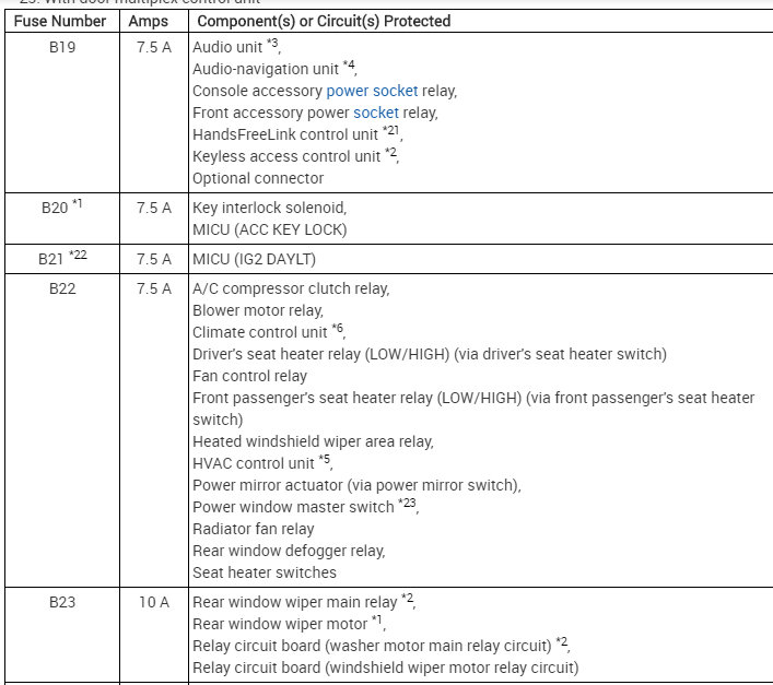

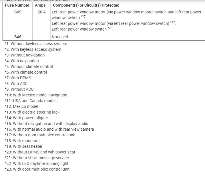

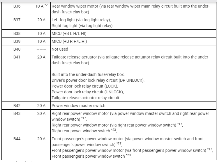

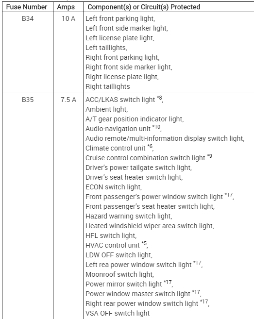

I am pretty sure I have popped fuse, but can't read the numbers, and can't easily reach the panel. Any suggestions on how to replace it?
May 11, 2019 at 9:03 AM
DANNY L
Experienced Mechanic
5,648 POSTS
Hello, I'm Danny.
Here are tutorials showing how to replace fuses:

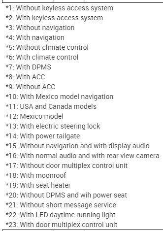

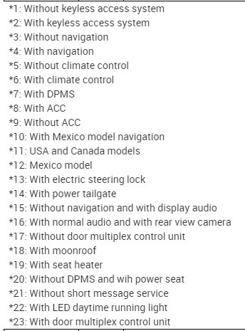

I've attached below pictures showing the fuse numbers and what circuits they protect including the amperage requirement.Hope this helps and thanks for using 2CarPros.
