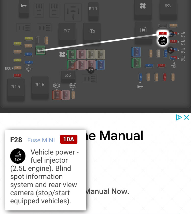

Fuse question. F34 — Vehicle power? F28 —Vehicle power?
2019 FORD ESCAPE
125,000 MILES • 2.5L • 4 CYL • 2WD • AUTOMATIC
MORGAN8173
  • 71 POSTS
F28 —Vehicle power 12V
fuel injector
(2.5L engine). Blind spot information system and rear-view camera (stop/start equipped vehicles).
F34 —Vehicle power

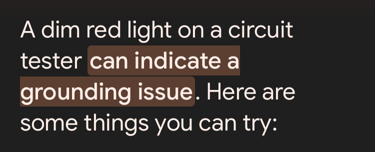

So, I had to replace F28 then I noticed bat F34 was only testing properly on one side, so I replaced it but no change. Then I noticed that it was connected to the large green mini fuse thing. I pulled it out completely and noticed one of the blades that are part of the fuse box for this fuse one lights up bright red while the other has only certain parts of the blade that will only produce a dim red nothing like the other side.
What is this thing tied to?
I ordered this power probe that will come in today hopefully it’ll be of help.

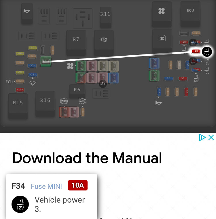

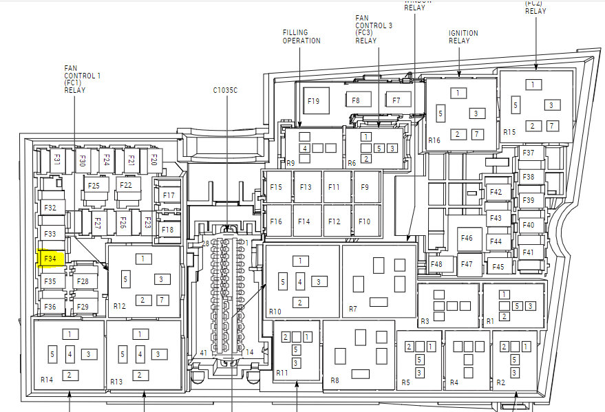

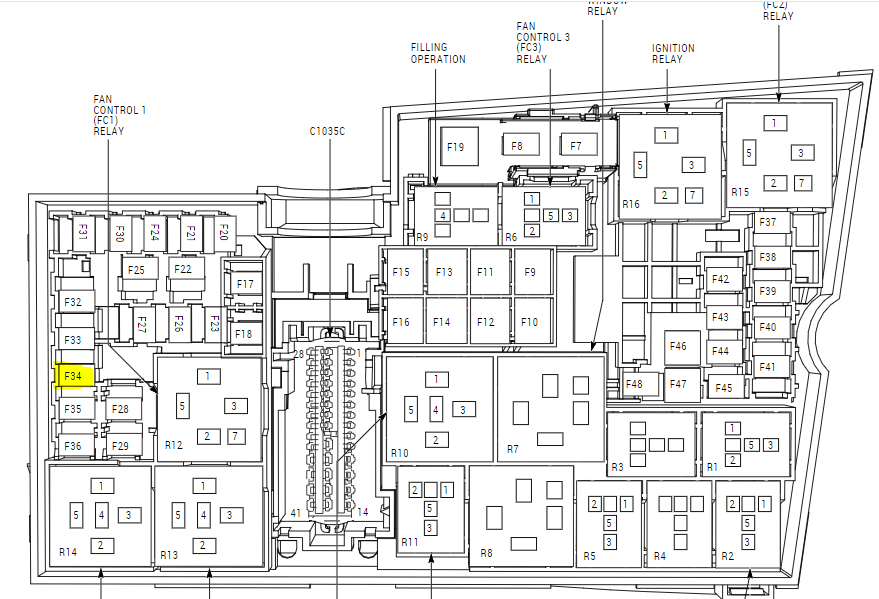

Is this the fuse box under the hood? I ask because fuse 34 shows AC and other things that it covers.
Take a look below and let me know if that is the correct fuse that I'm seeing.
May 21, 2024 at 12:02 PM
MORGAN8173
  • 71 POSTS
Yes, it’s the box under the hood. It looks just like the one you provided.

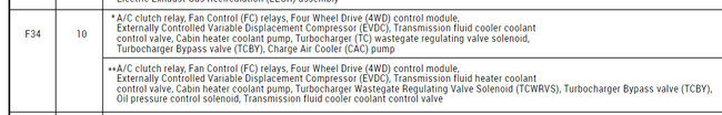

From what I'm seeing, that fuse has multiple functions. Are any of the things listed above affected?
Also, when you checked for power, explain how it was done. For example, did you have the tester grounded at the battery? Was the fuse installed?
May 22, 2024 at 12:33 PM

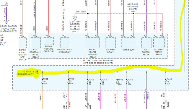

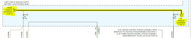

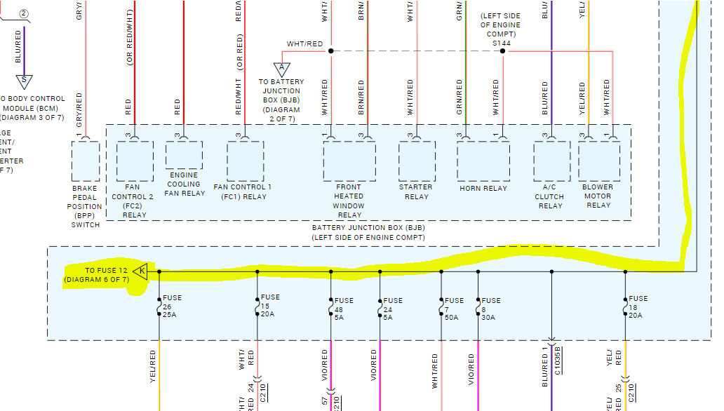

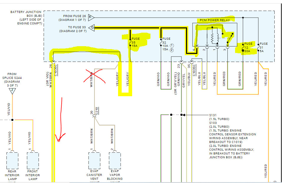

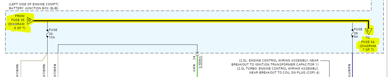

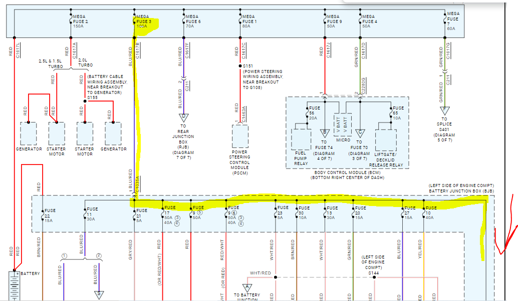

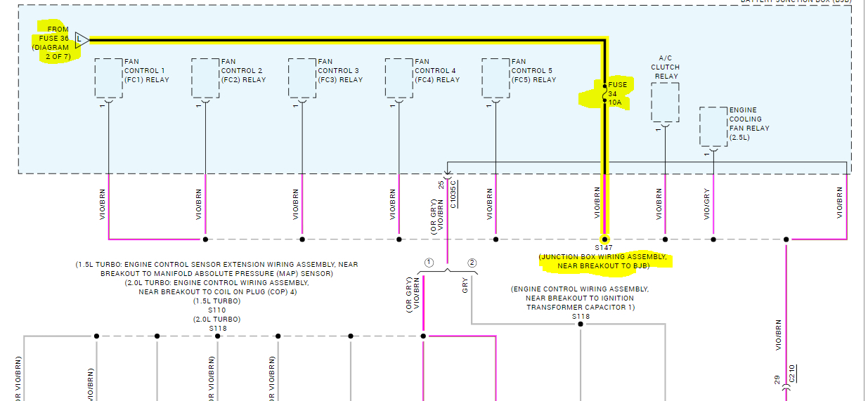

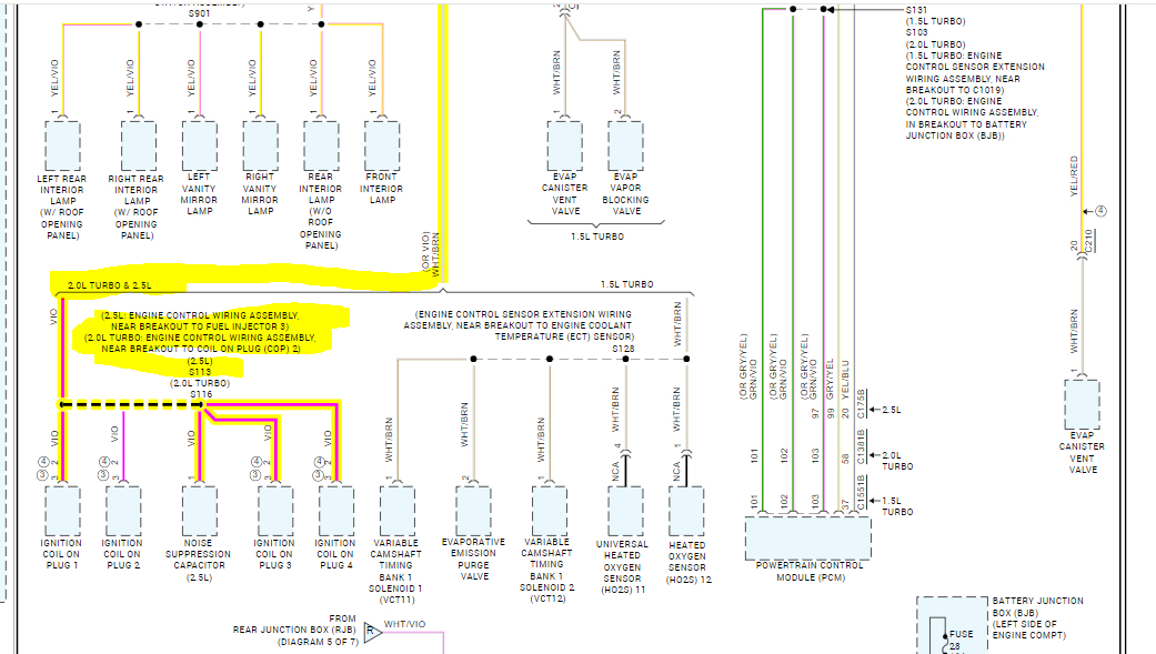

The schematic is 7 pages long. I tried to follow the power up to fuse 34. It does go through a few other fuses starting with Mega fuse 3.
Take a look and let me know if this helps.
See pics below. Note: The schematic jumps all over the place and pages. If there is anything specific you need, let me know. I hope I got it all.
