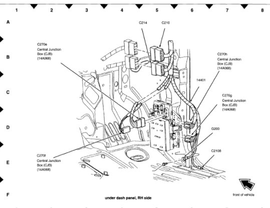

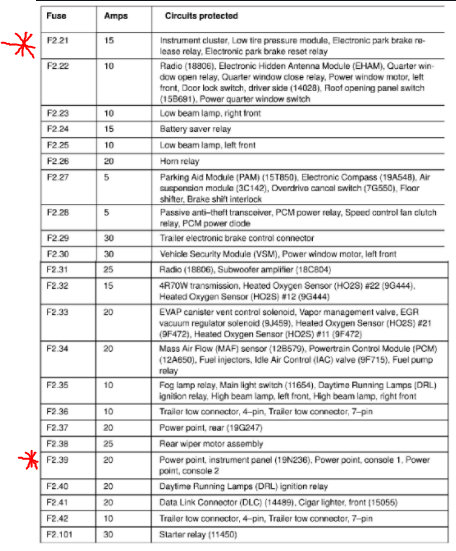

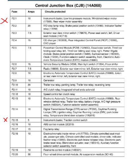

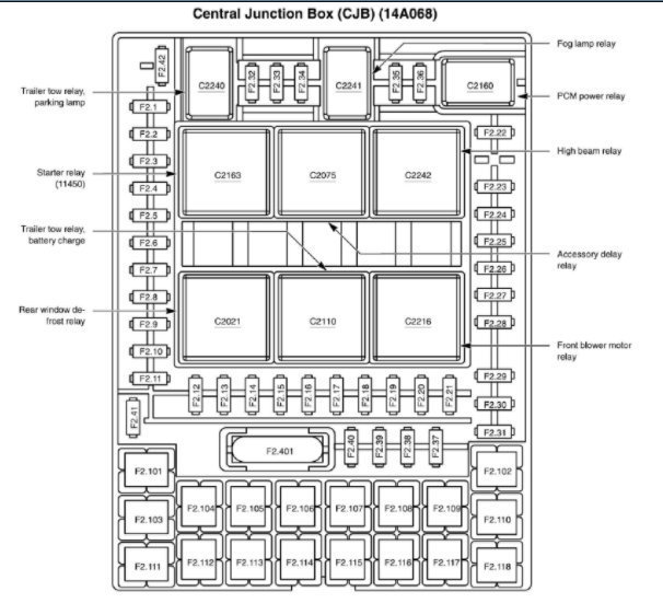

I need to know which fuse is it that operates the gas gauge the speedometer. basically my whole instrument panel. Which fuse do I check? what number is it?
Feb 19, 2021 at 1:49 PM
DANNY L
  • 5,648 POSTS
Hello, I'm Danny.
There is no particular fuse that controls the gas gauge solely. Here is a couple tutorials showing how to test, operation, and replacement of fuses:
I've attached pictures below of the central junction fuse box including the locations of the fuses for the instrument cluster. I've circled the fuses in question in red for your vehicle. Hope this helps and thanks for using 2CarPros.
