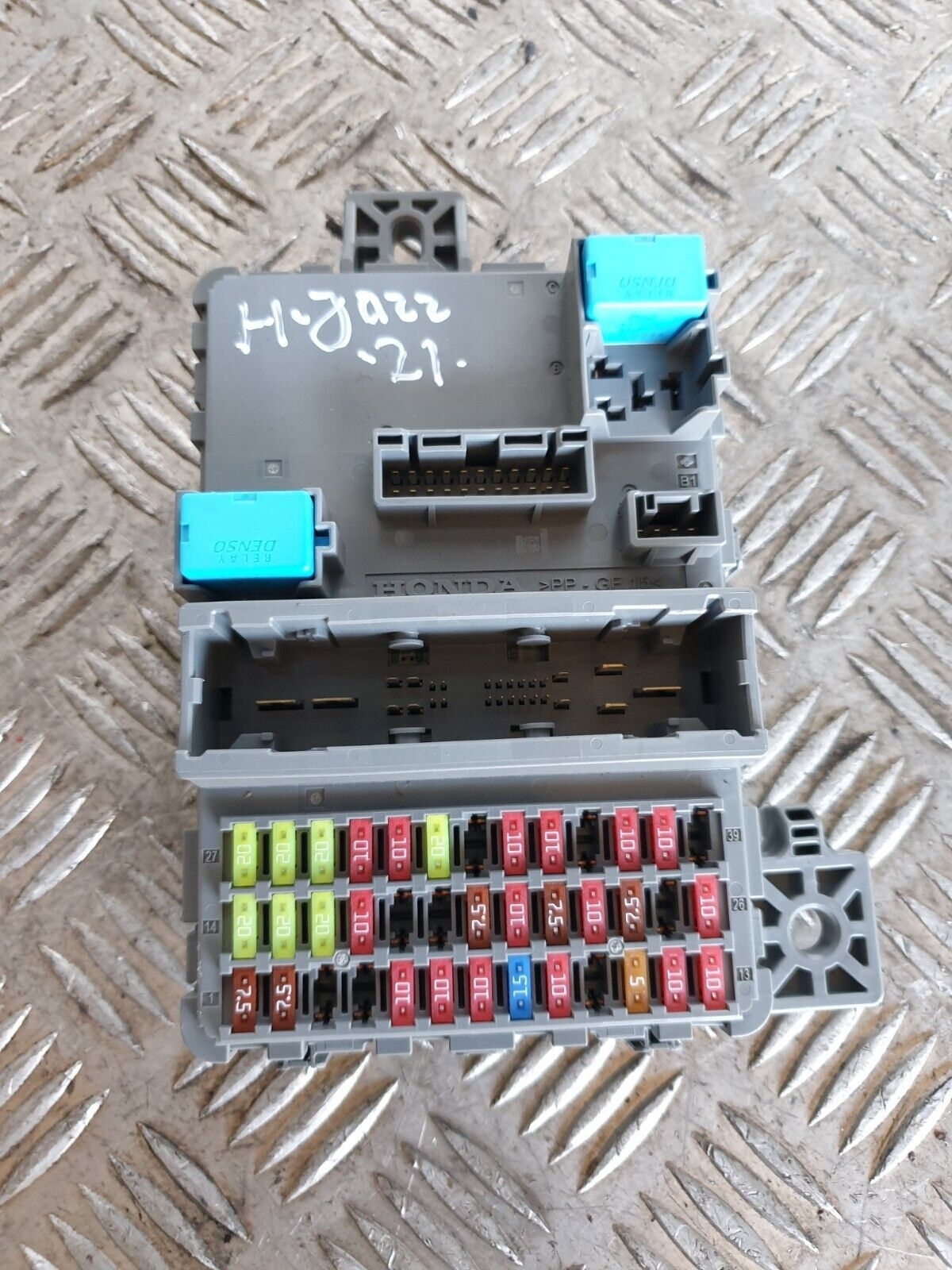

The vehicle listed above is a hybrid, rhd. I need to locate the fuse pump relay.

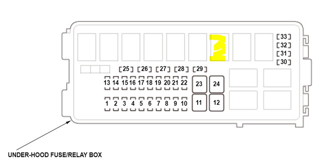

I'm sorry, but this vehicle isn't offered in the US, so it isn't included in my manuals. However, the Honda Fit is offered here. I believe they are very similar.
I attached a couple of pics below showing the location for the Honda Fit. This fuse/relay box is under the hood.
Let me know if this helps. Also, isn't this vehicle still under the 3 year/36,000 factory warranty?

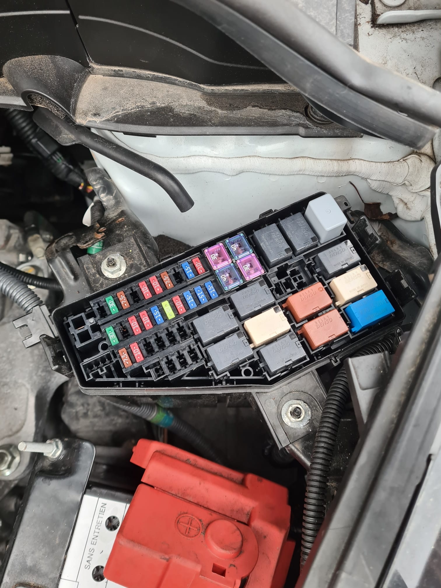

This is the fuse box in the engine bay.
Nov 13, 2023 at 5:31 AM
  • 110,194 POSTS
That appears different than what we have. There should be a legend on the cover. Is anything listed?
I'm not sure where you are located, but isn't this still under warranty?

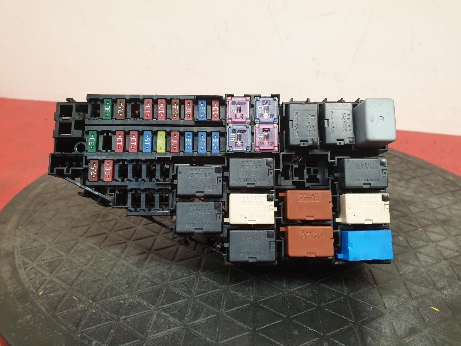

This is the one under driver side dash.
Nov 14, 2023 at 1:38 PM
  • 110,194 POSTS
There are only two relays in there. Remove both and see what fails to work. The opposite relay will be the fuel pump relay.

There is 3 relays there, the image taken from the internet doesn't have the relay there. Will the fuel pump relay be a blue one or could it be a brown one or grey one etc?
Thanks
Nov 15, 2023 at 1:37 AM
  • 110,194 POSTS
I wish I could be certain. Without the actual schematics, I can't tell you for sure.

Will the PGM-FI relay the same one?
Nov 16, 2023 at 2:17 AM

This is the engine bay fuse and relay box.
Nov 16, 2023 at 6:37 AM
  • 110,194 POSTS

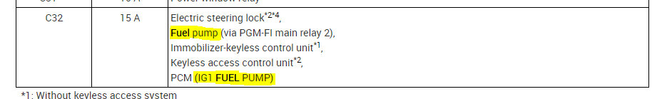

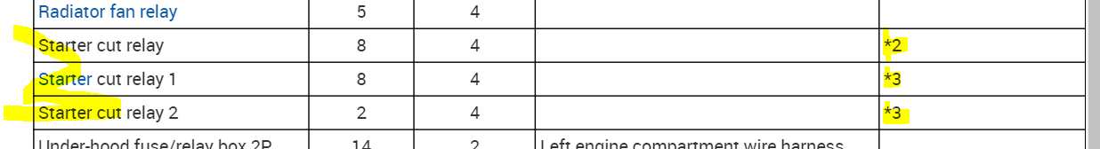

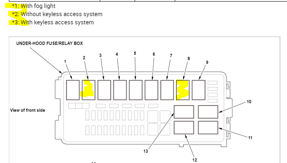

That is different than what we have for the Honda Fit. I attached the under-hood fuse box for the fit below and highlighted the relay. You can see how different they are designed.
To answer your question, yes the PGM1 relay is the likely relay.
See pic below.
