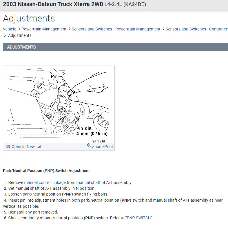

SQM
  • 6,383 POSTS
It sounds like you could have an issue with the transmission control solenoid. Also could be an issue with the torque converter. As it is not engaging when you put it in gear.
There is a transmission position sensor located on the transmission if it get disconnected or loose it can also prevent the vehicle from going into gear.
