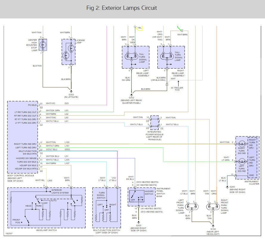

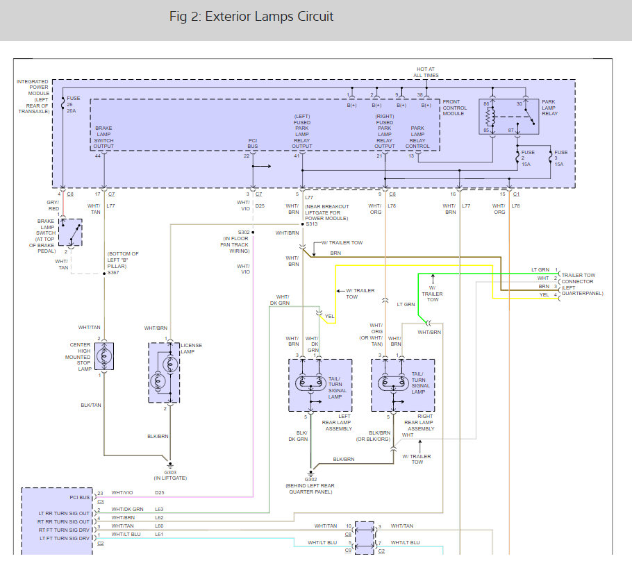

I have used a light tester and there is no power to the fuses for these lights. I checked the relays and they are fine there is nothing missing and I am stumped. Is there anything I can do? Thanks.
Feb 4, 2018 at 3:59 AM
  • 55,746 POSTS

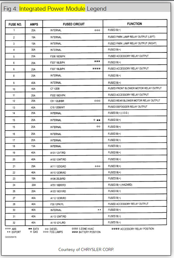

There is a parking light relay that supplies power to those fuses. Here is a wiring diagram so you can see how the system works.

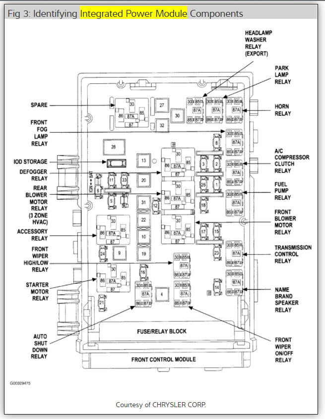

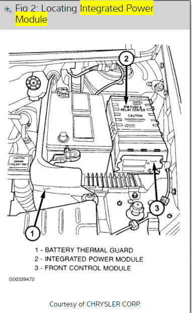

Here are the fuse panel diagrams and a guide to show you how to test the relay.
