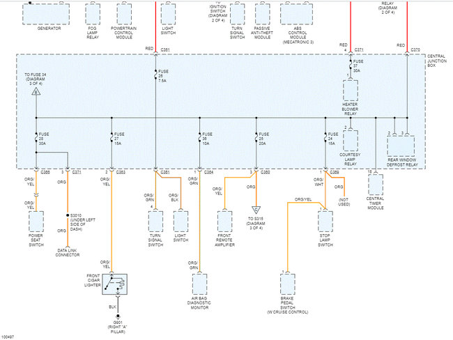

Fuse panel in side the car only volt on half of the fuses.
That same for the fuse panel under the hood, and you are right the car will not run.
Thanks for any suggestion you can give me.
Terry
Apr 30, 2020 at 4:21 AM
  • 110,248 POSTS

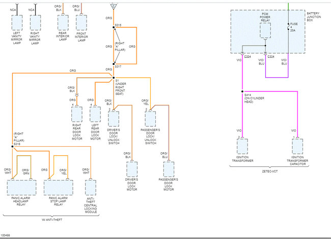

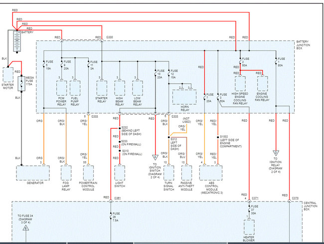

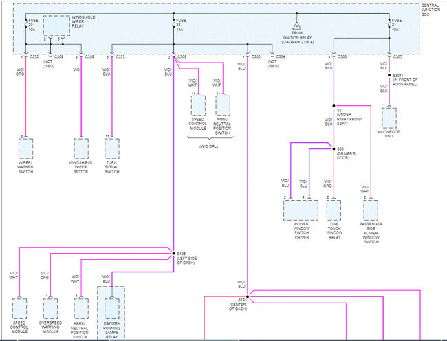

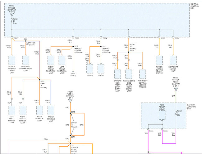

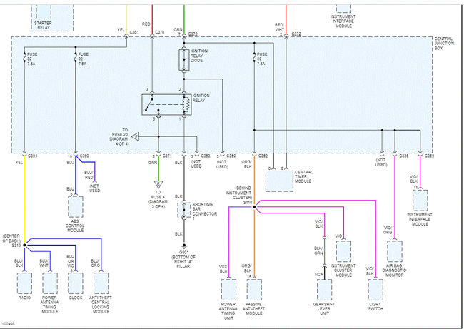

I'm not sure which fuses are not getting power. To help, I attached all schematics for the power distribution portion of the vehicle. What to do is start at the beginning, the battery and see if the wires leading to the fuse box (as noted in the schematics) are all getting power. If they are, then we need to break things down from that point to locate the cause.
The pics below are in order. I overlapped them so you could follow them easier. Note that I had to cut each page in half to make them readable. So, pics 1 and 2 are one page, pics 2 and 3 are another page and so on.
Let me know what you find.
