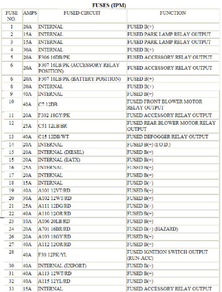

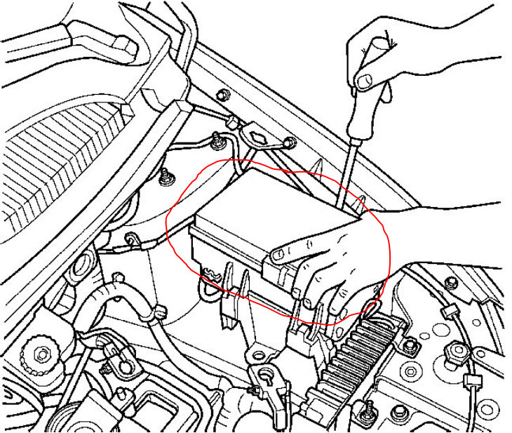

Fuse panel location where is it can I check the fuses myself?
Nov 30, 2019 at 10:00 AM
DANNY L
  • 5,648 POSTS
Hello, I'm Danny.

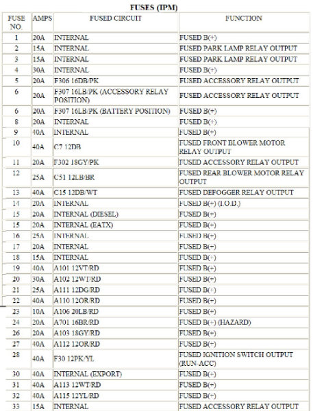

The IPM (integrated power-train module) is located under hood on the left side. I've attached a picture below of its location also with fuse locations.Hope this helps and thanks for using 2CarPros.
