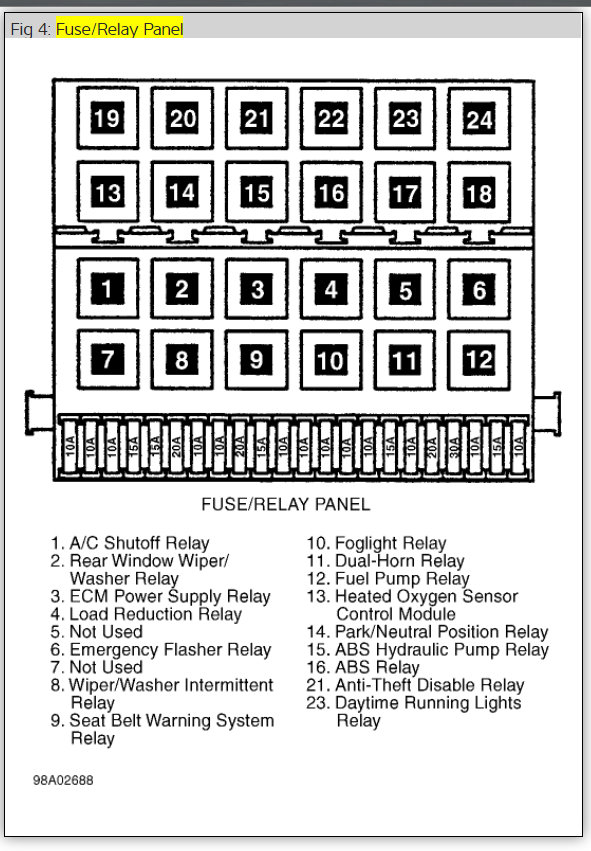

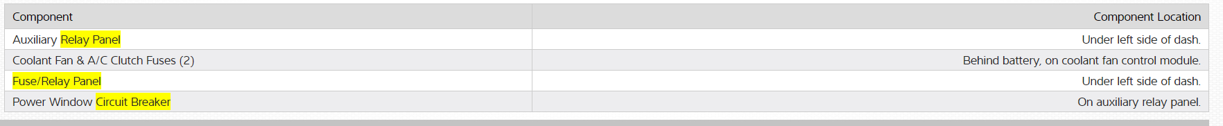

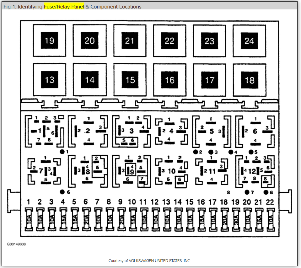

need location of ABS fuse.
Jul 20, 2017 at 1:55 AM
  • 55,433 POSTS
I have found the information you are looking for. Here is a guide to help you test the fuses and a diagram (below) of the fuse box.
