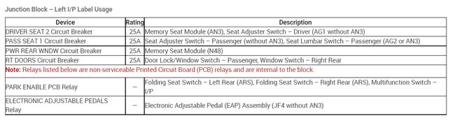

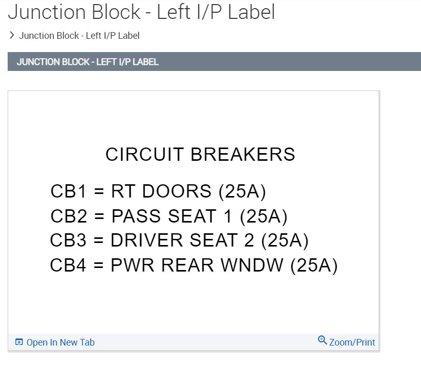

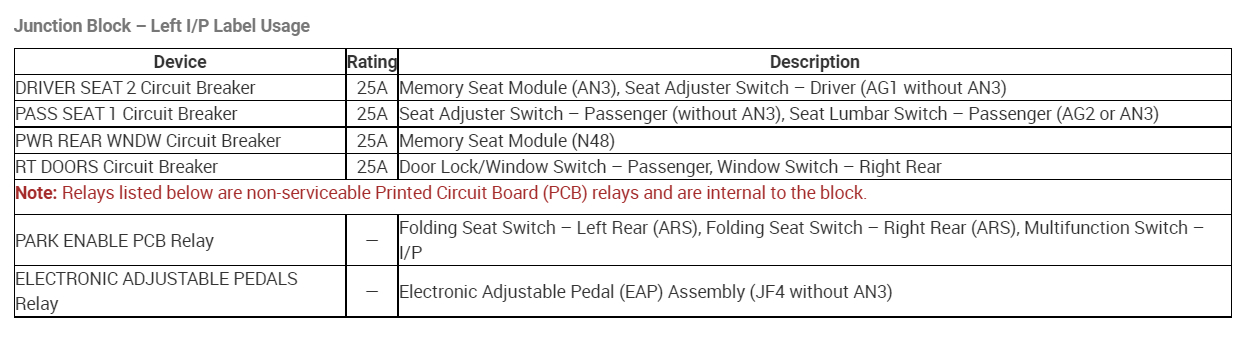

Where is the fuse or breaker located for the passenger seat?
2013 CHEVROLET TAHOE
11,111,111 MILES • 5.7L • V8 • 2WD • AUTOMATIC
GLENN84
The seat won't move at all!
Jul 24, 2022 at 1:19 PM
  • 55,423 POSTS
It is the "pass seat 1 circuit breaker" in the left end of the dash fuse panel. here is a guide to help check for power and the fuse location in the diagrams below. Also found the seat motor wiring diagrams so you can see how the system works.
