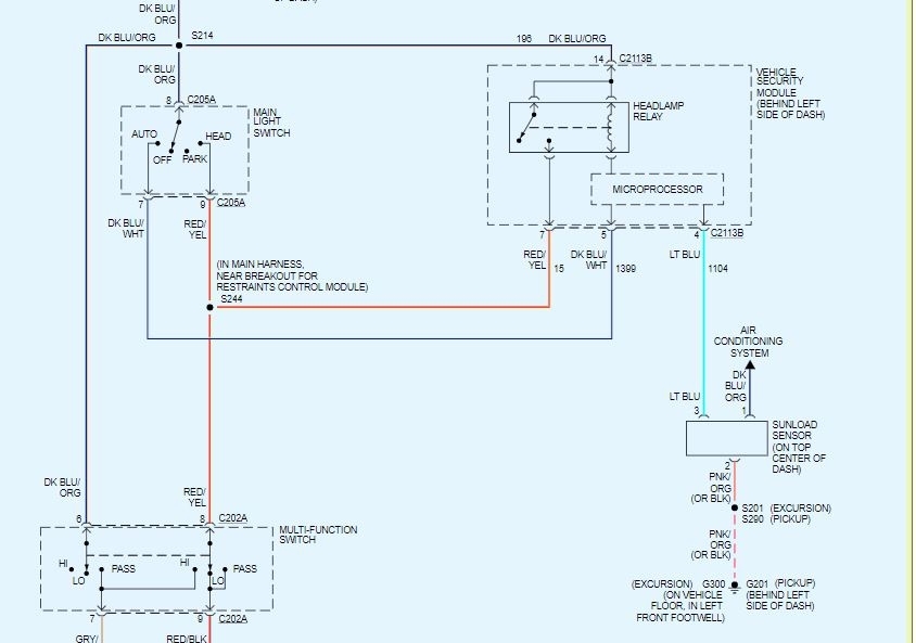

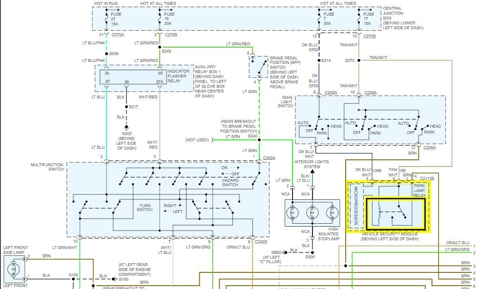

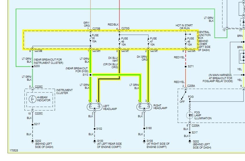

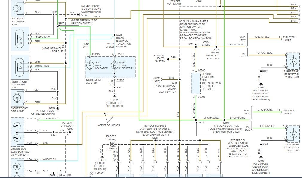

i think i blew fuse that controls headlights and taillights.
Nov 14, 2019 at 2:36 AM
Good afternoon,
There are some fuses for the lights. I attached a wiring diagram of the headlights and tail lights. Make sure there is power at the fuses. That is not a visual test, it is a voltage test.
