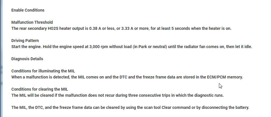

my check engine light has been on for a few months. it came on after I had checked some fuses (not sure what I did to cause the engine light to come on) Cars running great haven't had any issues. took it to AutoZone to see what code displayed P0145 which I believe it said the engine would be sluggish and bad gas mileage but this has never happened, though I can't clear the code' how can i clear the code? someone said to remove the 7.5A fuse for the clock.
May 17, 2021 at 6:24 AM

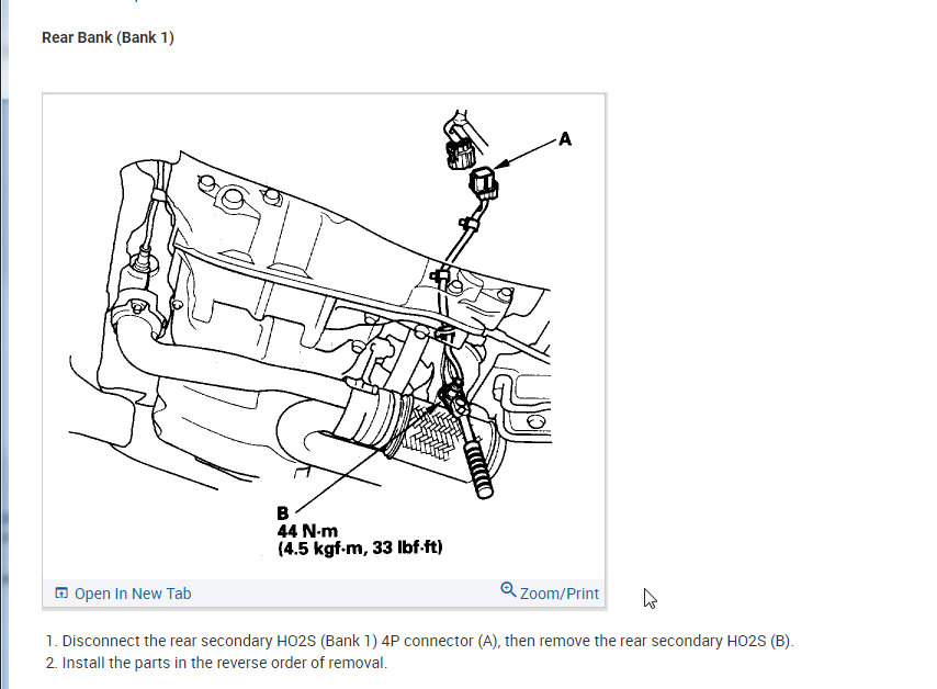

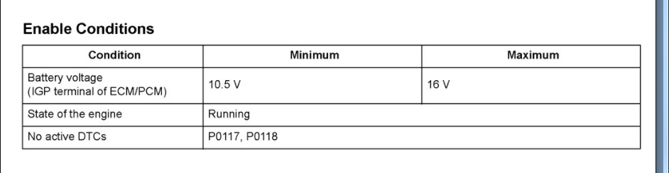

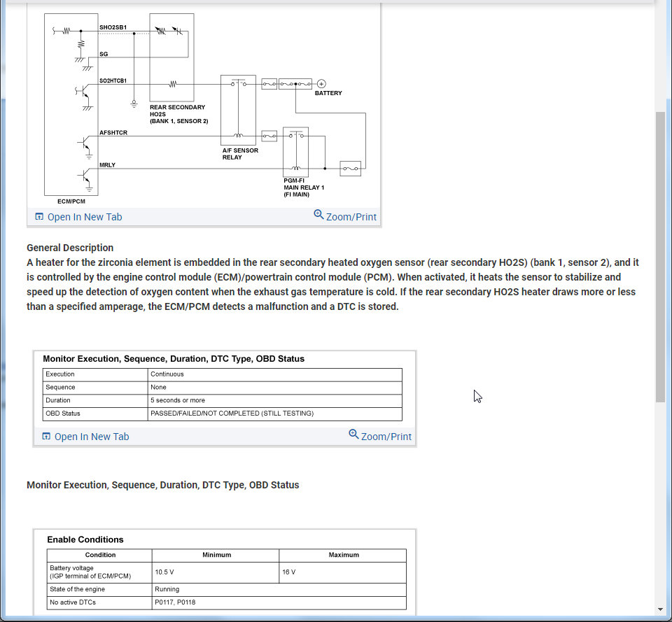

The code will not clear because the issue is active and requires 3 consecutive trips with no issue to clear or it is no longer active.
Here are some guides that will help with this as we are going to have to test the o2 sensors:
https://www.2carpros.com/articles/how-to-test-an-oxygen-sensor-02-sensor
https://www.2carpros.com/articles/how-to-replace-an-oxygen-sensor
Below is the info on this code and sensor.
Please run through this testing and let me know if you have other questions.
