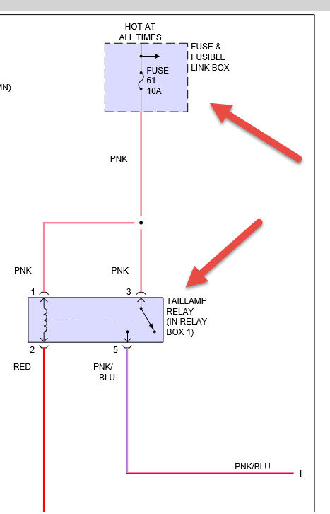

Bought this SUV and the glove box and the ashtray light were not working changed the bulbs and they still didn't work, dear searched for the fuse and couldn't find it. Can you please tell me the location of the fuse

see pic

all you asked for was fuse for glove box which I provided. check the pink/blu wire leading from tailamp relay to see if you have power if it does then the wire leading to the glove box is broken or cut or the ground is bad for glove box which is under lh kick panel or the ground wire is broken

the glove box light changes to a pink/grn wire I thought it said.
