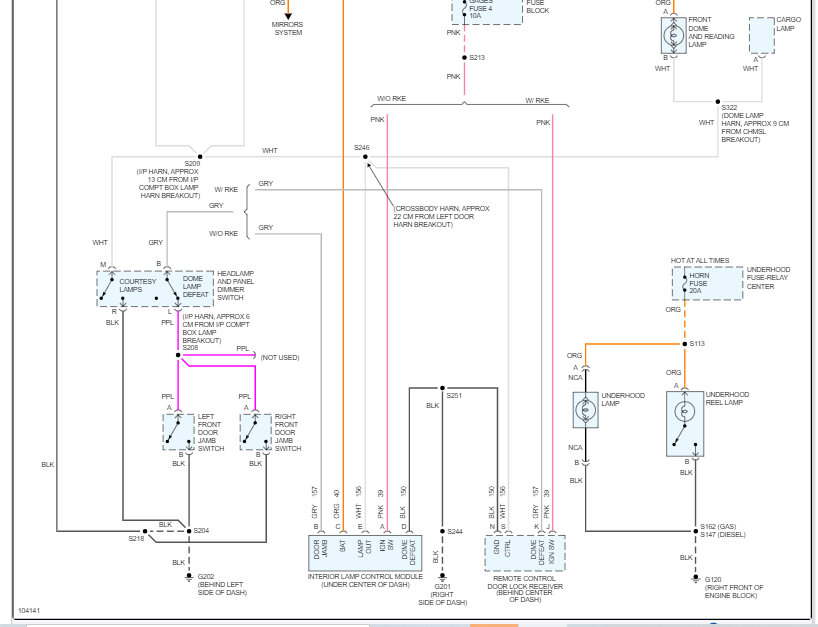

Which fuse is for the button that the dome light comes on when door is open?
1998 CHEVROLET 1500
210,000 MILES • 5.7L • V8 • 2WD • AUTOMATIC
MSBELL1987
So, my truck was broken into shortly after i got it. A long story short, no door panel on driver's side.
Dec 23, 2022 at 7:57 AM
  • 110,244 POSTS

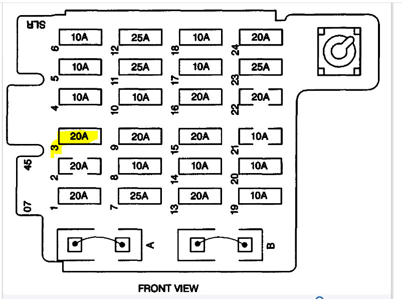

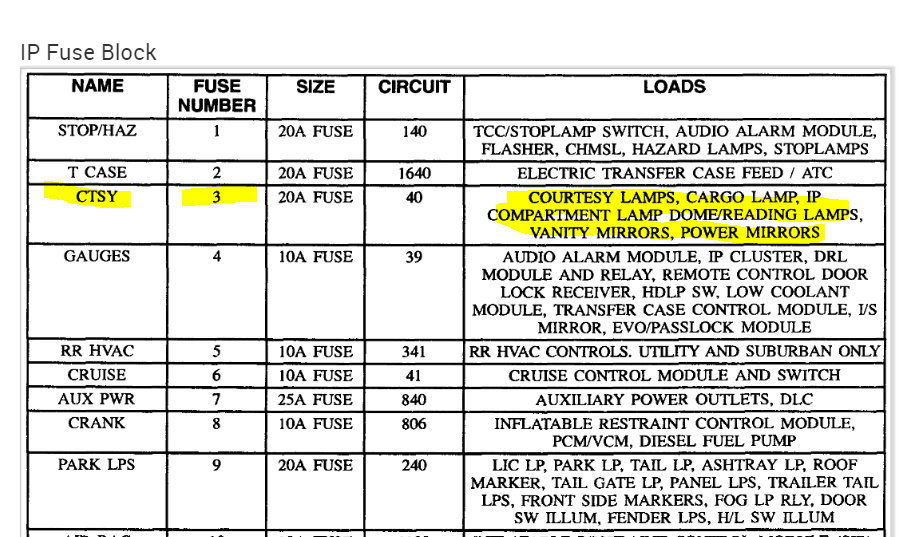

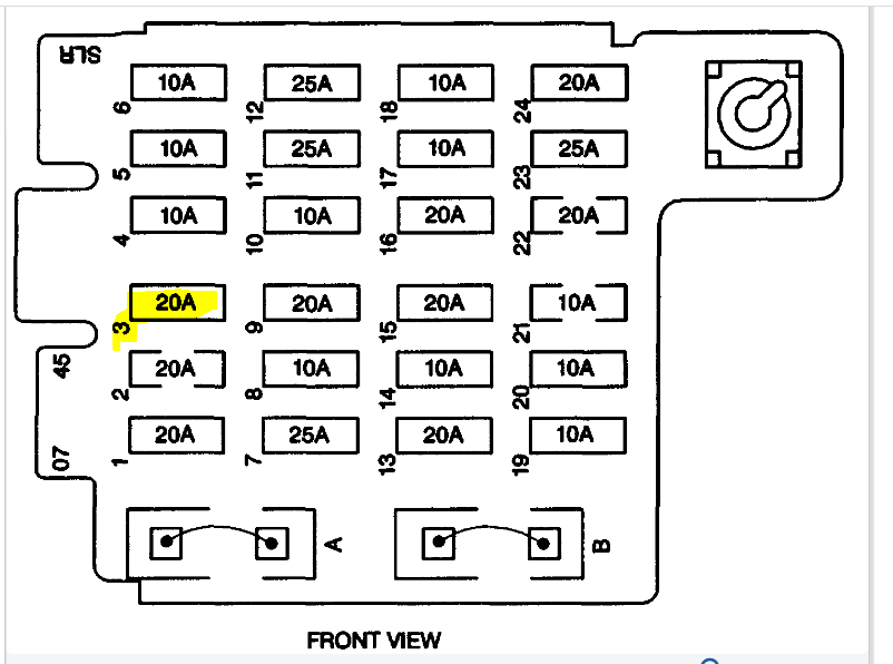

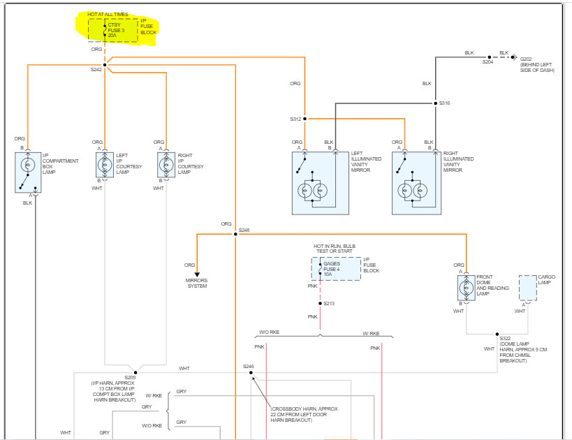

The fuse for the interior courtesy lamps is in the instrument panel fuse box. It will be fuse 3 in the box. If you look at the last two pics below, I highlighted the fuse and highlighted everything it powers.

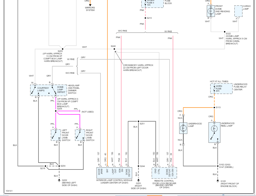

I attached the wiring schematic for the circuit as well so that you have a reference.,
If you check the fuse and it appears good, confirm it has power to and from it.
