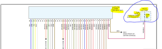

I am looking for a fuse that may be for my amp because i am getting absolutely no sound.
Aug 2, 2023 at 3:19 AM
  • 110,194 POSTS

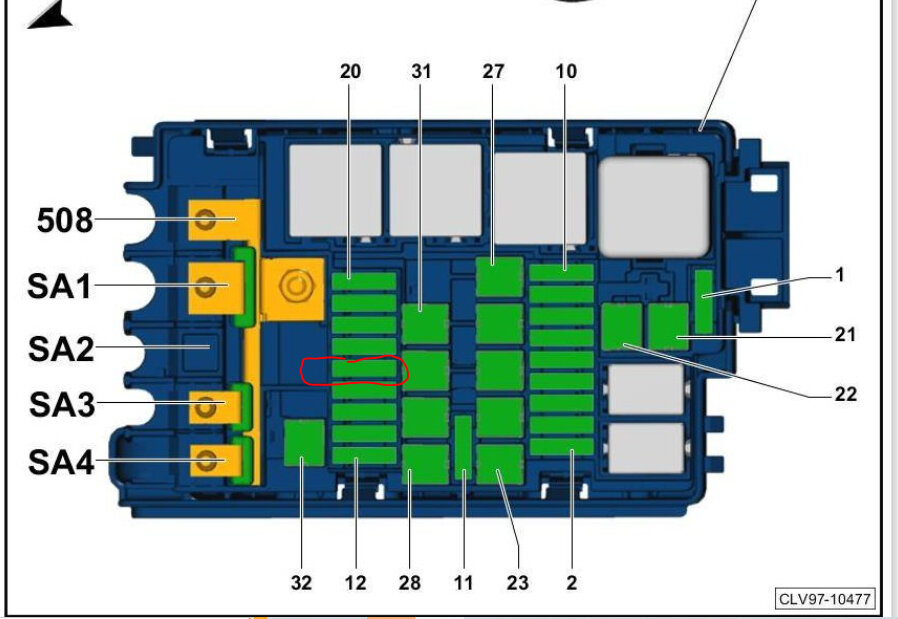

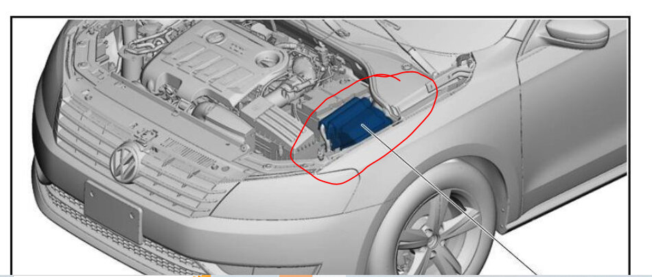

If this has a factory amp, the fuse for it is fuse 16 in the under-hood fuse box. It is a 40-amp fuse. See pic below
When you check this, also confirm there is power to and from it.
Pics 2 and 3 show the fuse in question and fuse box location.
Let me know what you find or if you have questions.
