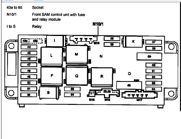

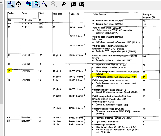

Cigarette lighter does not work.
Apr 15, 2019 at 4:56 AM
SEVAG P
  • 405 POSTS
hello thanks for using 2CarPros.
The cigarette lighter fuse is located at fuse box which is located at engine compartment left side check, fig 1 and 2 fuse number 47 15 ampere.
