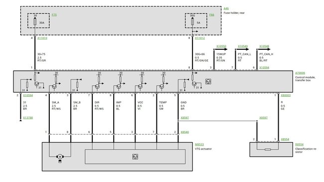

I am needing to know where the fuse for the transfer case is at. And any other fuses that may be related to the transfer case. I bought a 2007 530xi and the person had dropped driveshaft and I am trying to identify if the transfer case is the source of noise
Apr 15, 2026 at 10:27 PM
STEVE W.
  • 15,423 POSTS
There are 2 fuses in that system. Fuses 66 and 75 in the rear fuse holder. 66 powers the control module while 75 powers the shift system.
