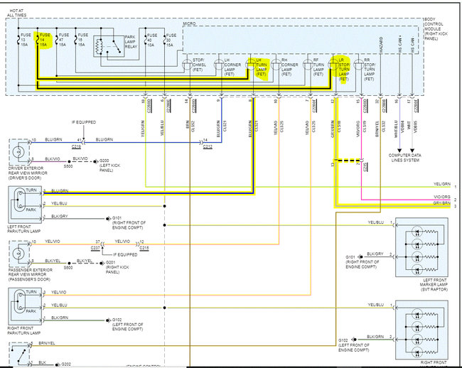

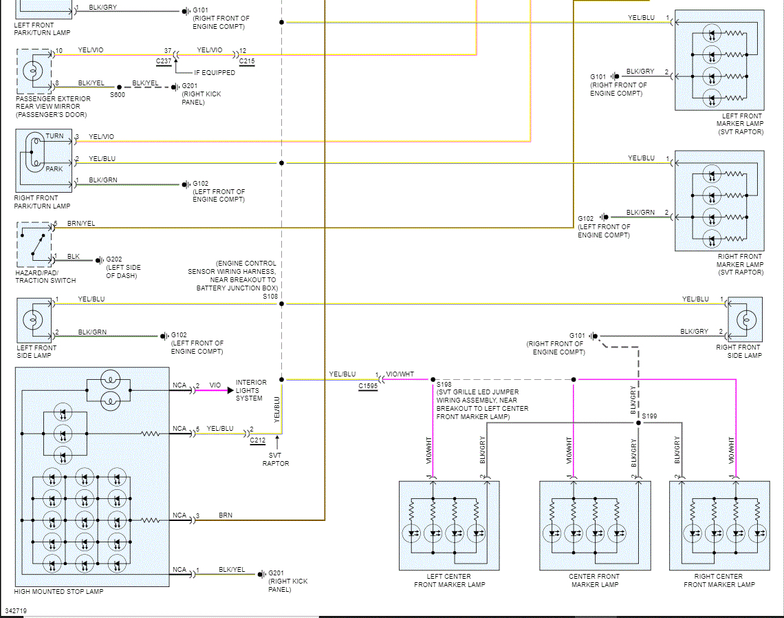

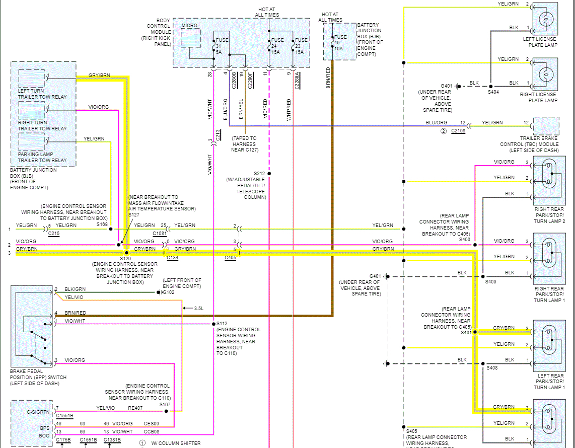

Left turn signal and brake lamp is not working bulbs are good so going to check the fuse but there is no literature on location of said fuses.
Nov 29, 2021 at 4:22 AM
  • 110,240 POSTS

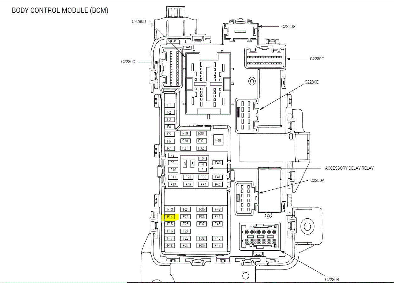

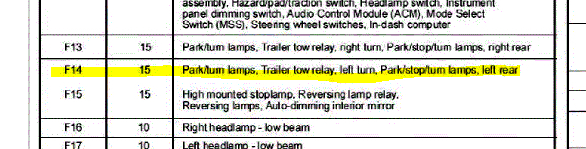

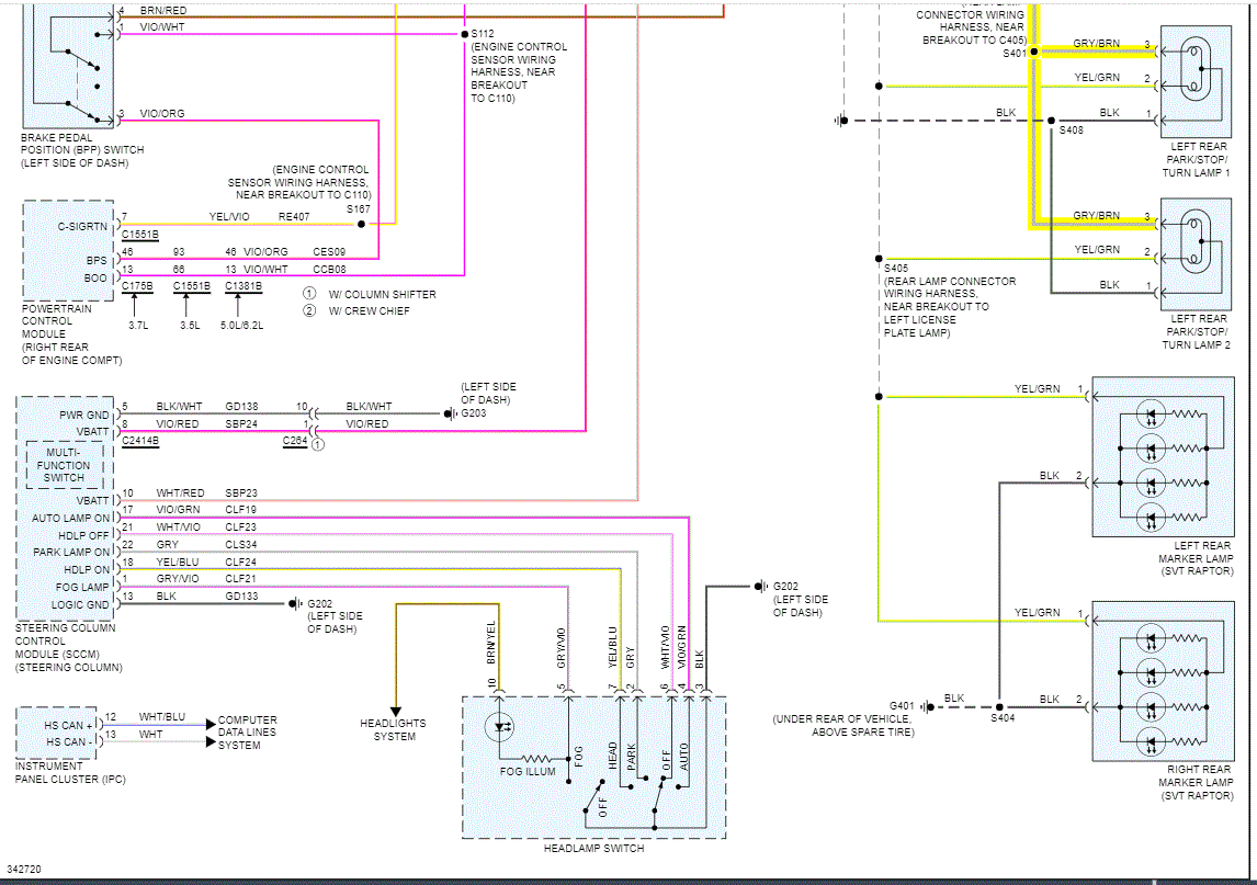

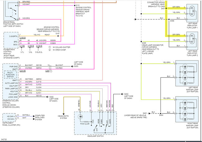

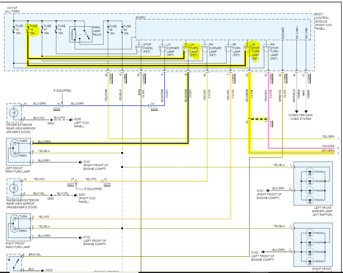

First, I attached the wiring schematic for a reference tool. The left signal and brake lamp is powered by fuse 14 in the interior fuse box (BCM).
The first 4 pics below are the schematic. I had to cut each of the two pics in half to make them readable for you, but I did overlap them and highlight the wires involved.
Pics 5 and 6 show the fuse legend and the location in the fuse box to check.
In addition to checking the fuse, make sure there is power both to and from it. The fuse could be good but have no power to it.
Let me know what you find or if I can help in any way.
