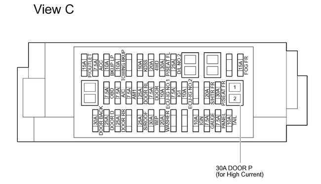

i replaced the bulbs still not working. where is the fuse located for the license plate lights.
Thank you,
Kevin Dimock Sr.
May 31, 2020 at 5:38 PM
Good morning,

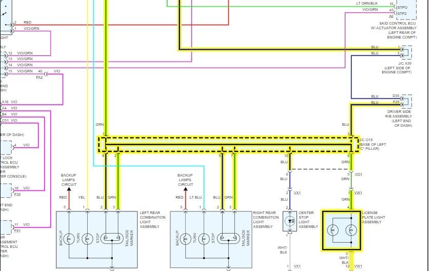

Okay, there is no individual fuse for the license light. It has a green wire that goes to it and all the rear parking lights run off this green wire. If the regular running lights are working then there could be a wiring issue.
https://www.2carpros.com/articles/no-tail-lights-exterior-running-lights-tail-lights-out
Use a test light or voltmeter and test the green wire at the socket for power with the lights on.

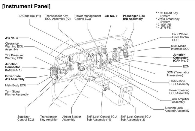

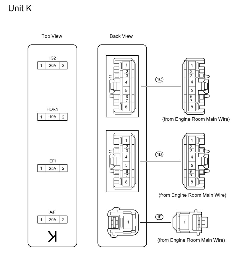

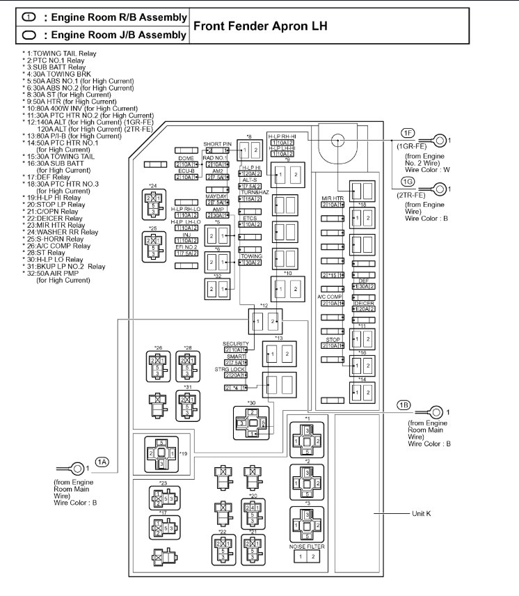

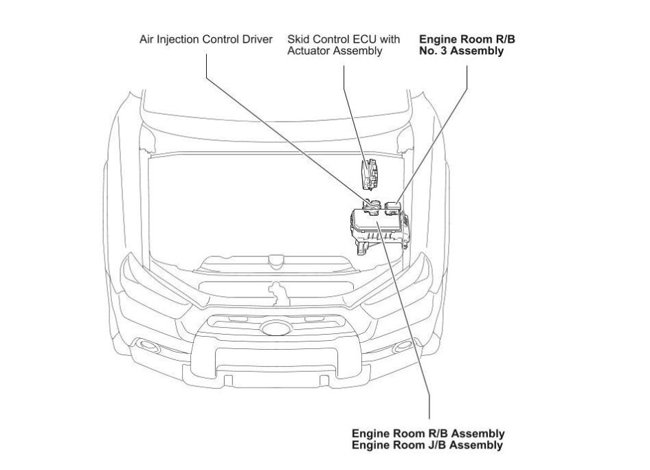

Here are the fuse locations you asked for and a guide to check them:
