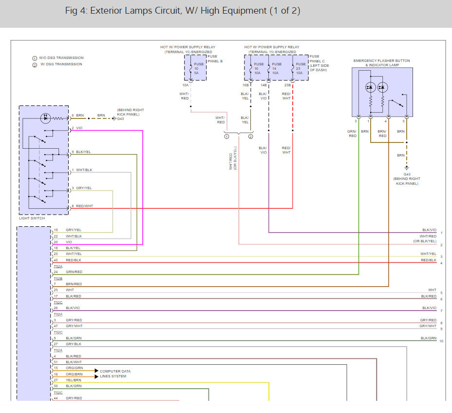

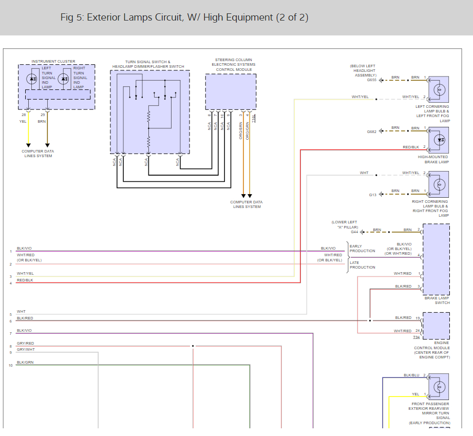

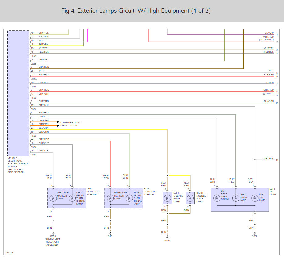

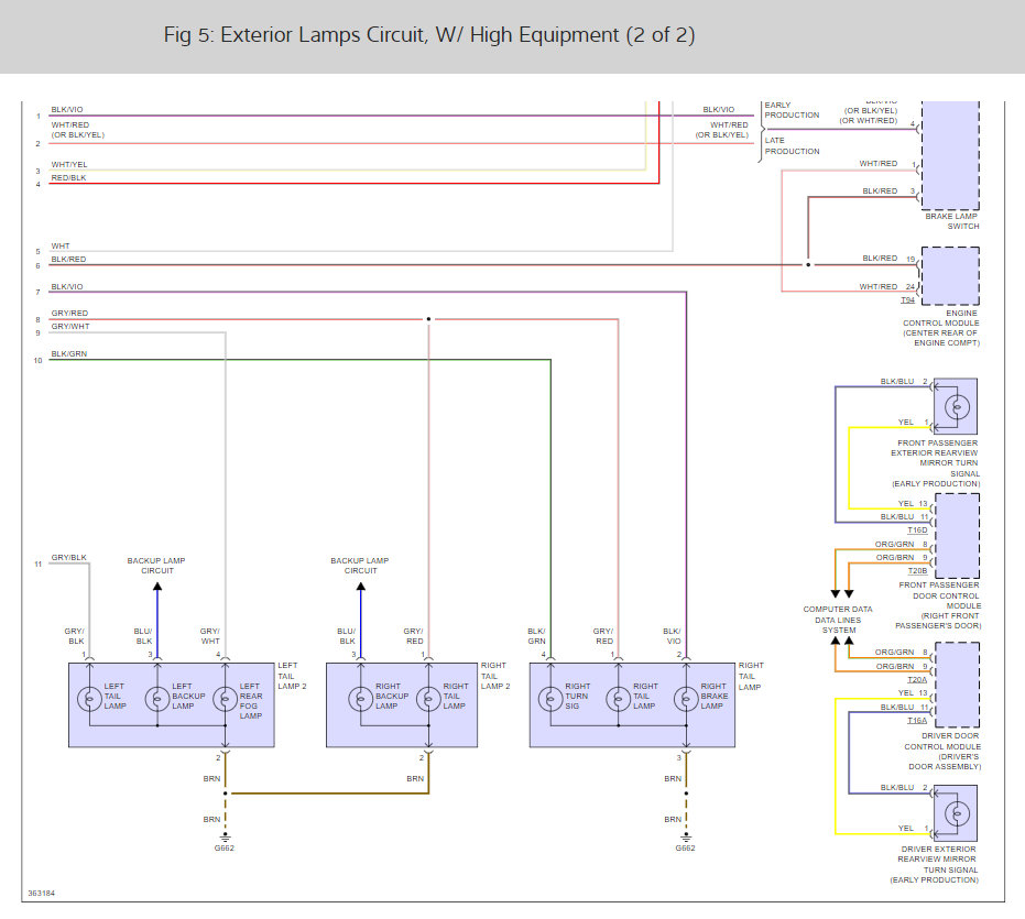

Rear lights not working. Fuse keeps blowing.
May 29, 2018 at 6:25 AM
Experienced Mechanic
55,628 POSTS
It sounds like you have a bulb that is melted in its socket. I would start by removing all bulbs and inspecting them and there socket contacts.
Here are two guides and the brake light wiring diagrams so you can see how the system works:
https://www.2carpros.com/articles/brake-lights-not-working
and
Check out the diagrams (below). Please run some tests and get back to us.
