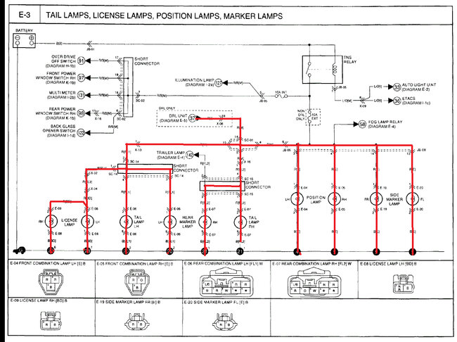

Dashboard lights will not come on. The right taillight will not come on. The brake, signal, reverse lights all work when needed but taillight will not come on. Changed the fuse but they keep blowing.

There may be a bad wire or a corroded light socket that when you turn the lights on it shorts out the fuse. Check the bulb socket and bulb. Look for any frayed wires or crossed wires. The dash lights are the same fuse as the taillights. Start by checking the right taillight assembly.

No, check the wiring and bulb, you can get the whole wiring harness if you need to but check the wiring. The short might be what is blowing the fuses.

If not, could you let us know the fuses that are failing? Also, if you remove the affected bulbs and turn the lights on, does the fuse still fail?

Dash is still out. I changed the light that went out, but it is still a problem. I changed the fuse as well. It is fuse 10 but it blew as soon as I turned the lights on.

There has to be something shorting out.
