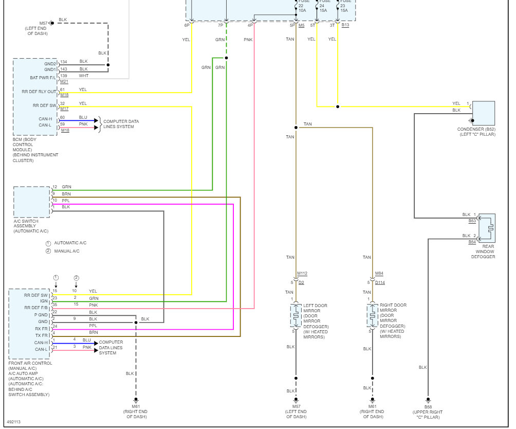

Anytime I use the rear defroster it causes the other fuse to pop ?
138,000 MILES • 4 CYL • 2WD • AUTOMATIC
SPOHNCONNOR
I realized 3 days ago that a fuse went out, if you look at the Nissan diagram it would be fuse 30. I replaced it and my compass, and A/C work now. Today it went out again, I got a circuit tester and I put in a new fuse, and it worked but the slots 22,23,24 are not getting any light or power when I hit it with the tester. Anytime I use the rear defroster it causes the other fuse to pop and the a/c not to work. How can I fix?
Oct 3, 2023 at 11:36 PM
  • 55,616 POSTS

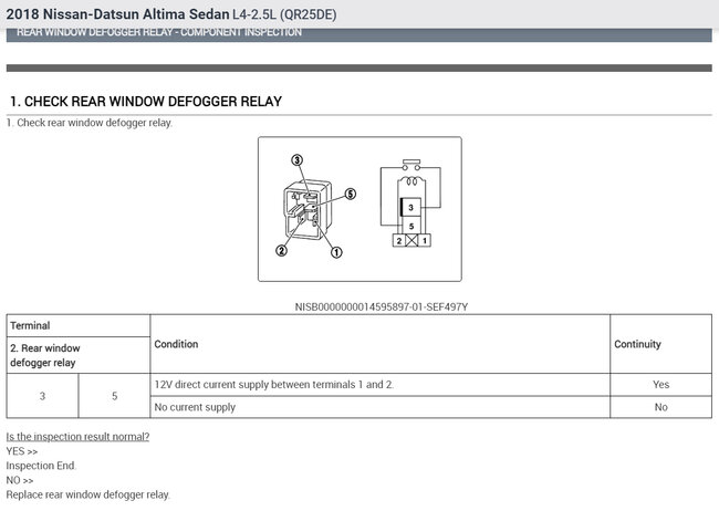

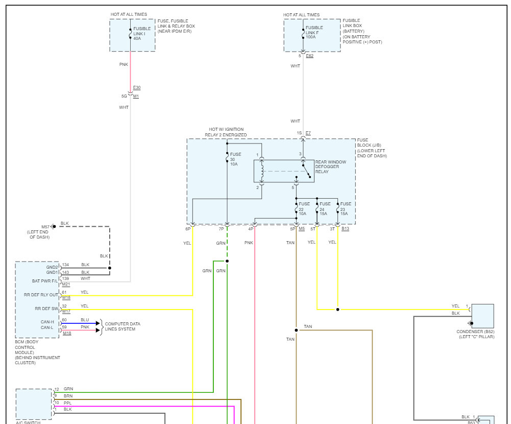

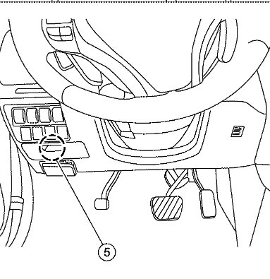

The fact that it pops fuse #30 points to the rear window control relay. I would swap it out to see what happens, here is the location for the relay (#5) and the wiring diagrams for the system so you can see how it works. Check out the images (below). Please let us know how it goes.
Oct 5, 2023 at 1:33 AM
SPOHNCONNOR
Ken, I realized today, that I started the car after putting a new one in, after I did so. It blew by just starting the car.
Oct 5, 2023 at 1:49 AM
  • 55,616 POSTS
I assume you replaced the relay and the #30 fuse blew? If so do me a favor and unplug the A/C compressor and try a new fuse once again. Let me know. Also, is the rear defroster on when the fuse blows.
