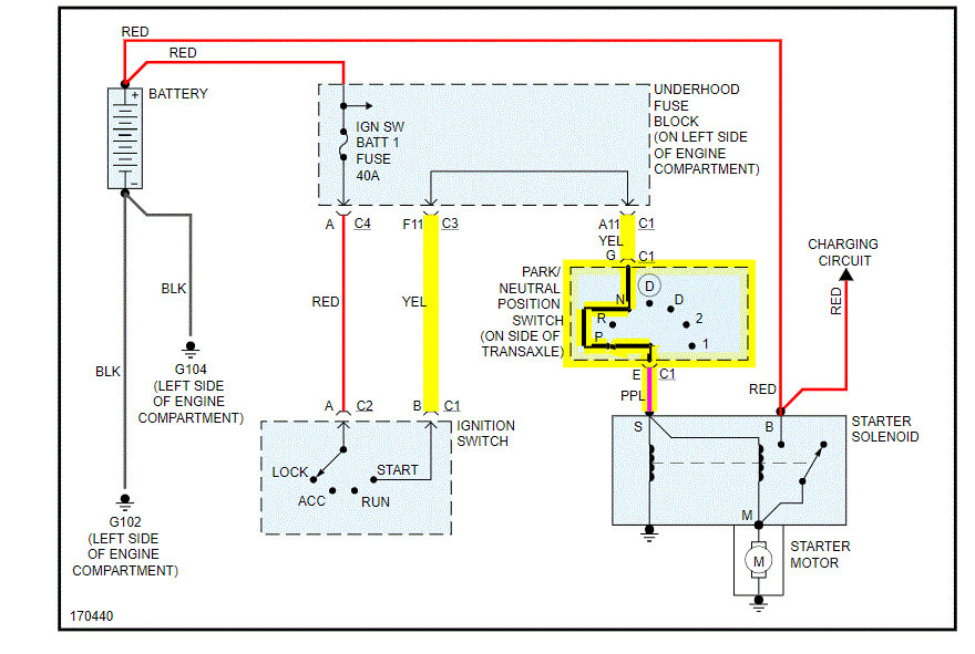

Where is the fuse for the starter so I can jump start car by bypassing starter??

Bypass starter? Please explain.
I attached a wiring diagram for you of the starting system.
Do you have a test light to do some checks?

There is no starter fuse to bypass. What is the issue you have?

Dang. The starter went out and I was trying to jump start it like I did with my Chevrolet suburban. I did just find out that there is a recall on the issue I am having with the 2003 Chevrolet Malibu, so hopefully it will be taken care of. Thank you for your help.
