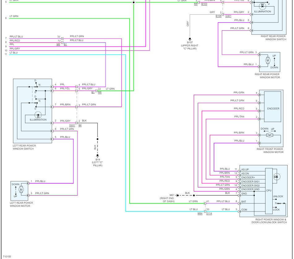

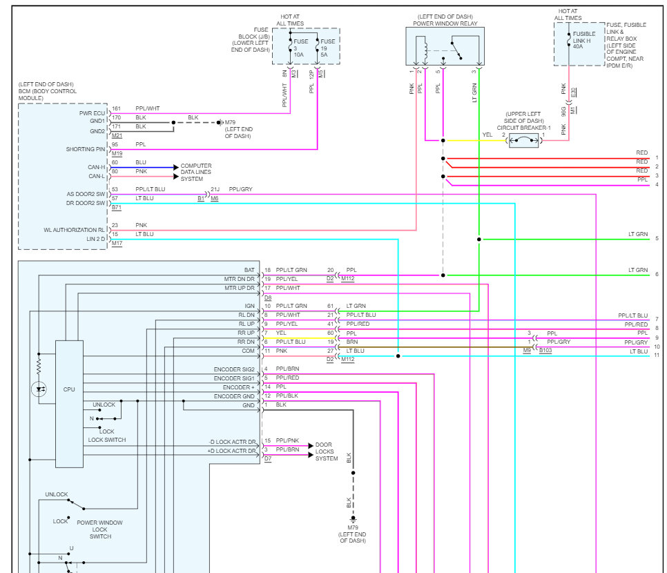

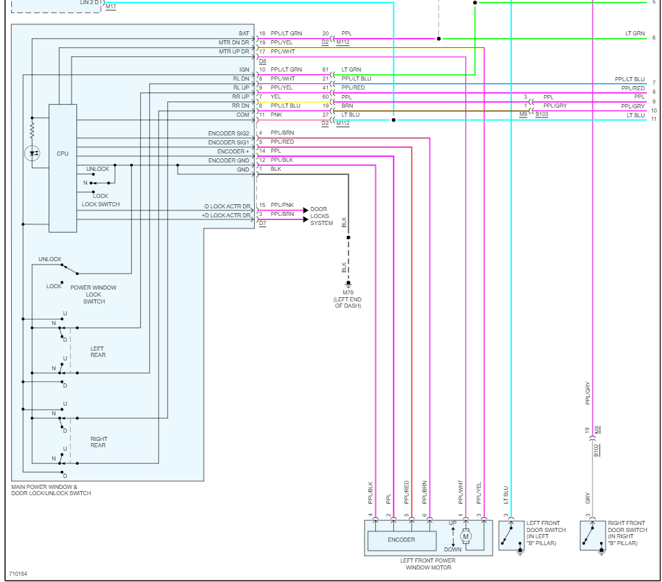

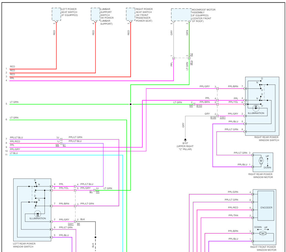

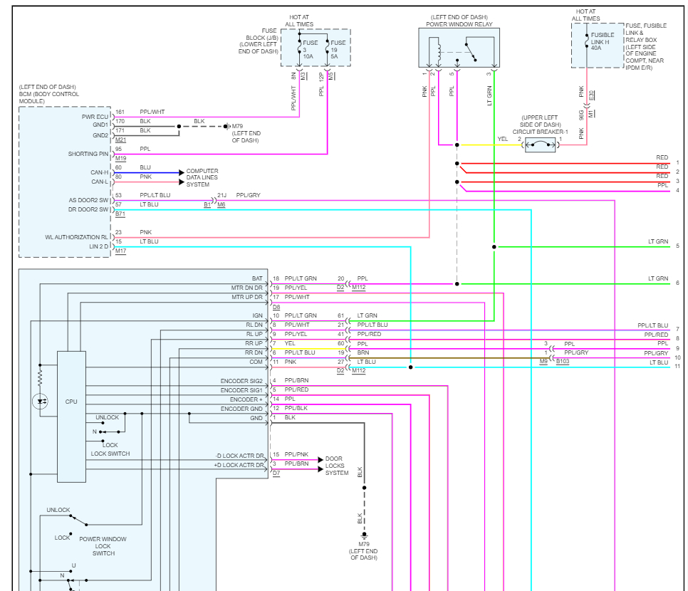

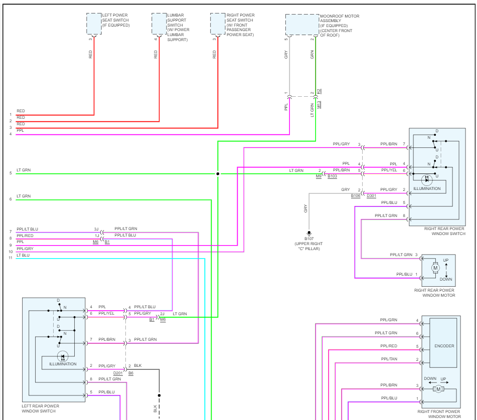

There are 3 fuses and a window power control relay that runs the system. here is a guide to help you test the fuse and I have included the window wiring diagrams so you can see which fuses to check and so you can see how the electric window system works:
Check out the images (below). Please let us know how it goes.
