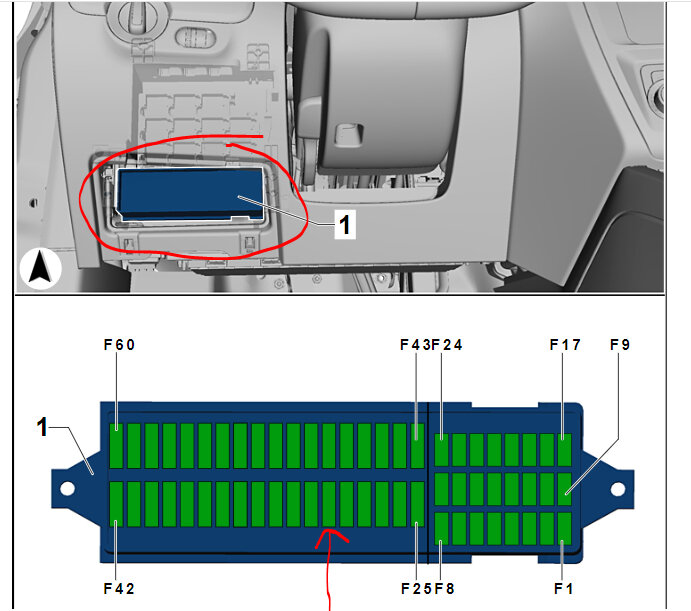

Where is the Fuse for lighter located?
2017 VOLKSWAGEN JETTA
65,000 MILES
FCARAVEO1940
I would like to install cameras.
Dec 13, 2023 at 8:23 AM
  • 110,194 POSTS

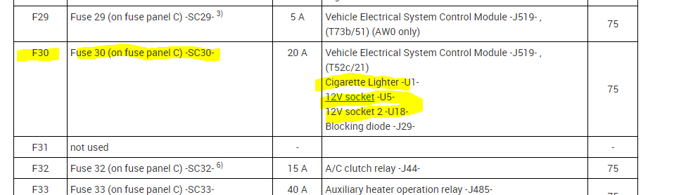

The fuse for the cigar lighter and power ports is located inside the vehicle on the left of the steering wheel. It is fuse 30.
I attached two pics below to help you locate it.
Let me know if this helps.

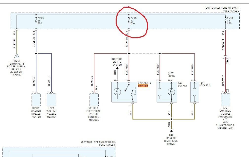

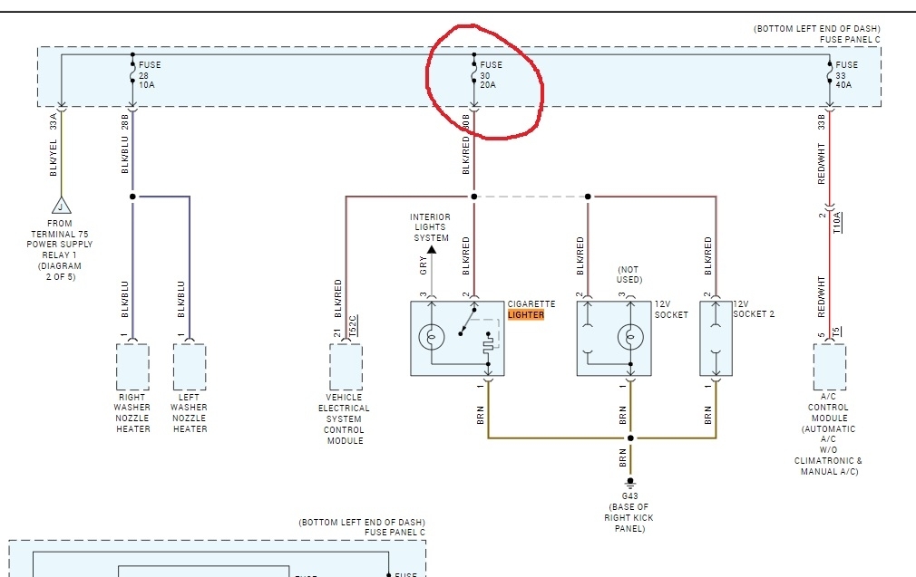

Hello FCARAVEO1940,
Attached is the power distribution diagram showing the fuse you are looking for.
It's located in the fuse panel at the bottom left end of the dashboard.
If the outlet isn't working, for sure check that out.
If you are putting in a camera system, there may be better options to wire it in so that you still have use of your outlet for other things. Please let us know if we can be of any further assistance!
