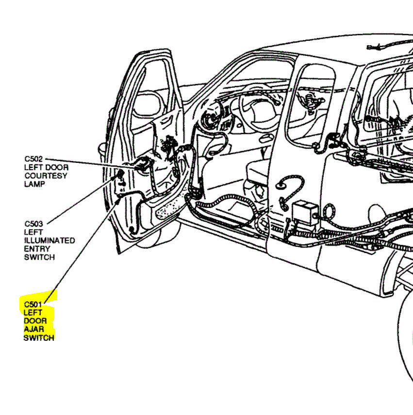

Interior light remains on even when all doors are properly shut and all lights turned off.

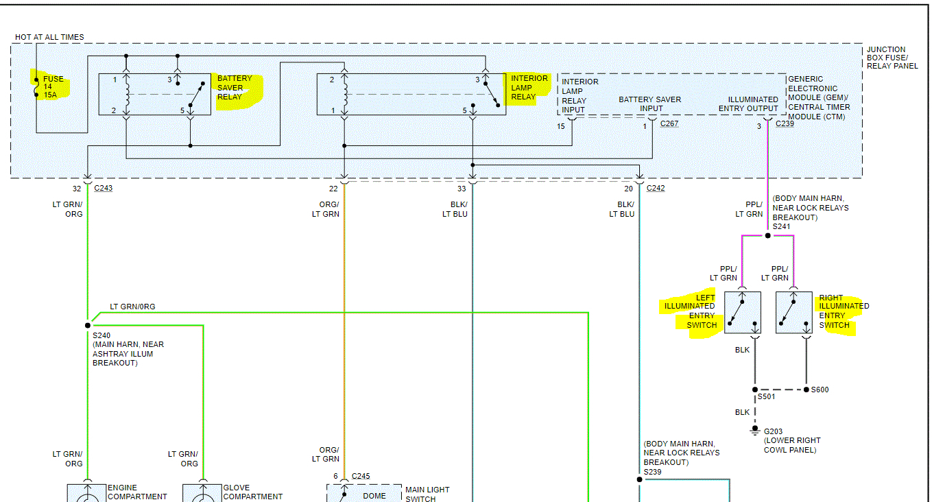

Chances are one of the interior lamp switches in the doors has failed or the interior courtesy light relay is bad. As far as the fuse, if you look at pic 1, I highlighted the fuse. Also, I highlighted the relays as well.
Pic 2 shows the fuse location as well as the relay locations. If you want, check the relays.
Here is a link that explains how to test a relay:
One more thought that may be the easiest thing to check. Make sure the door ajar switch isn't stuck. Pic 2 shows the location. See if it moves in and out easily. Also, if it is stuck, you will need to spray it with a lubricant and try to work it so it loosens.
