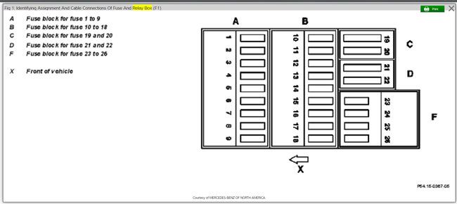

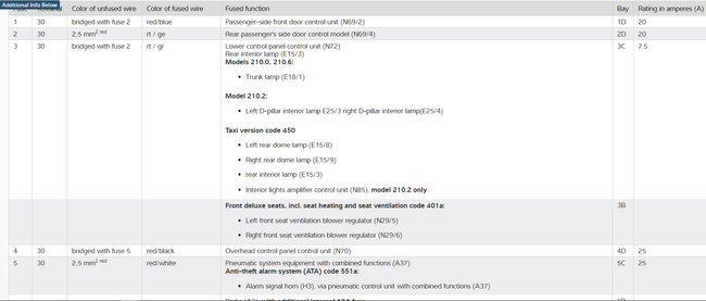

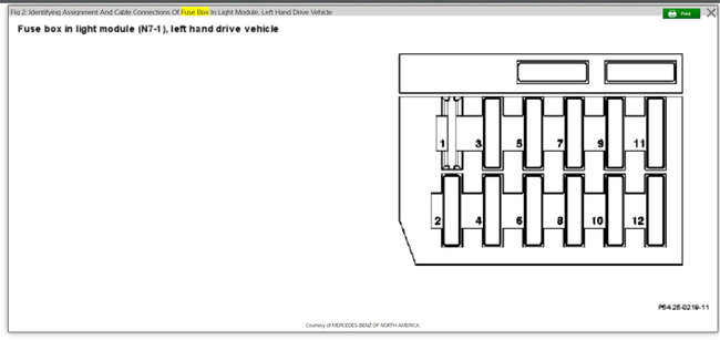

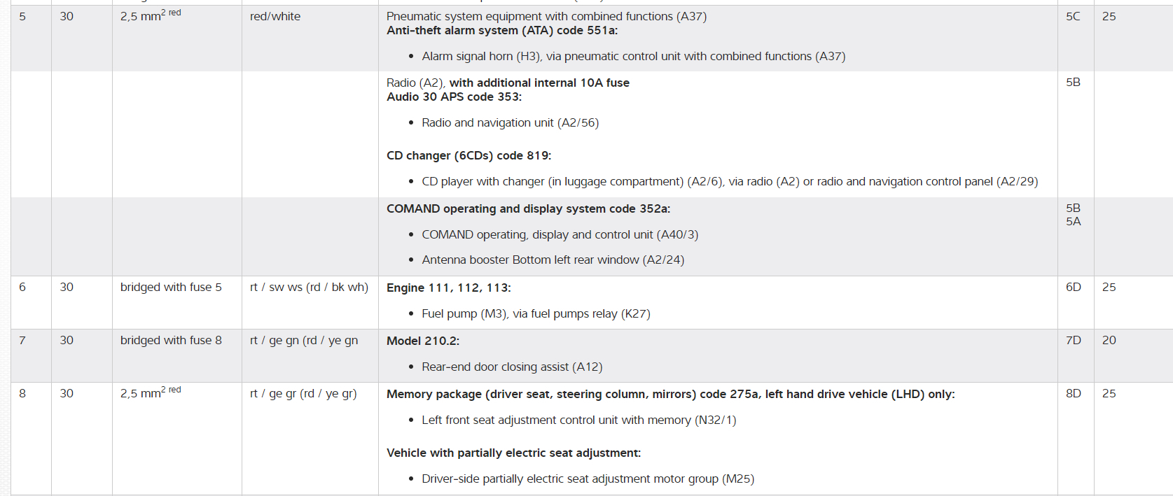

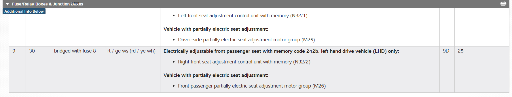

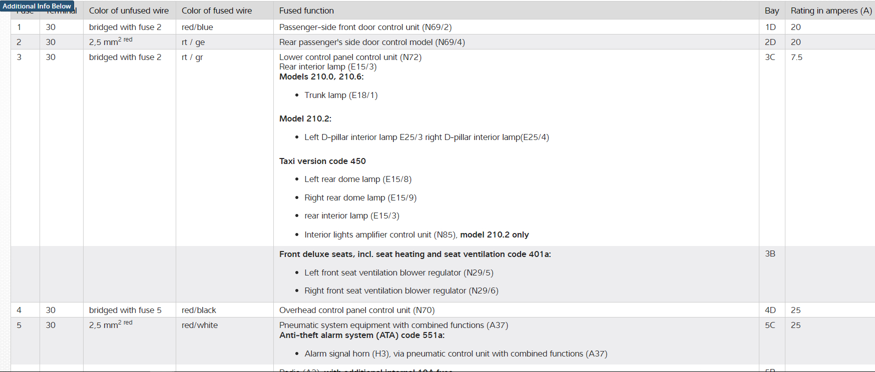

Where is the fuse box and which fuse controls the gear shifter release for automatic transmission? I am stuck in park and can release by pushing emergency release switch. Thought I would check fuse before going in to mechanic. Brake lights work and all other electronics. Thank you!
Jul 30, 2017 at 1:14 AM
  • 55,423 POSTS
Here is a guide to help you do some testing and some diagrams (below) to help you find out which fuse is blown.
Please run some tests and get back to us we are interested to see what it is.

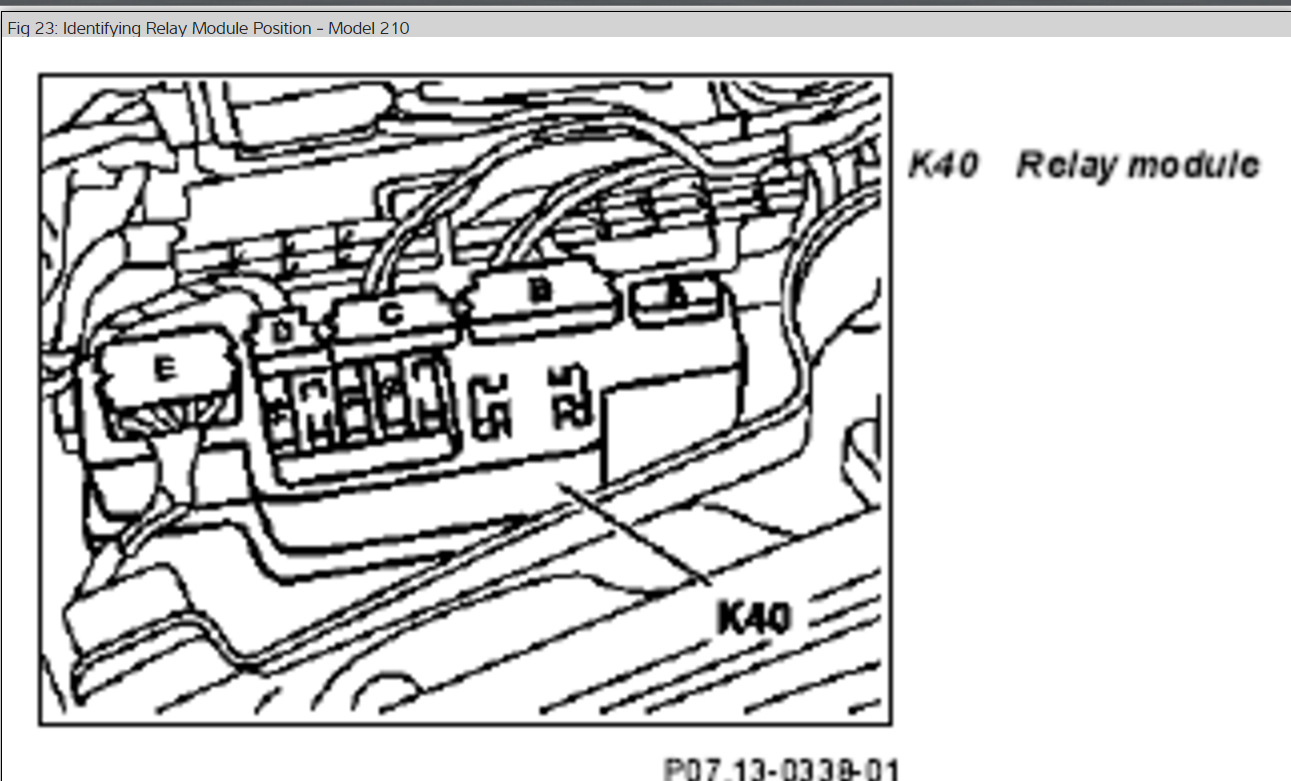

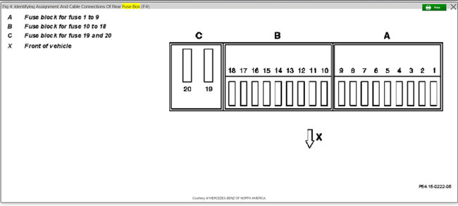

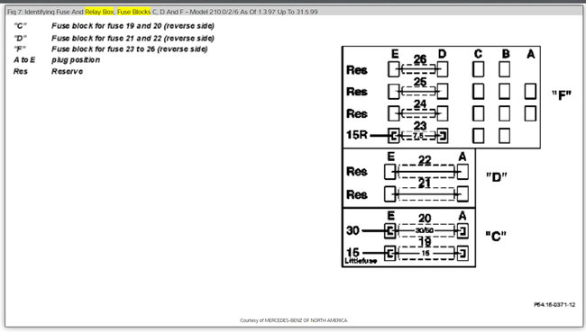

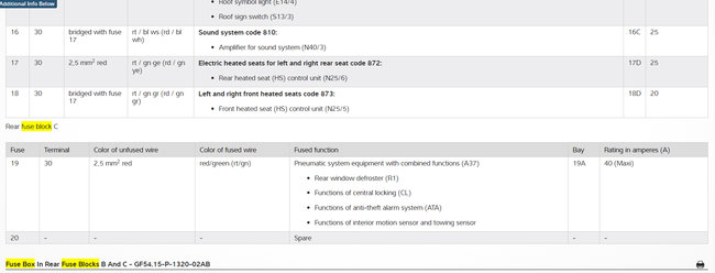

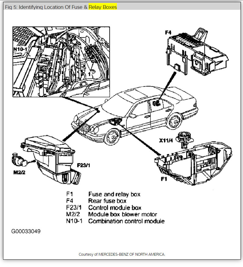

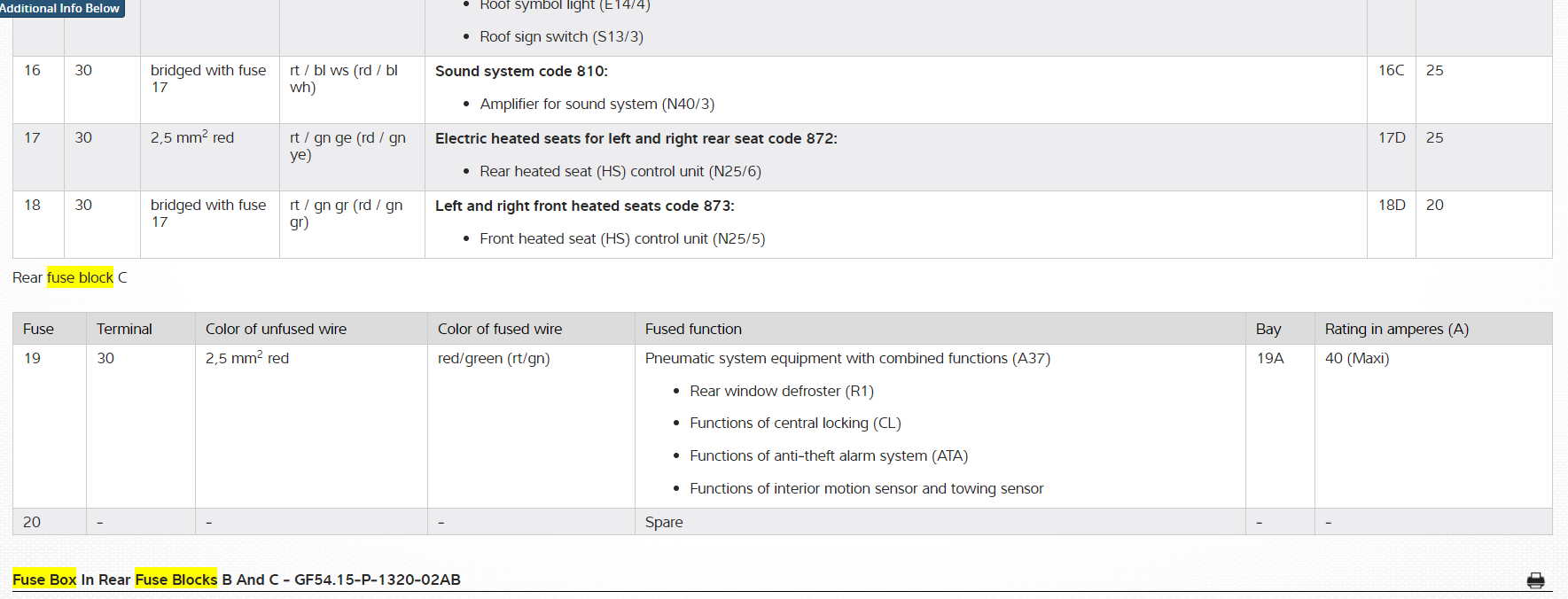

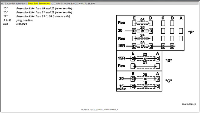

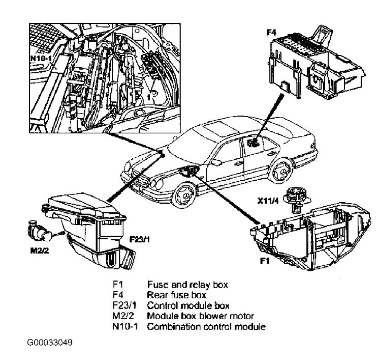

DRCRANKNWRENCH
  • 3,380 POSTS
Attache are fuse/relay box locations and labels except for inner engine compartment box on passenger side.

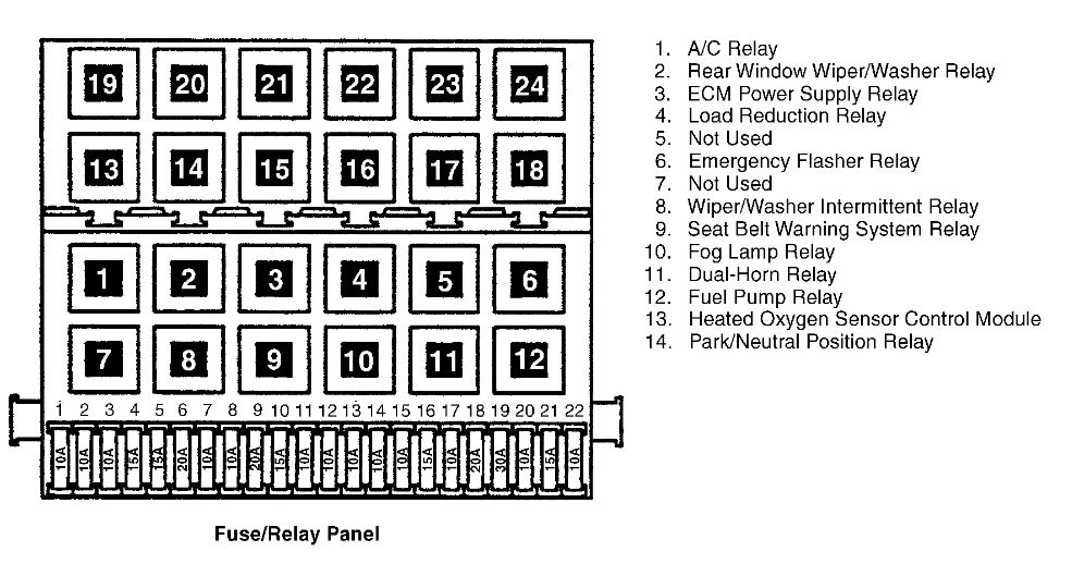

TIBLOC
where is the relay that controls heater and wipers for a 1997 Jetta.
Jul 31, 2017 at 5:10 AM (Merged)
DRCRANKNWRENCH
  • 3,380 POSTS
Attached is the only relay panel I could find. It did not say location but it is either under the hood or under the dash on driver's side.
