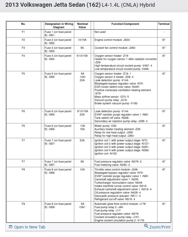

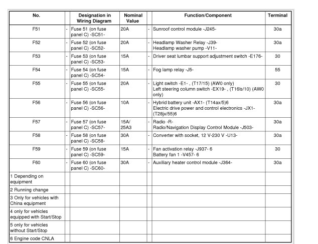

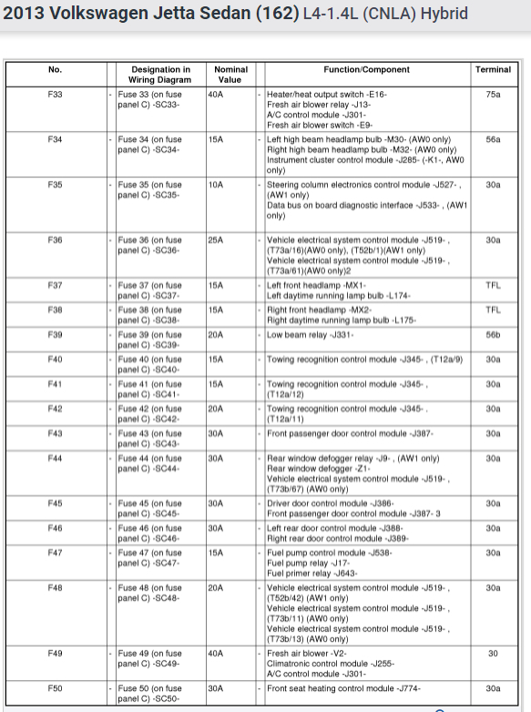

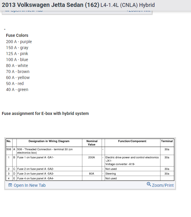

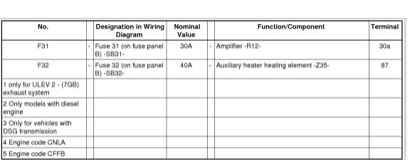

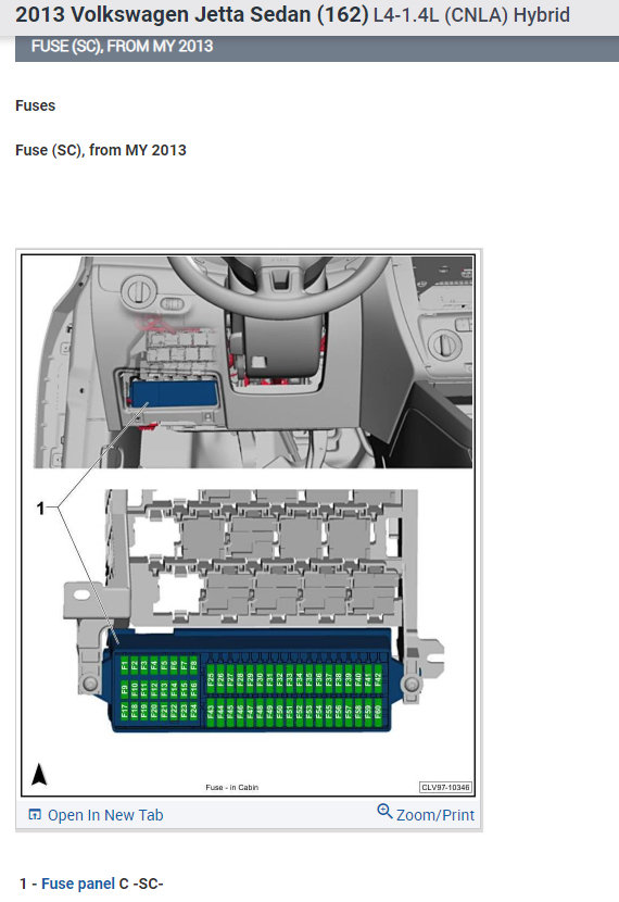

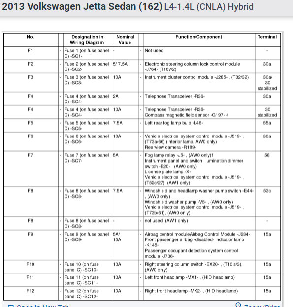

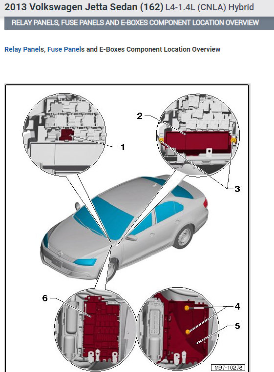

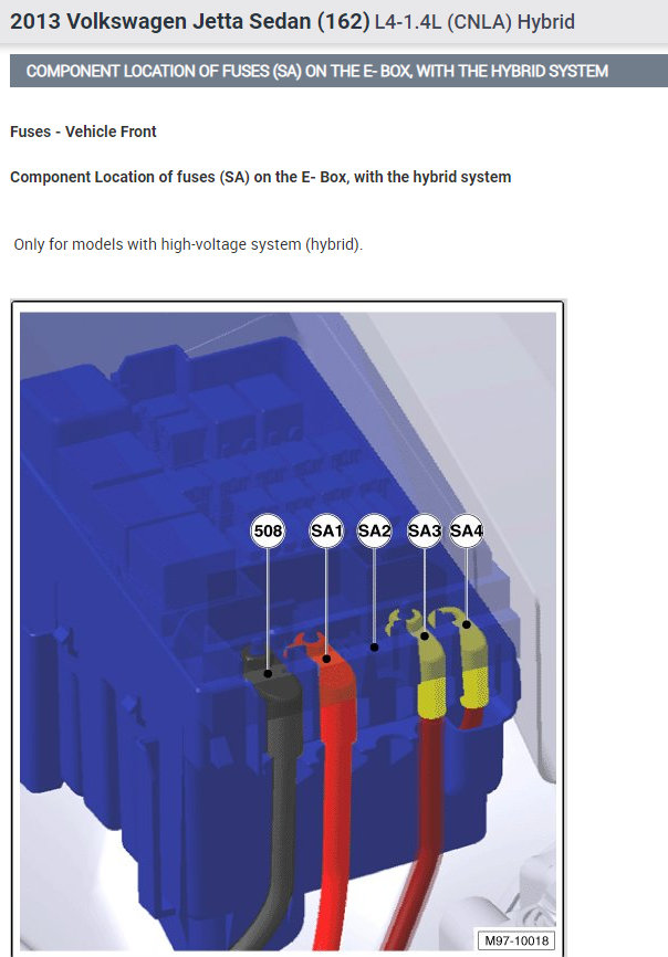

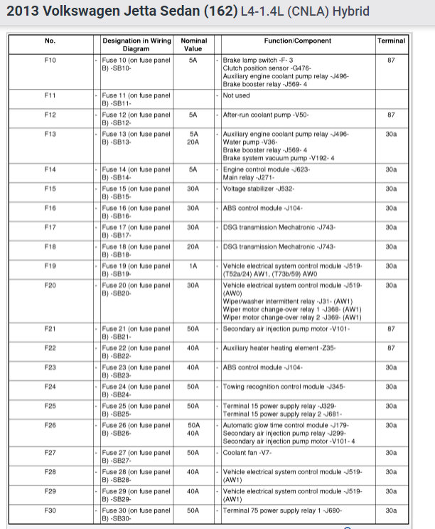

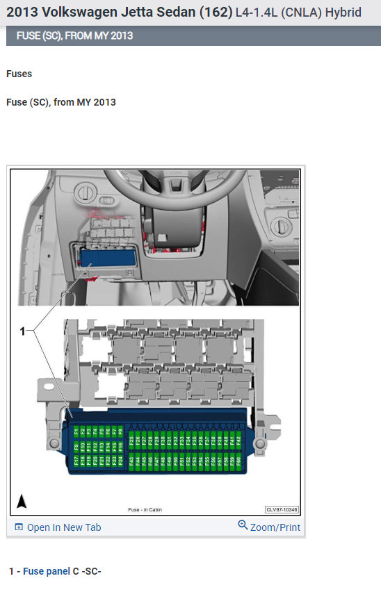

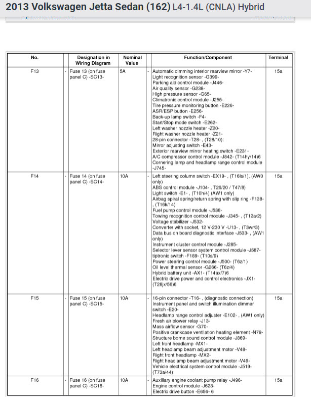

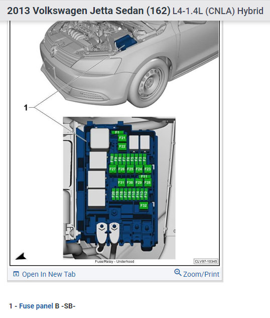

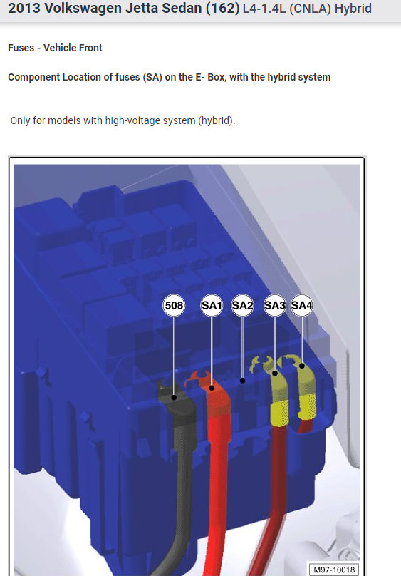

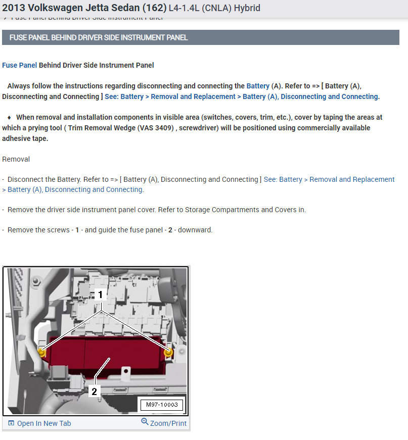

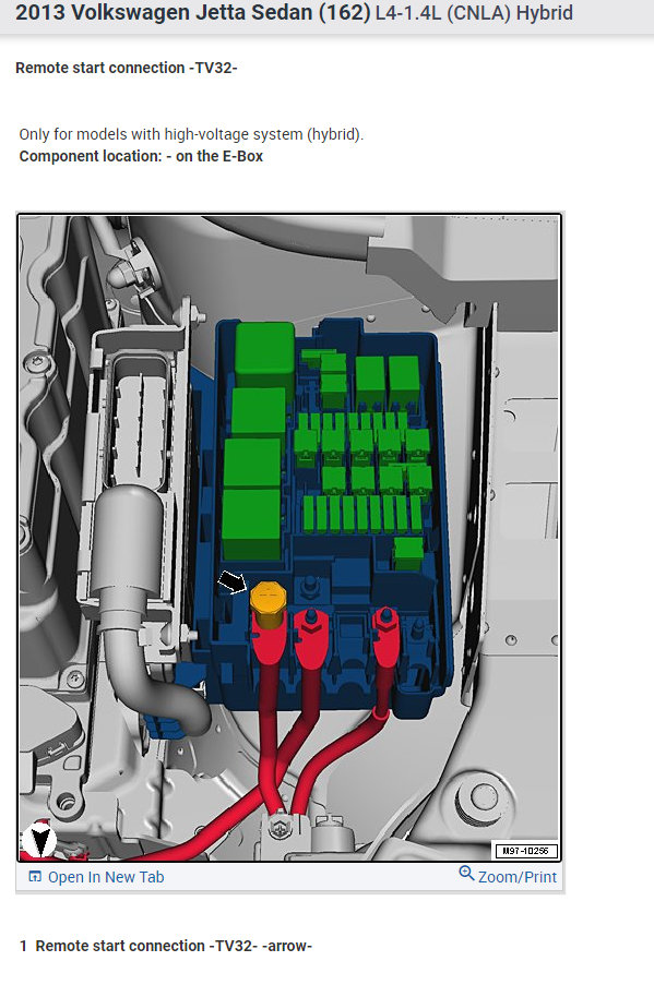

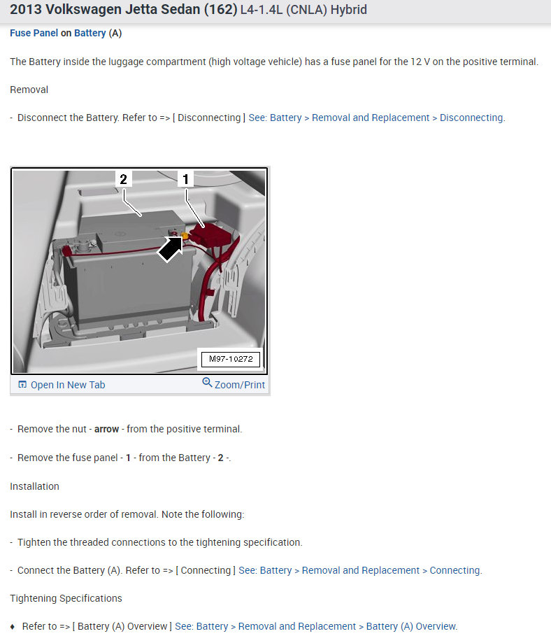

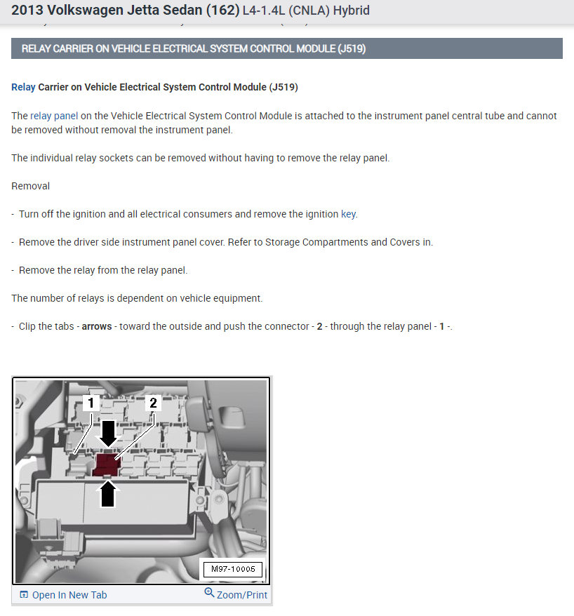

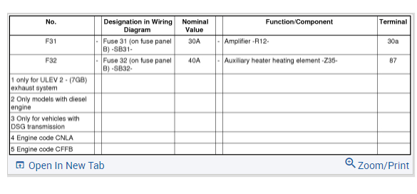

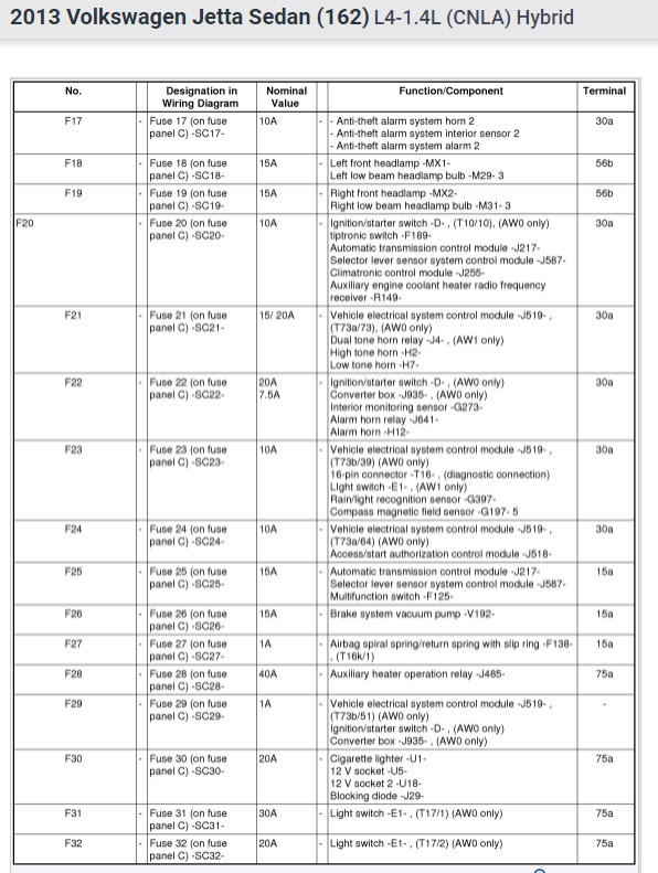

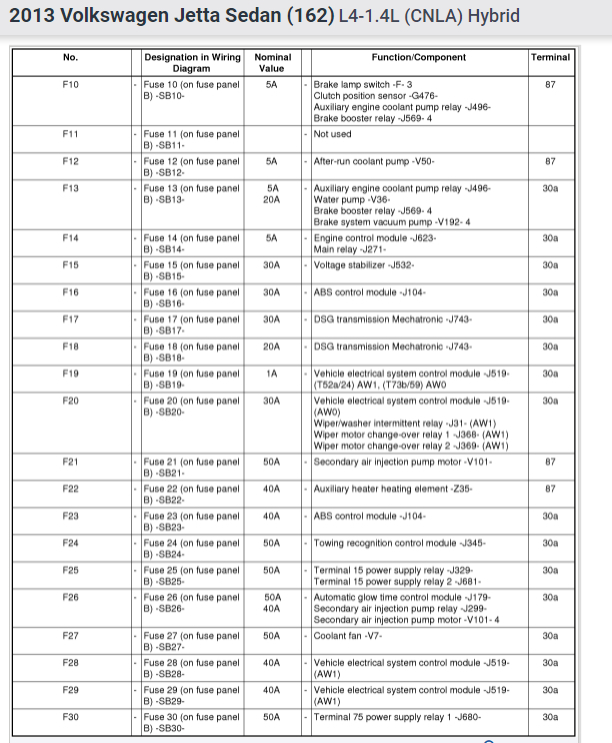

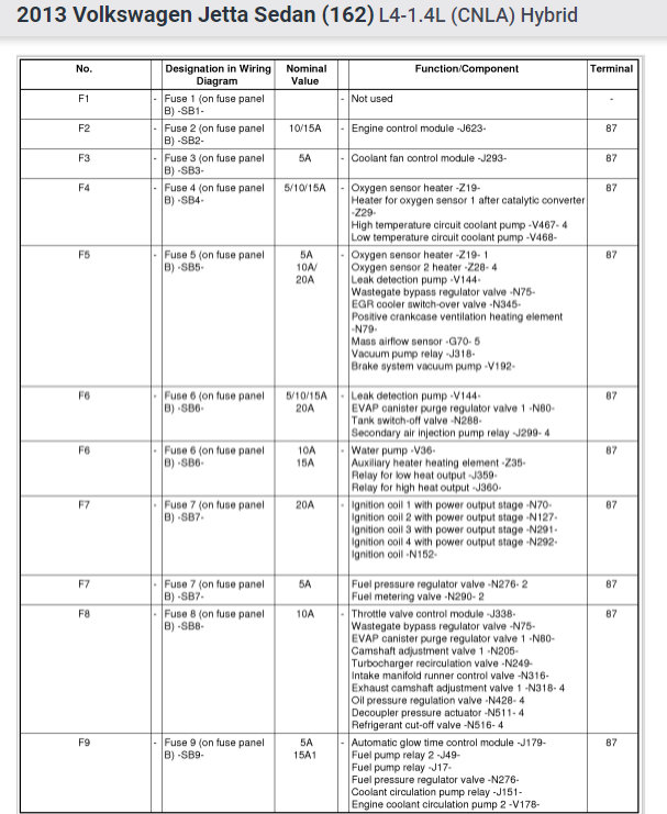

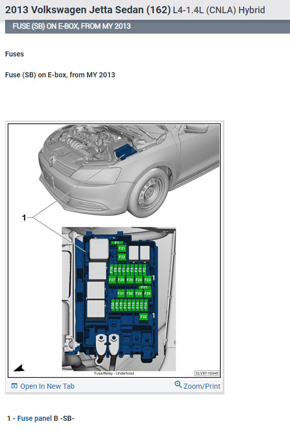

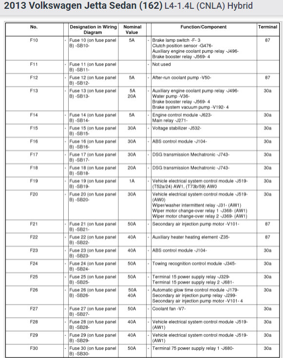

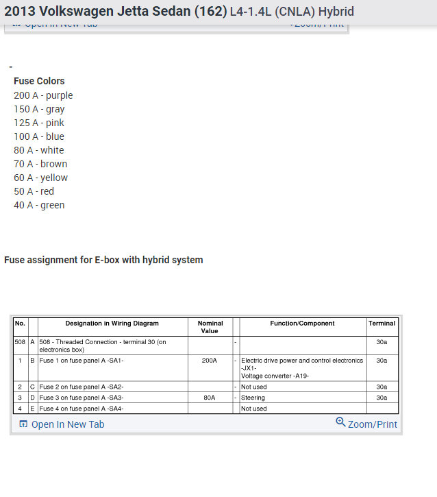

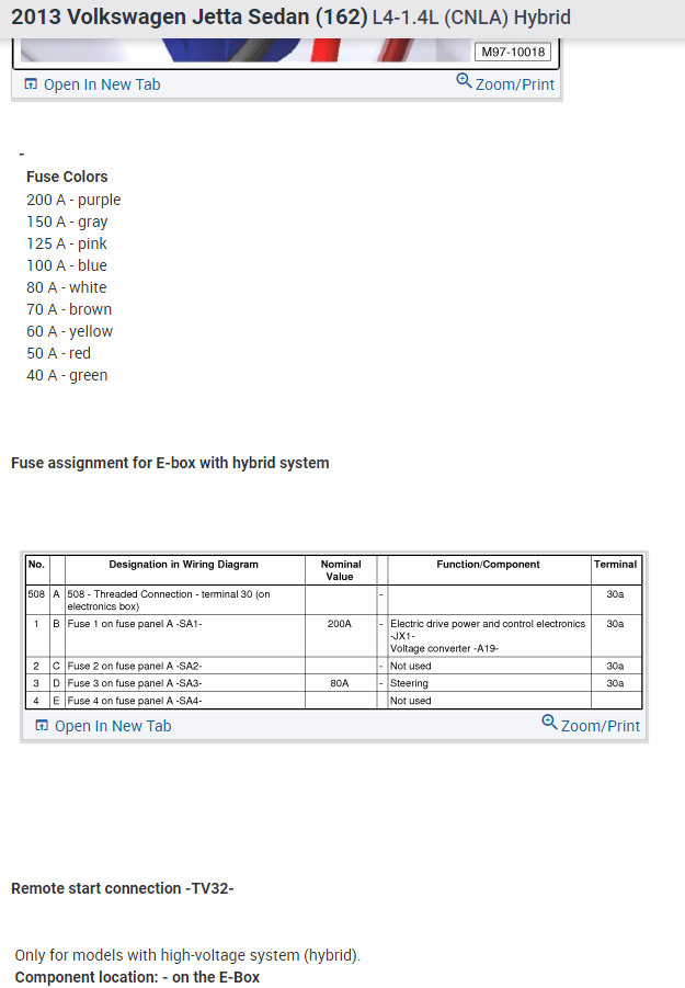

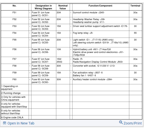

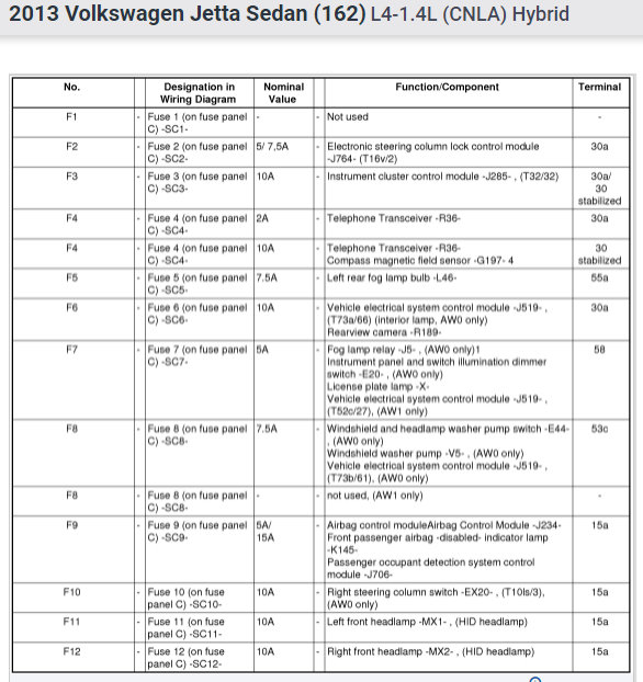

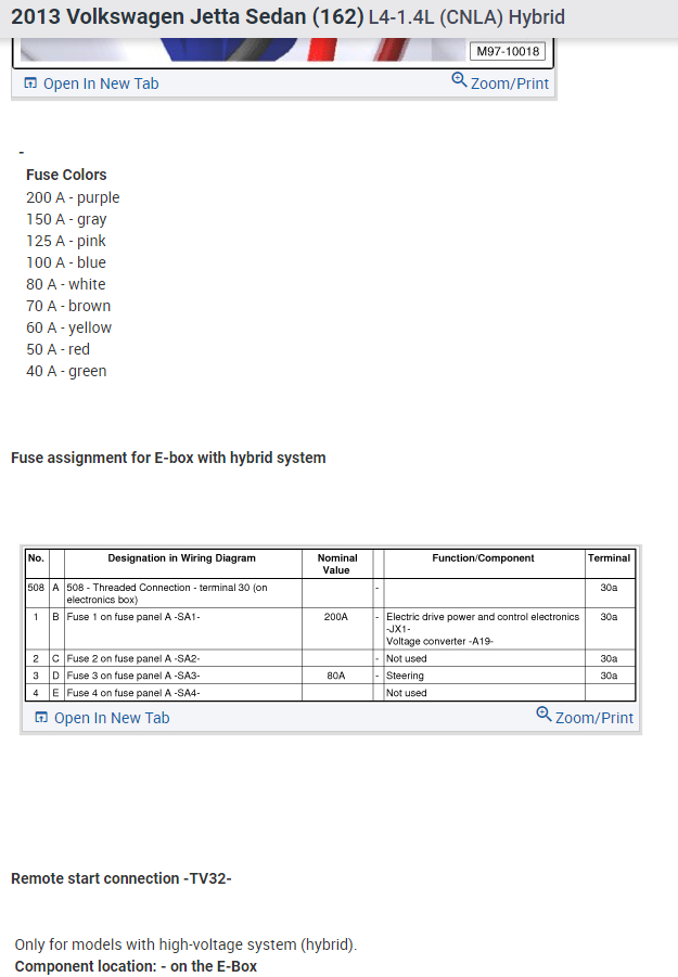

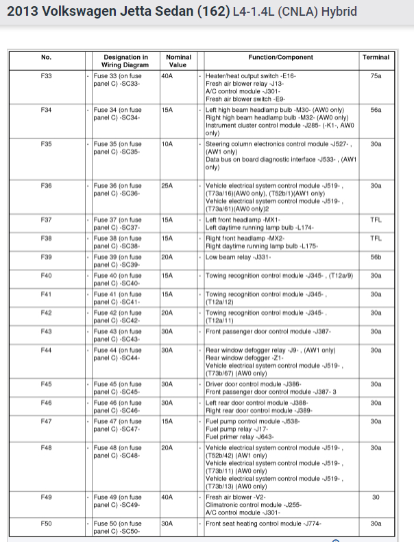

Need a fuse diagram please. I have no manual and need to find the fuses
Aug 24, 2021 at 12:26 AM
SQM
Experienced Mechanic
6,383 POSTS
I have attached diagrams for all the fuse blocks for your reference.
https://youtu.be/Hlna_kUt7As

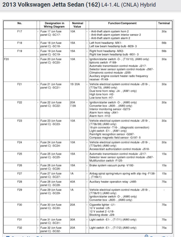

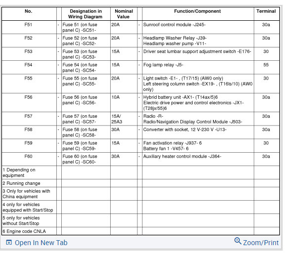

I need the fuse card to see what fuse goes where.

Look below for the fuses and relay diagrams and descriptions.
Let me know of any questions.
