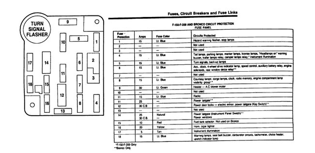

Need to know what the fuses go to so we can hook the inside components up. Thank you for your time.

I attached a diagram of the fuse block with fuse locations, amps and what they control.
