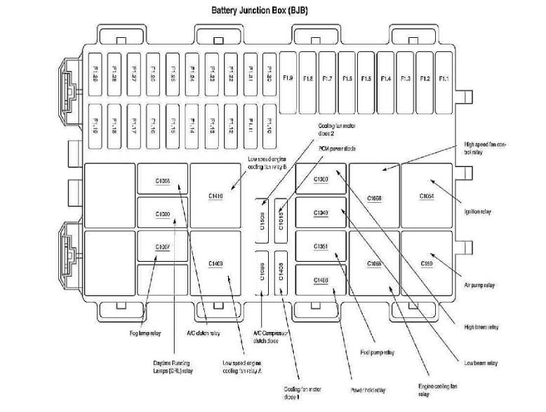

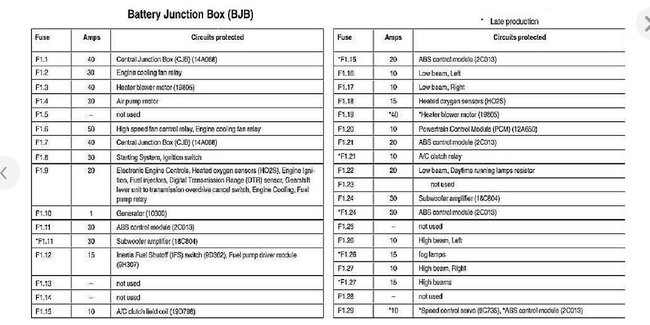

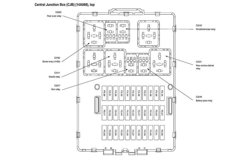

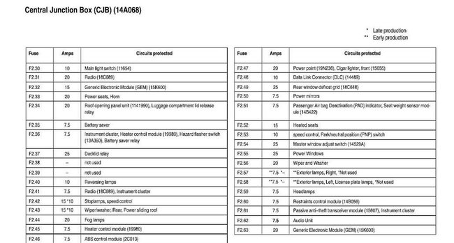

Can someone help me get a fuse box diagram for both fuse boxes please? Thank you
ZX4 ST model.
Apr 26, 2019 at 5:36 AM
Good afternoon,
I attached both fuse boxes and the identification of the fuses for you below.
Apr 26, 2019 at 6:14 AM

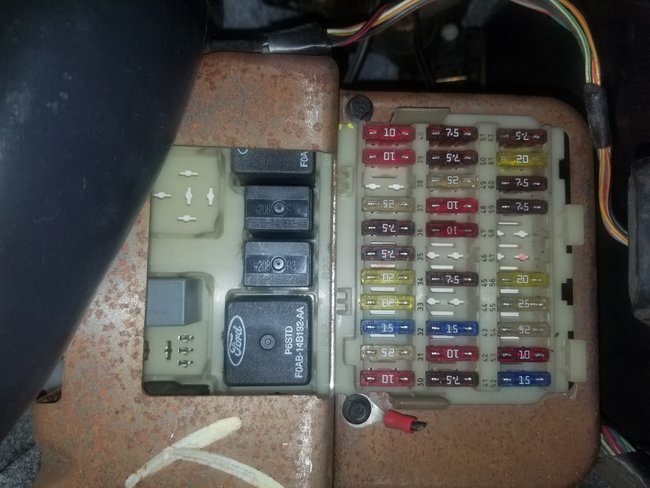

Quick question.My fuse box only has up to #62 with no #63 and the diagram has a #63 fuse and there is no asterisk or any comment referring to this being on only some models. So I'm wondering if that is just normal and it is the right diagram. Needing reassurance I guess before I start changing around my fuses. Thanks
Apr 26, 2019 at 7:06 AM
Sometimes there are options that are added and the diagrams do not reflect it.
Apr 26, 2019 at 7:12 AM
NATALIE ALLISON
That's what I was thinking. The only other thing that made me ask was that #44 and #46 aren't an options but I do in fact have fog lights and ABS so I'm guessing if this is the right diagram then for some reason a fuse is simply not needed for those items. I won't pretend to know all about cars, its the one thing that's never interested me in my free time unless necessary but I do have the power of common sense so my apologies for all the questions. It is a learning process.
Apr 26, 2019 at 7:37 AM
Yes it is.
