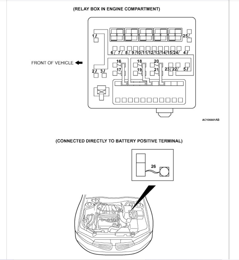

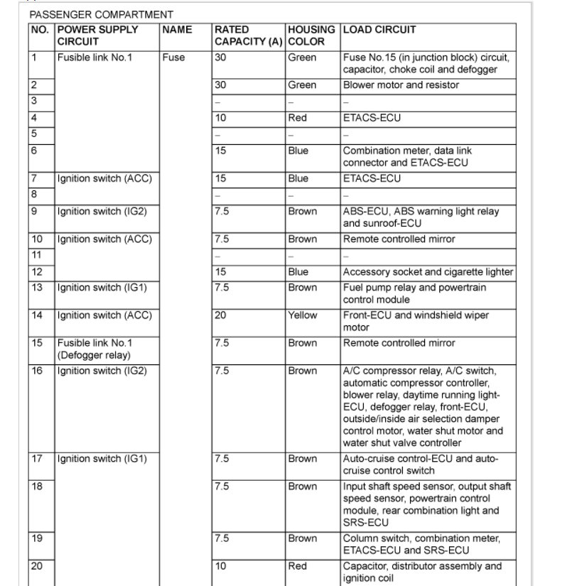

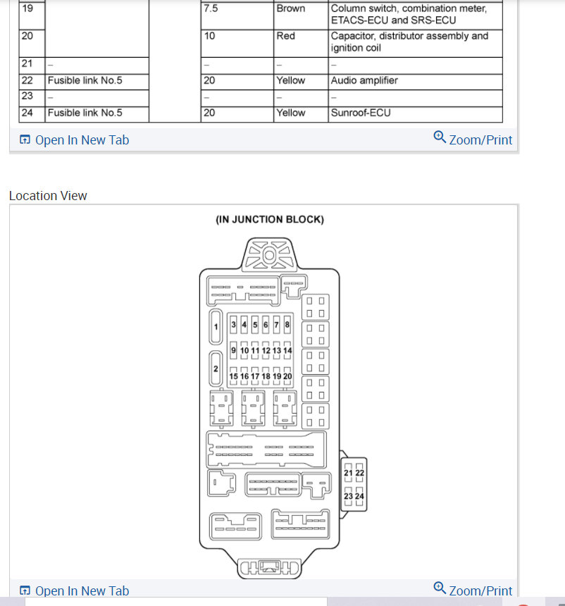

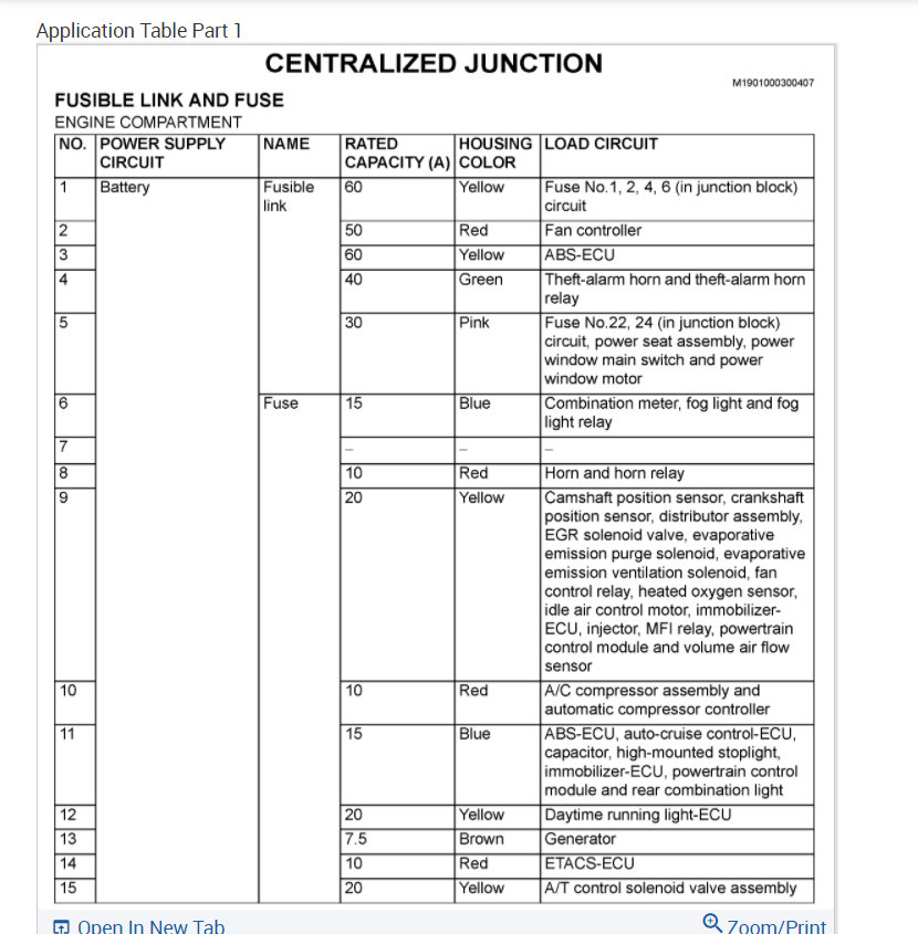

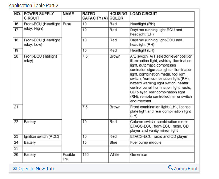

does anyone have a fuse diagram for the car listed above? i need both diagrams.
Apr 14, 2021 at 5:40 AM
Experienced Mechanic
52,796 POSTS
Good afternoon,
I attached the fuse box picture plus the legend for all the fuses for you.
