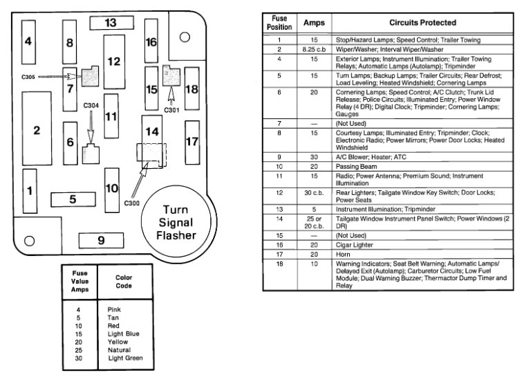

Cannot find reliable diagram.

Hello, I'm Danny.
I've attached a picture below of the fuse block you requested.Let me know if this what you were looking for.Hope this helps and thanks for using 2CarPros.
