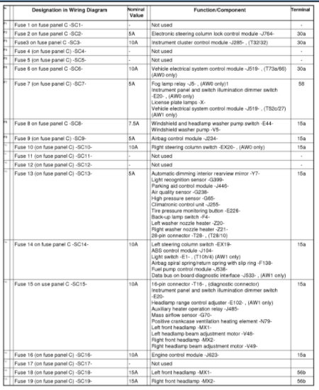

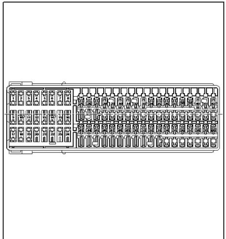

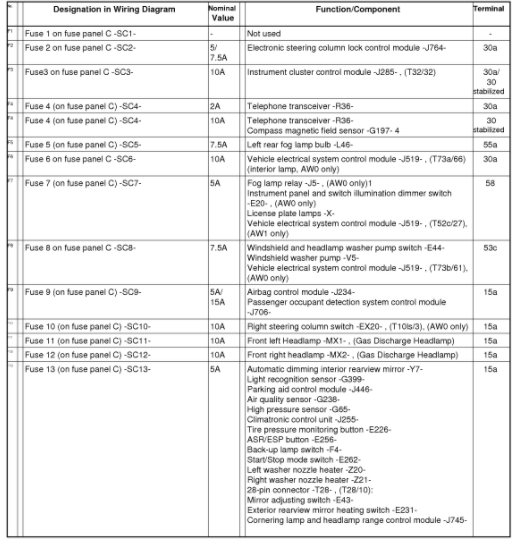

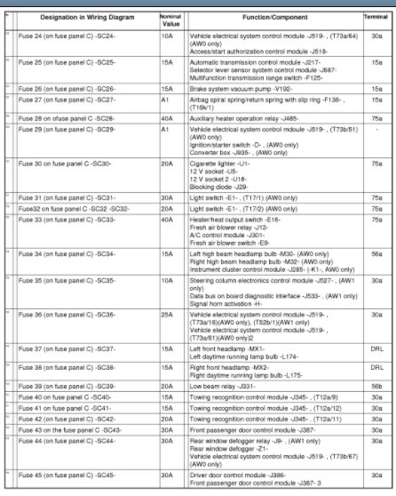

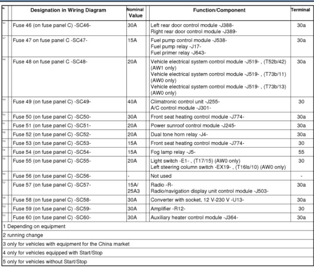

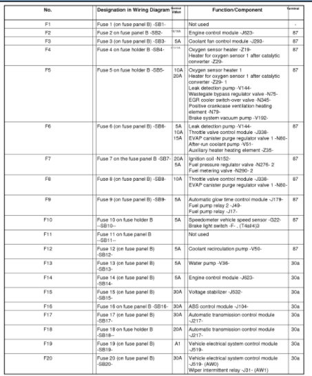

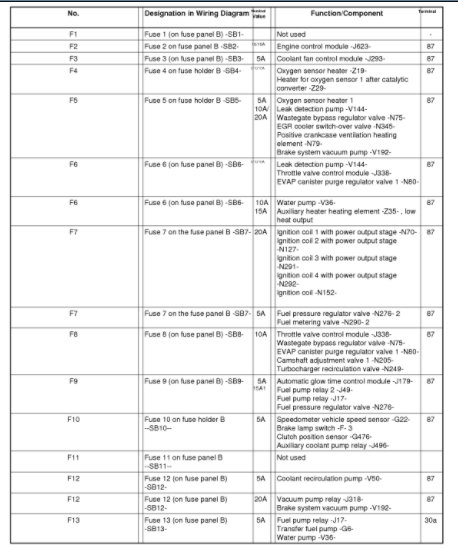

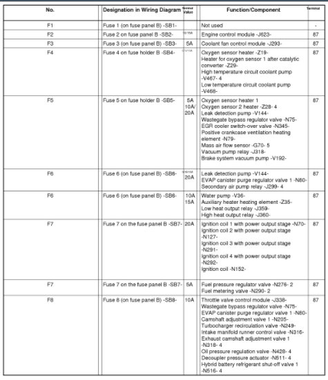

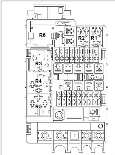

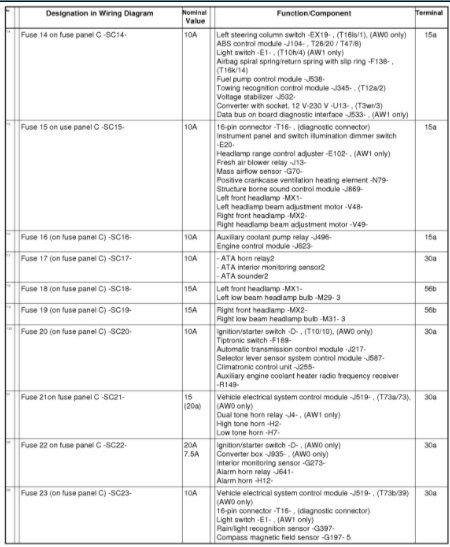

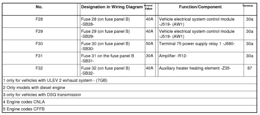

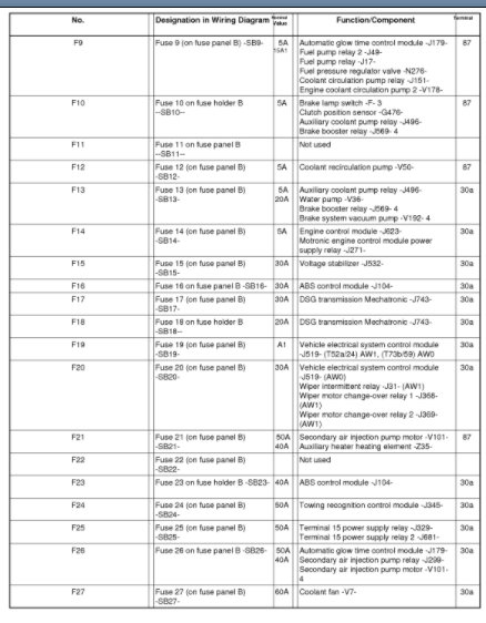

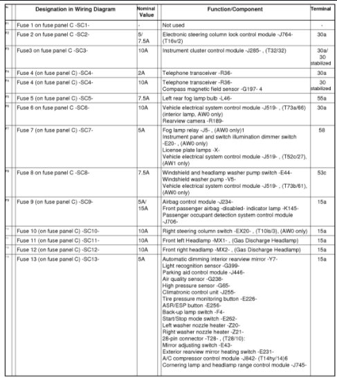

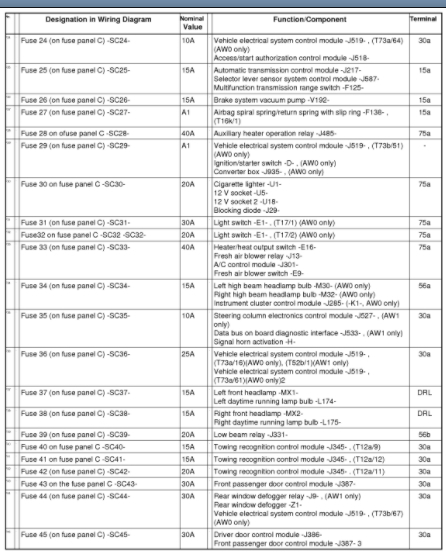

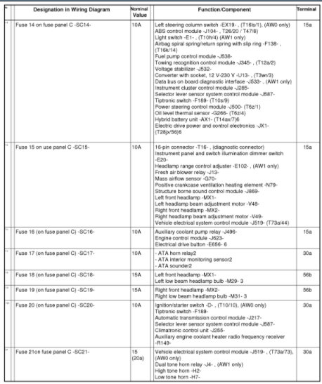

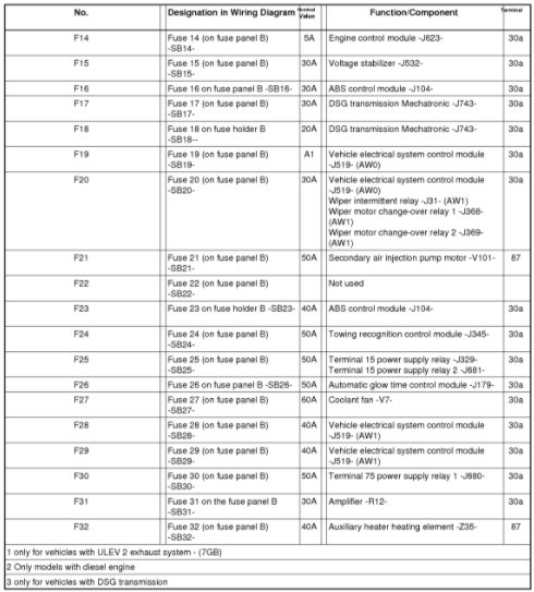

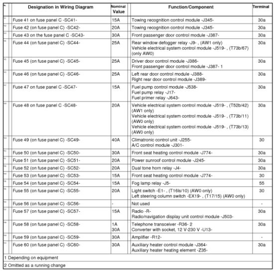

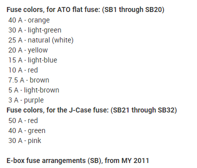

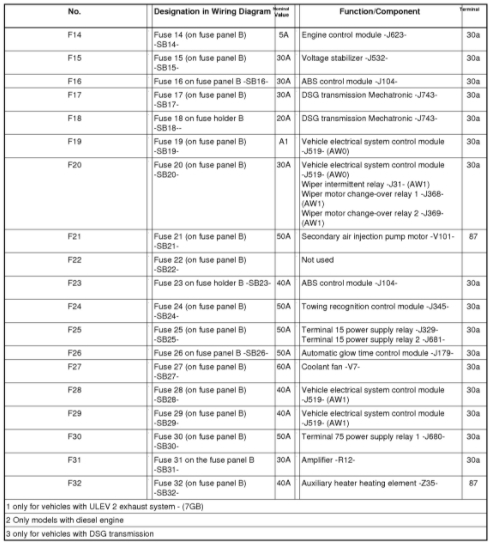

I'm looking for the fuse diagram for the car listed above Comfortline.

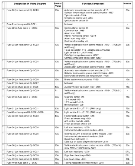

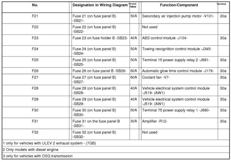

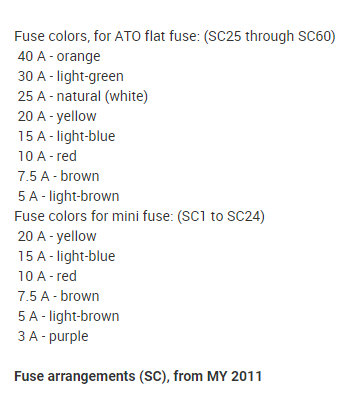

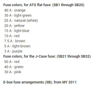

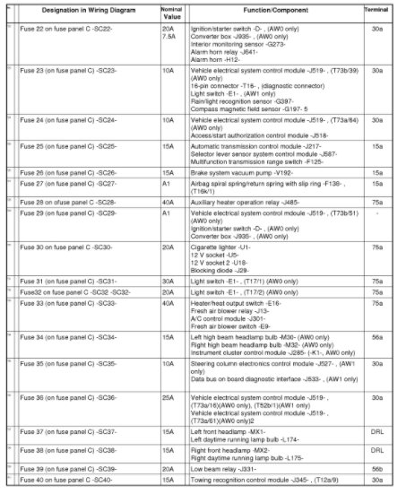

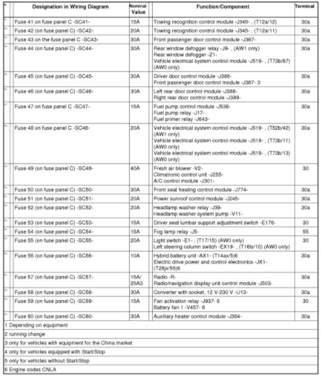

Here is the information you requested. Here is a fuse change and testing tutorial for you to start with:
I've attached the fuse information pictures below for your vehicle. Hope this helps and thanks for using 2CarPros.
