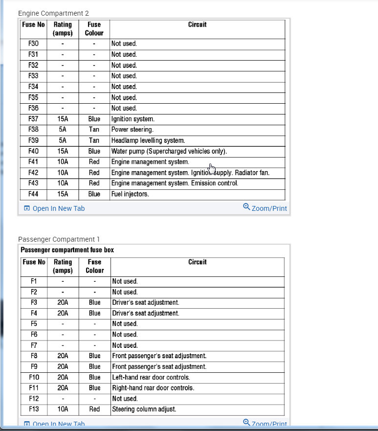

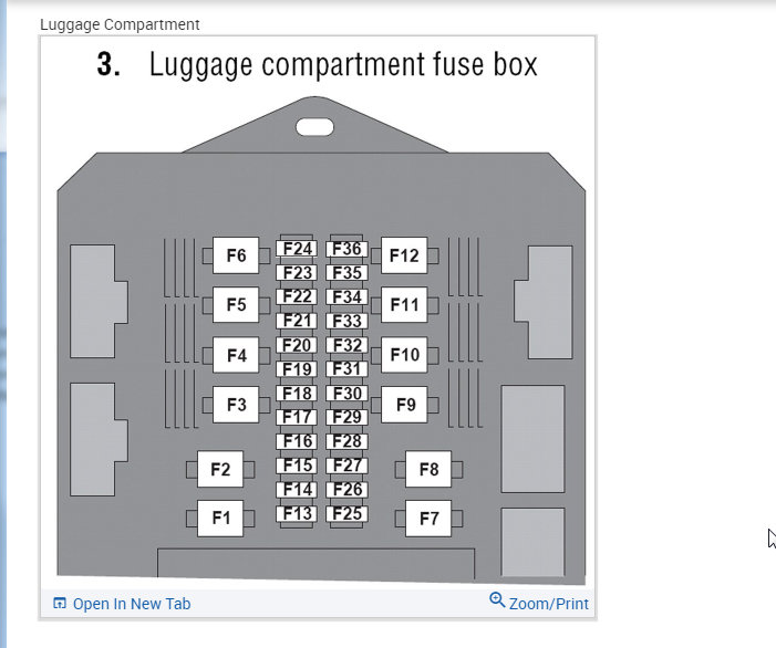

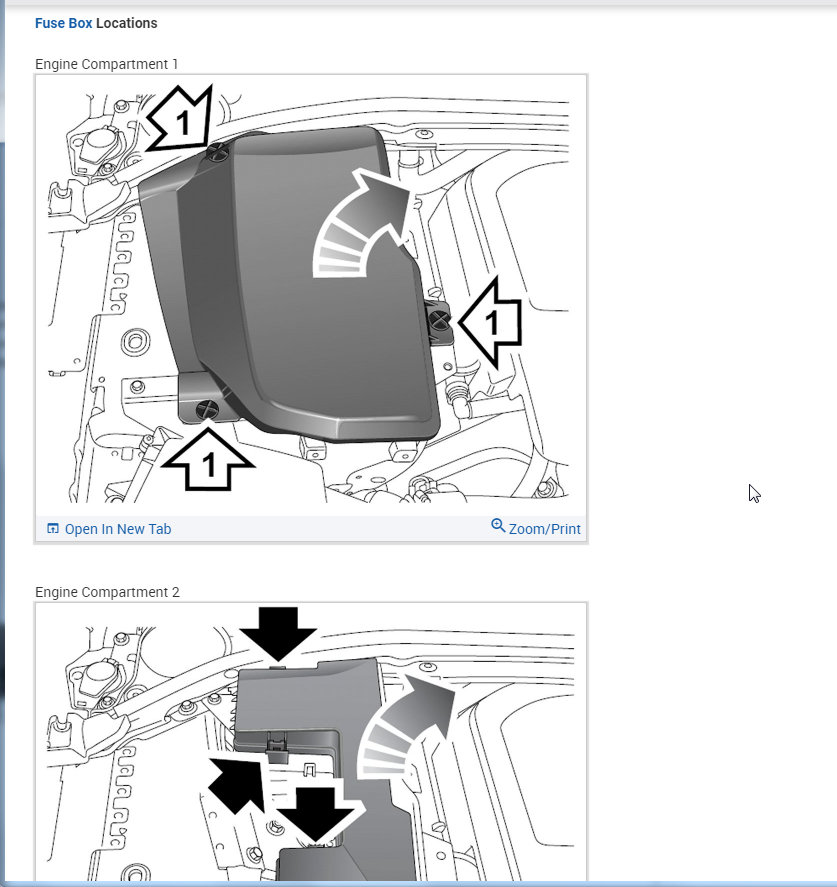

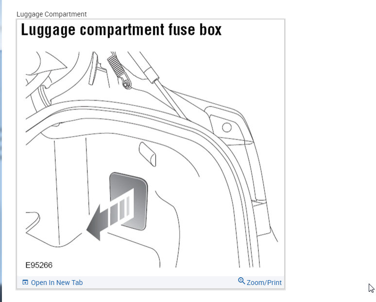

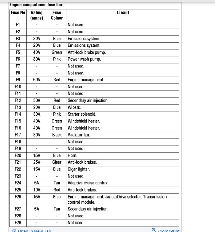

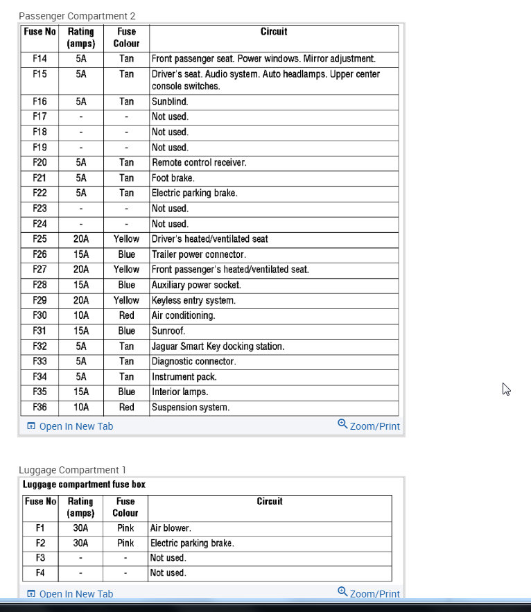

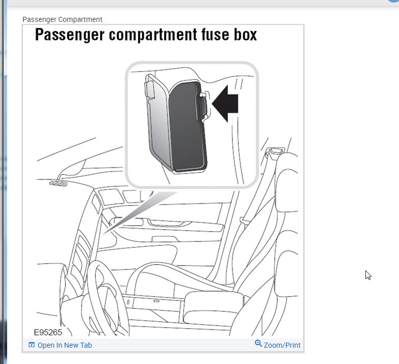

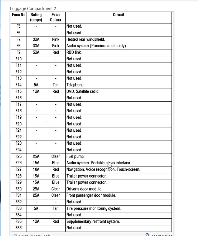

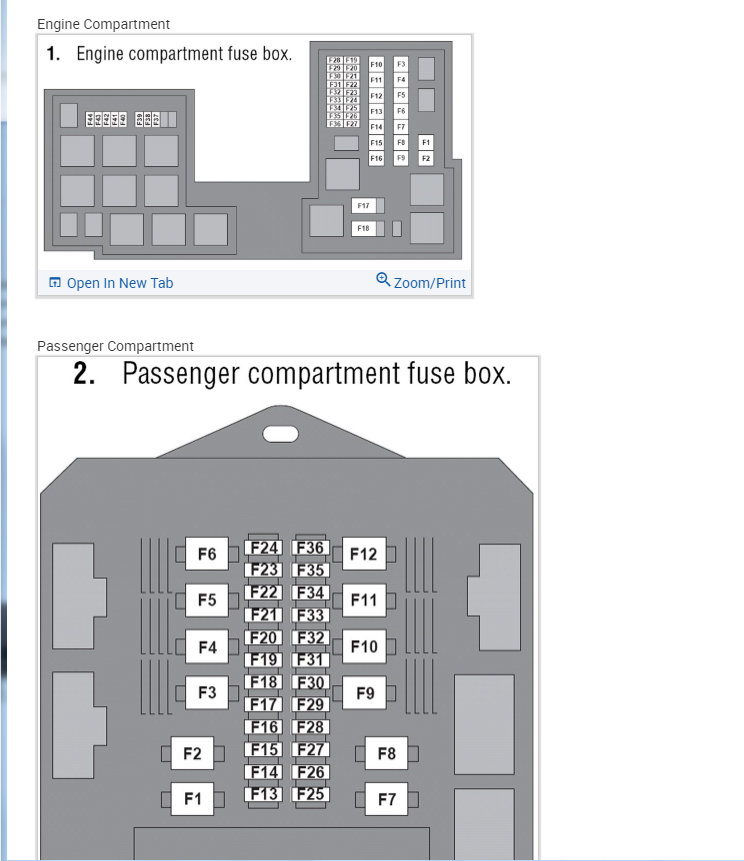

My glove box and vanity lights do not function. I suspect a bad fuse but because I cannot get into my glove box where my manual is, I cannot determine which fuse to replace. Can someone please post pics of the Fuse Diagram for the vehicle listed above that shows which fuse box and the type of fuse needed for the vanity lights and glove box?
Aug 3, 2020 at 8:45 AM
Understood. You are probably correct. Please see the attached info. Let us know what you find. Check out the diagrams (Below). Please let us know if you need anything else to get the problem fixed. Thanks
