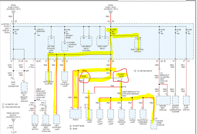

I need to know the connection between these 3 fuses (11-33-34) because whatever it is, it's causing a drain on my battery. I've pin pointed that it is these 3 causing the drain .

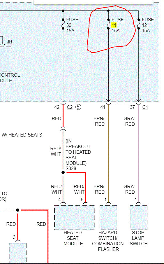

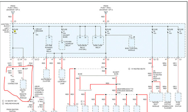

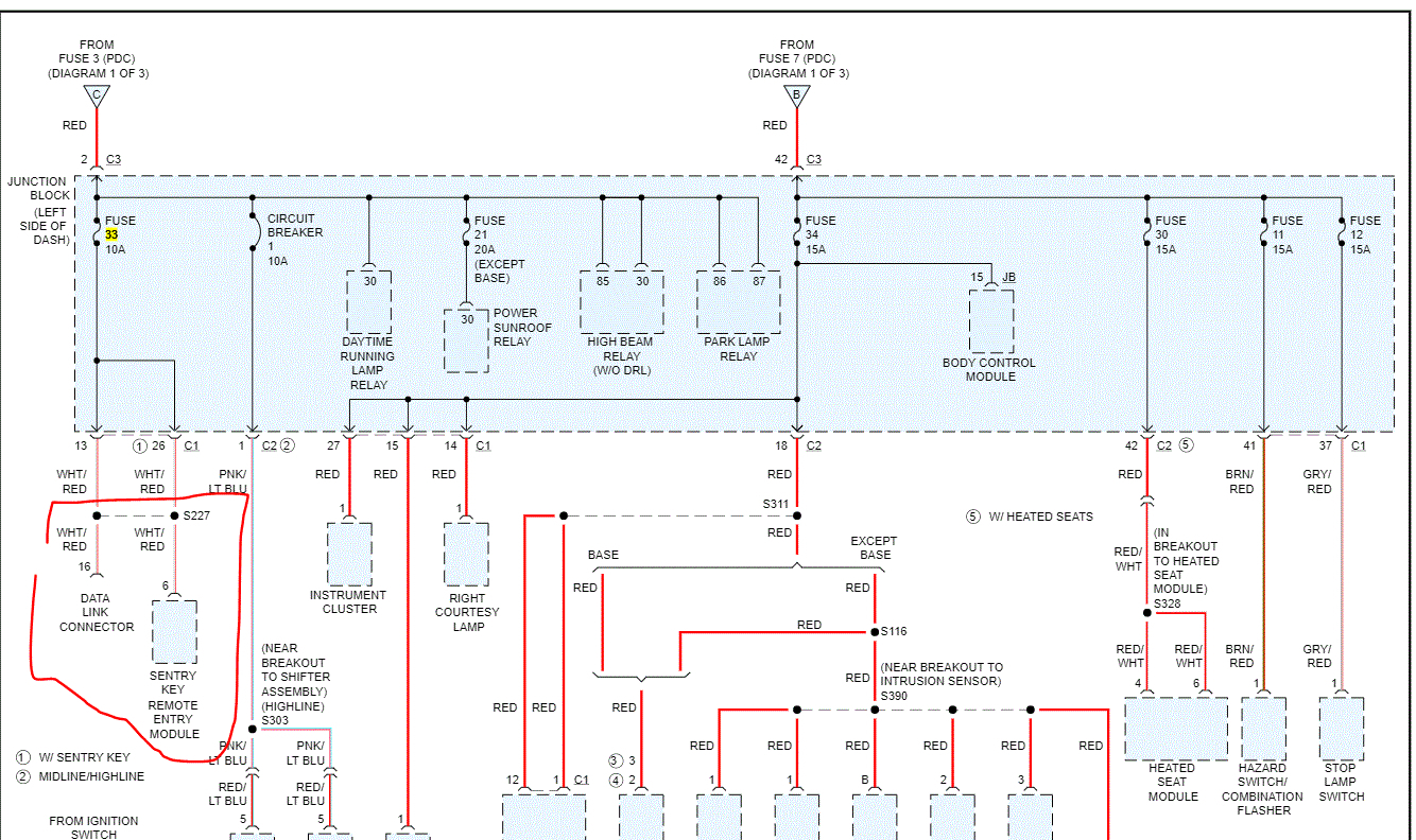

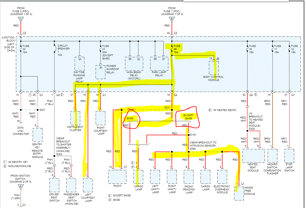

I tried looking for a legend, but there isn't one for this vehicle, so I went to the power distribution schematics. I attached those pics below showing the fuses you mentioned, and you will need to follow the wiring from the fuse to what it powers.
I hope this helps. Let me know if you have other questions. Also, are you certain all three of the problem? A certain voltage draw is normal.

Were the schematics helpful? Also, was it the same voltage drop regardless if which of the fuses was removed? As far as the connection, the only one that I see could be the body control module. Can you tell me what the voltage draw was? Also, let me know if it was the same for each of the three fuses.

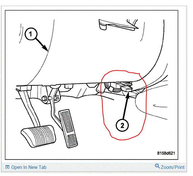

Same voltage for 7.2 and i just changed my BCM which didn't solve it. Only other thing we can thing of is the data link connector, do you happen to know where that is?

I attached a pic of the data link connector location.
Let me know what you find.
