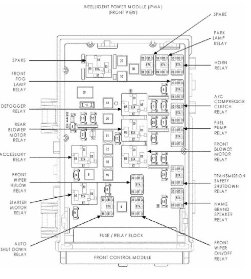

Where are all the fuse boxes located? I know one under hood but where else?

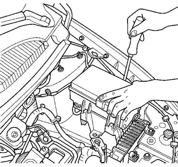

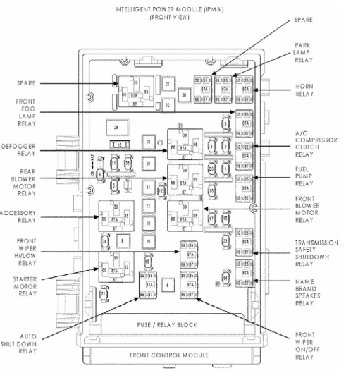

The under hood engine compartment intelligent power module is the only one located on your vehicle.Here is a tutorial showing how to test fuses if needed:
I've attached a picture of the intelligent power modules location and fuse identification below.Hope this helps and thanks for using 2CarPros.
