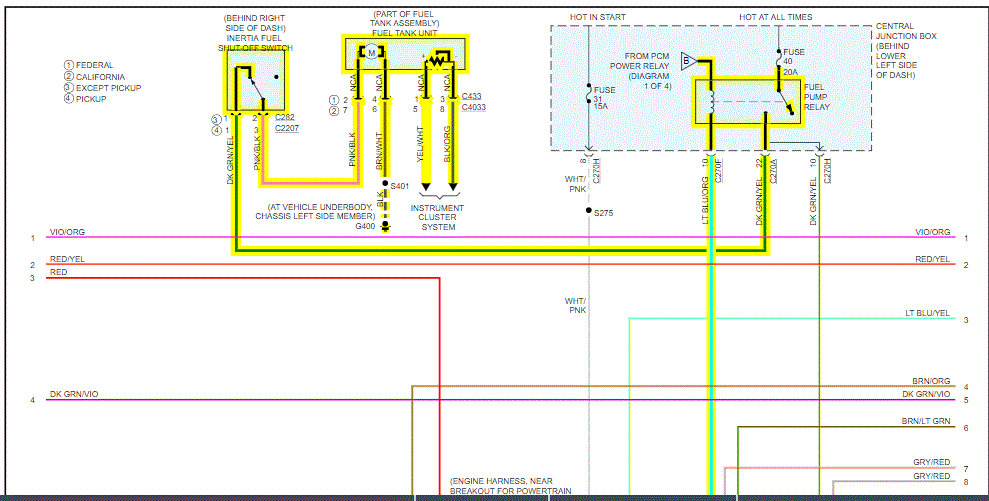

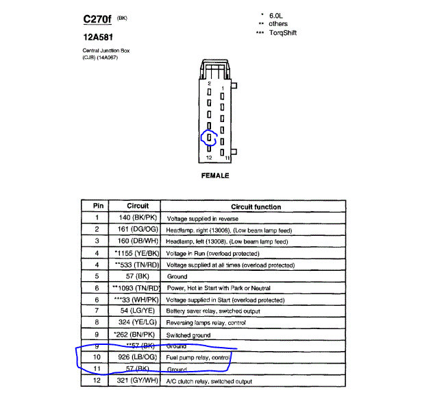

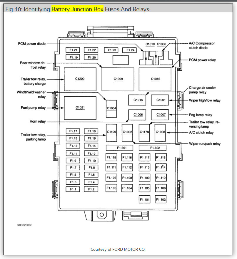

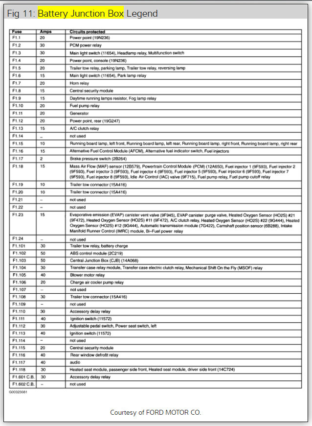

The fuel pump relay built into the fuse box has melted and I'm looking for the wiring diagram for the back of the fuse box so I can try to put in an external relay.

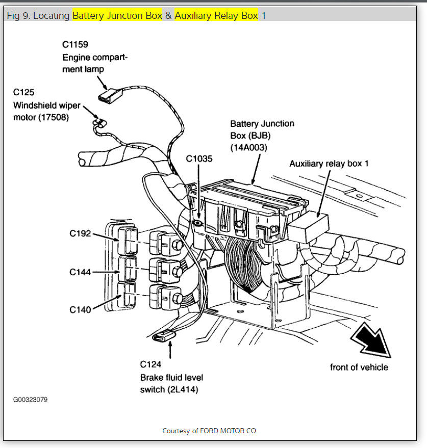

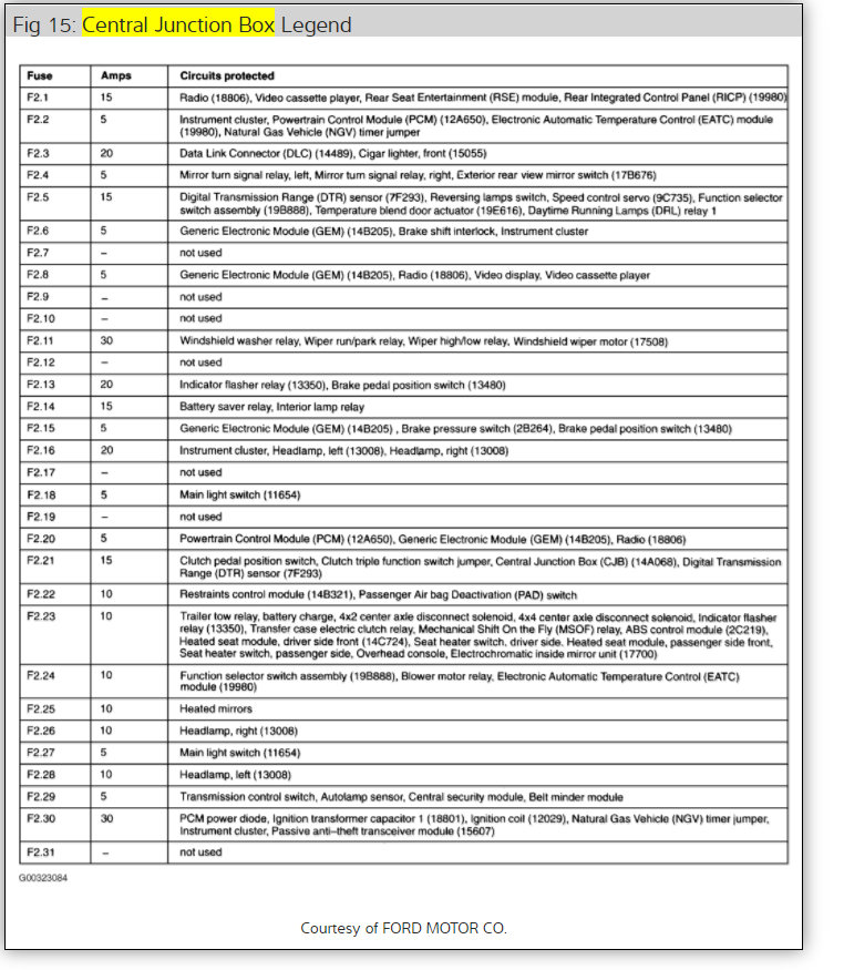

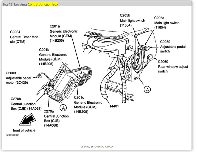

Good afternoon,
I attached the connector with the fuel pump control circuit in it.
Why do you not just get another fuse block? How much wiring damage was done?

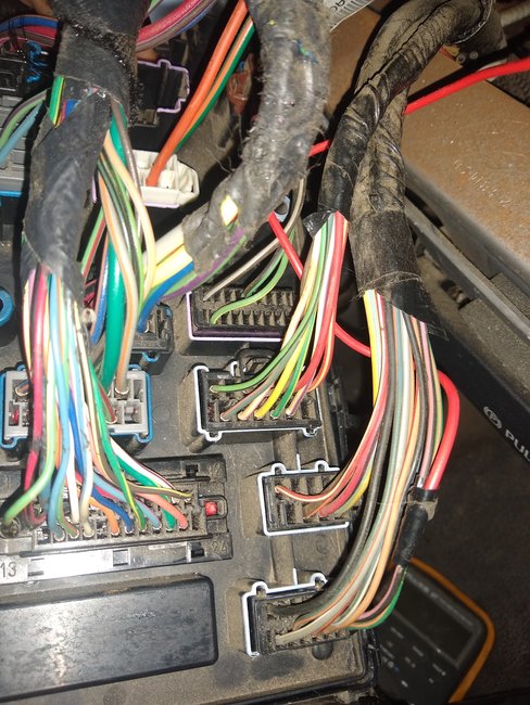

I've been looking for 3 weeks and everyone is different.. I have the truck listed above super duty XL.Only extras are A/C and a radio.. has to match or they don't work. the wiring problem I'm having is there are 2 green/yellow wires needed the wiring harness has 4 green/yellow wires.. the other wires I have figured out..

Okay, got it.
Can you post a picture for me of what you see with the wires? I need to see what you see.

Best shot I can get....
Aug 6, 2020 at 10:38 AM
Okay, thanks, where are the 2 wires that you have left to hook up?

Sorry if this sounds bad but if I knew the 2 wires I wouldn't have to ask and any help is grateful. a closer look there is 5 green/yellow wires and I need 2 of them. that's why I'm looking for a wiring diagram to show what each wire is...
