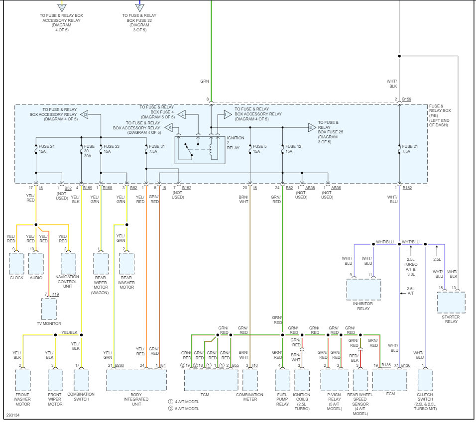

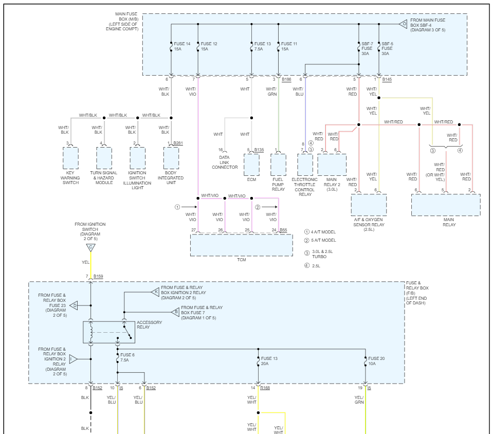

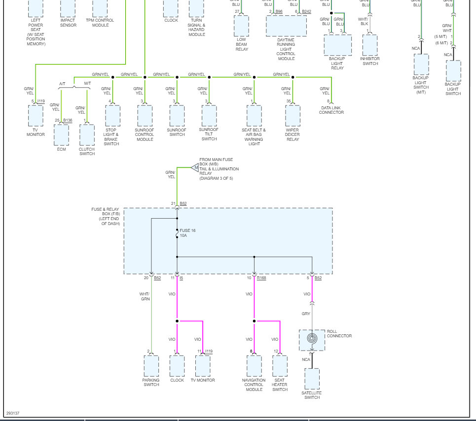

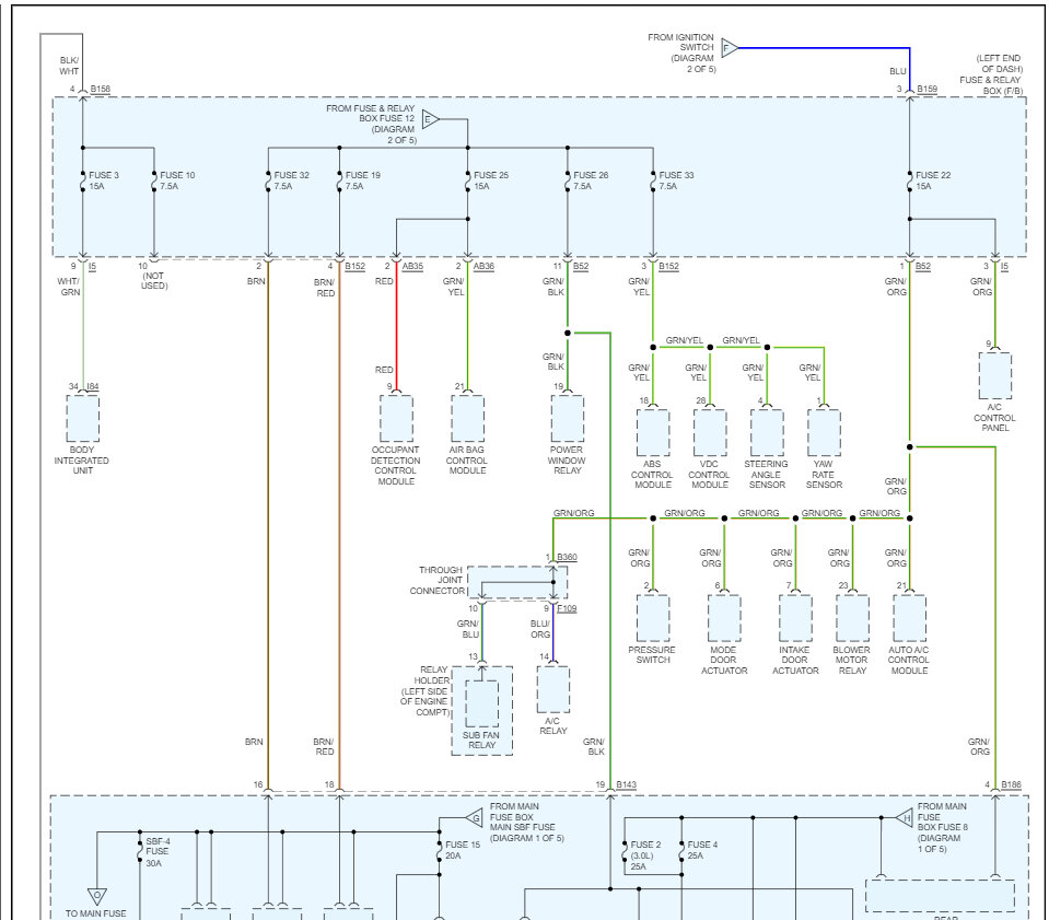

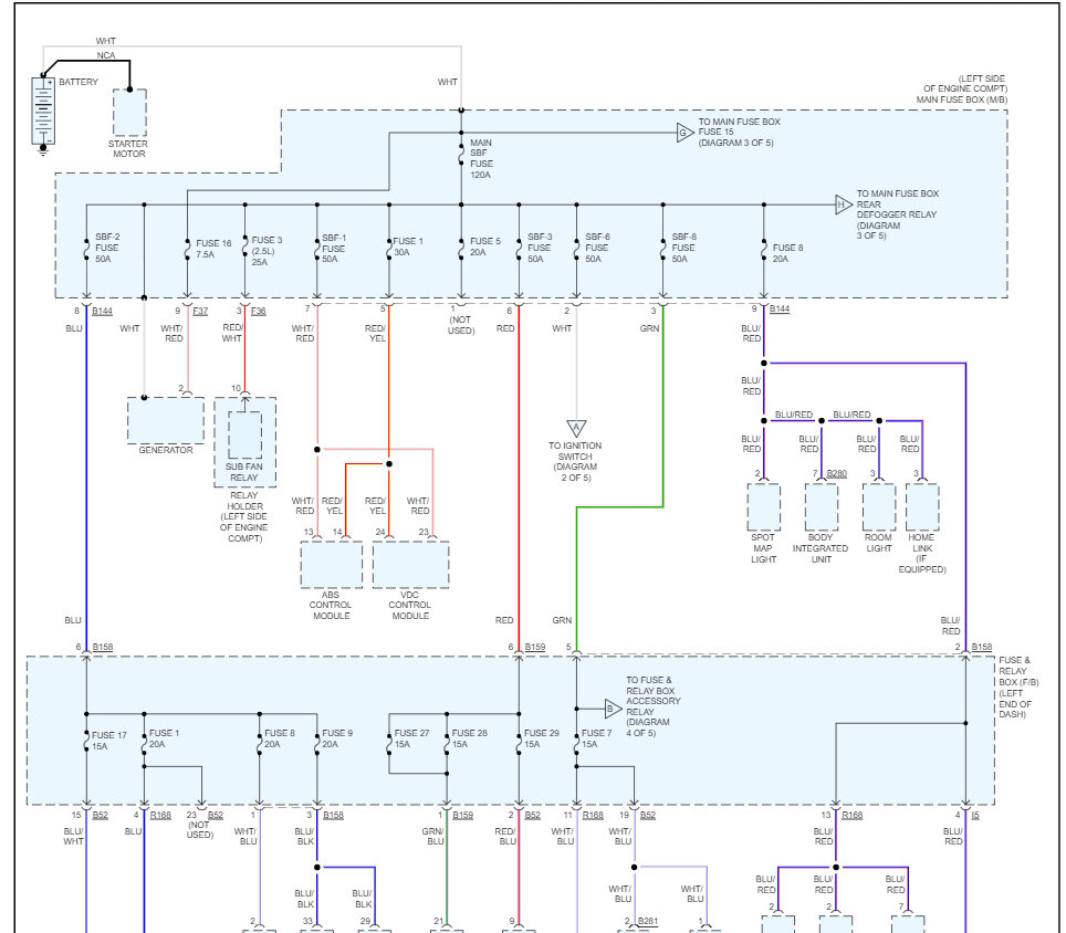

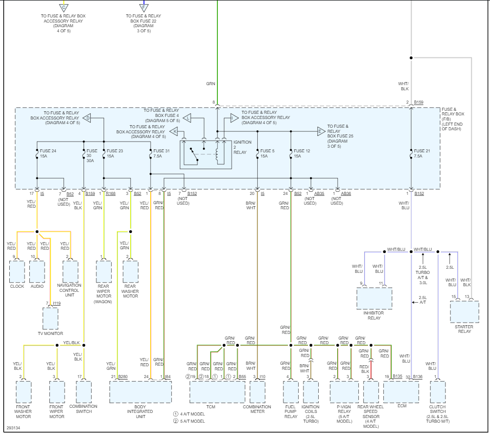

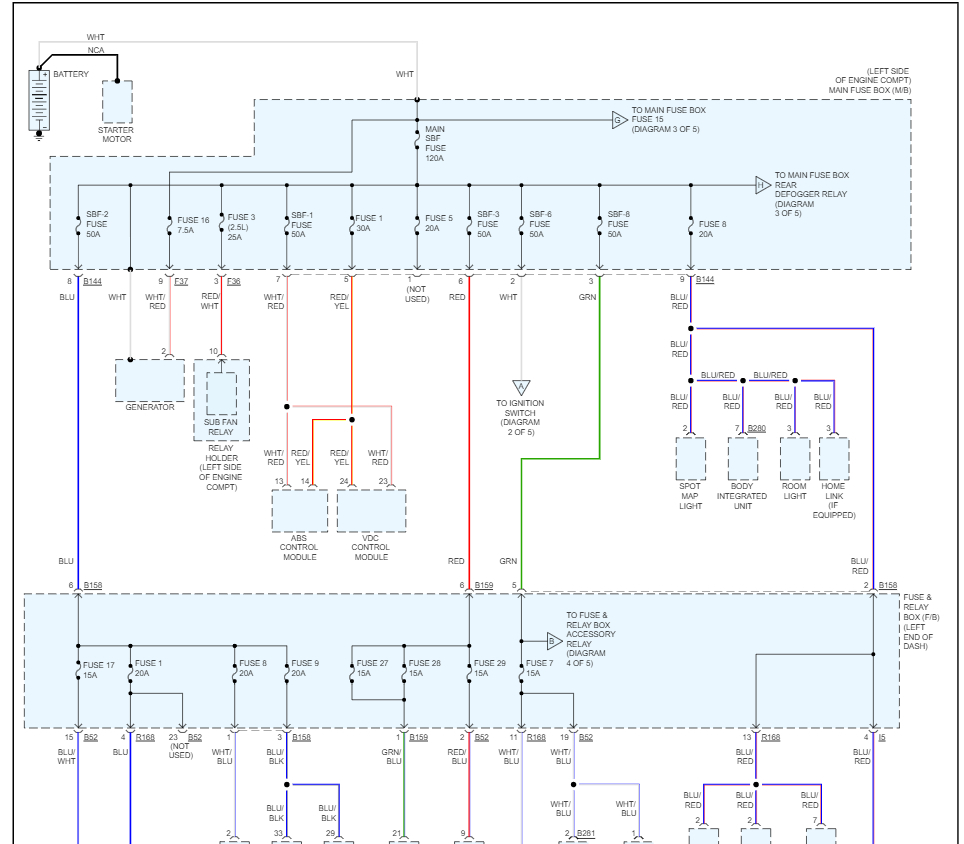

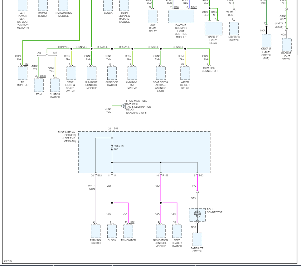

There are two rectangular connectors that plug into the front of the interior fuse box. What are they, and what do they do? They have one single wire and are clipped onto the fuse panel with a yellow clip.
May 8, 2023 at 5:19 AM
  • 55,402 POSTS
Sure, here are the fuse panel wiring diagrams and I have included a guide on how to test the connections.
Check out the images (below). Please let us know if you need anything else to get the problem fixed.
