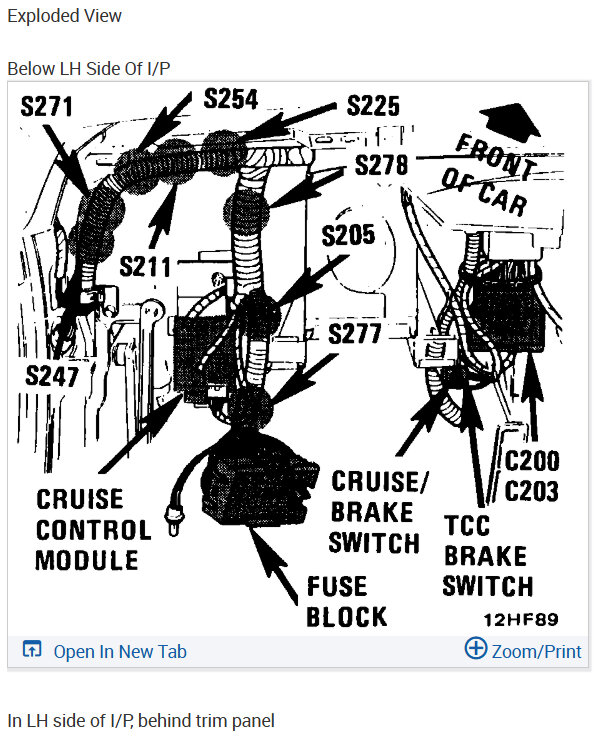

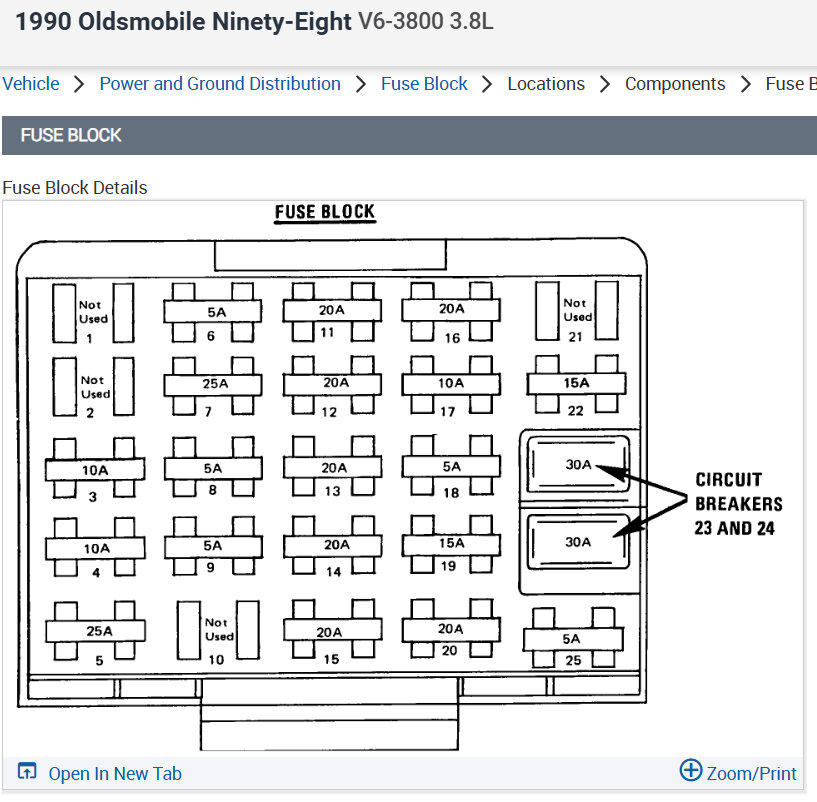

Windshield wipers stopped working as well as the heater, A/C, and defrost. The lights on the climate panel still come on though.
Mar 10, 2025 at 8:08 AM
  • 55,433 POSTS
Chances are the ignition switch or fusible link is bad. Here is a guide to help you check the fuses which are at the left side of the dash:
Turn the key on before checking the fuses for power. Check out the images (below). Please let us know what happens.
