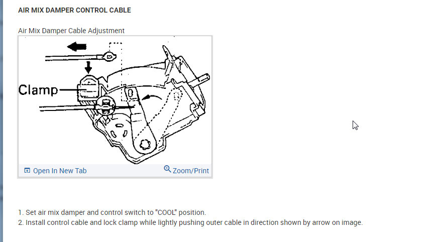

My heater worked perfect then all of a sudden it won't blow HeaT! The window defroster still defrosts but only with cool air! What could be the reason? Where is the inside fuse panel located?
