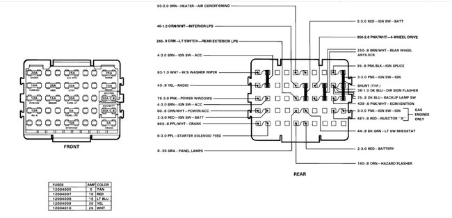

Fuse box inside truck diagram needed?
1989 CHEVROLET TRUCK
209,000 MILES • 5.7L • V8 • 4WD • AUTOMATIC
BRANDON12345
Fuse box diagrams please?
Sep 18, 2024 at 9:47 AM
  • 110,240 POSTS
If you look below, I attached the only one that I have for this vehicle. Take a look at it and let me know if it helps.
Also, to keep it all together, I wasn't able to enlarge it much at all. Let me know if there is a section you can't read.
One other thing, here is a link you may find helpful. Remember, even if a fuse is good, there may be no power to or from it, so that needs to be checked.
See pic below.
