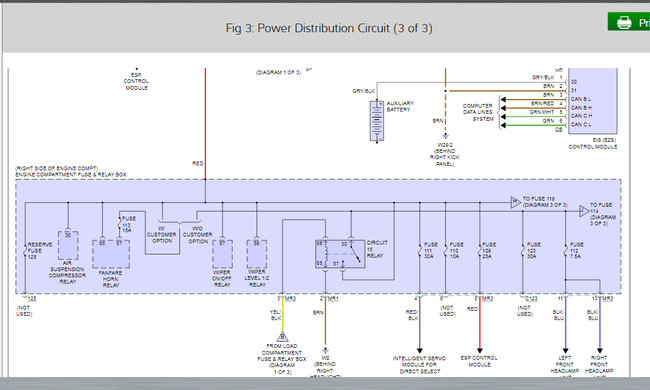

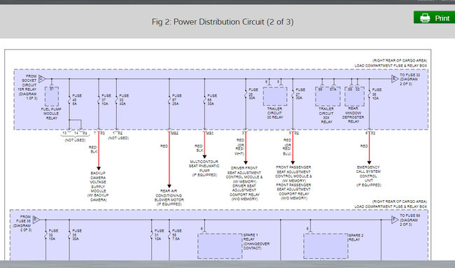

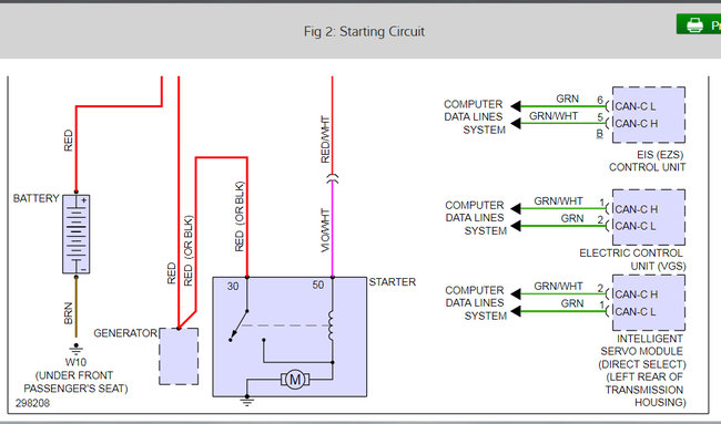

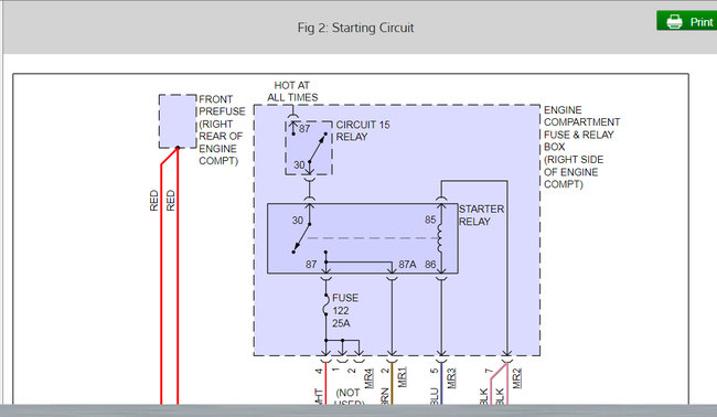

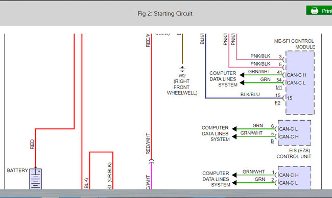

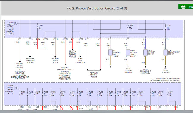

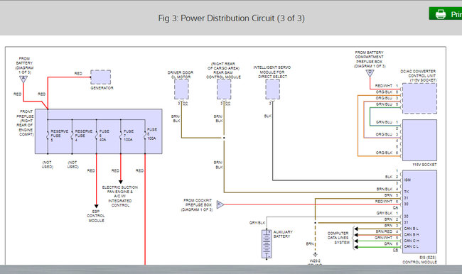

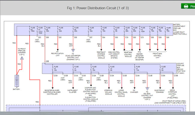

Hired someone to install after market amp and sub-woofer watched as he accidentally caused a spark to the fuse box in luggage compartment by dropping a bolt on it. now car will not start. it attempts to crank but will not turn over. alarm, radio, seats and windows do not work either. also not getting any power to that same fuse box.
May 12, 2019 at 10:35 PM
SCGRANTURISMO
  • 4,897 POSTS

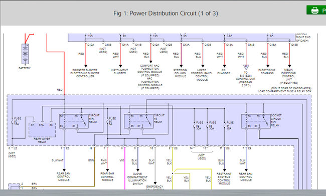

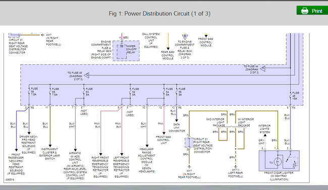

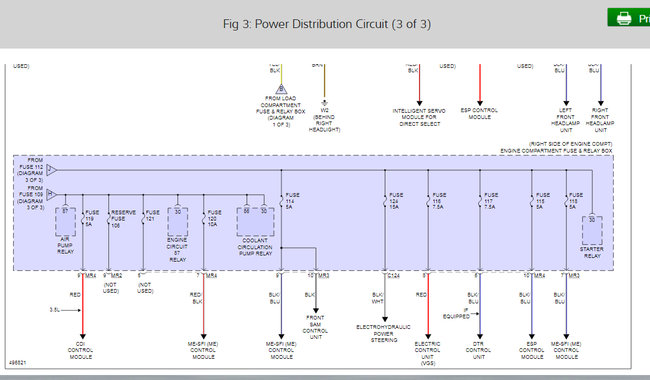

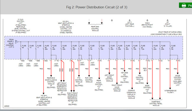

This could be a problem with fuse #82(150A) in the Battery Compartment Prefuse Box under the right rear footwell. I have included in the diagrams down below Power Distribution Wiring Diagrams and the wiring diagrams for the Starting Circuit. Please check this fuse and go through the wiring diagrams and get back to us with what you are able to find out.
