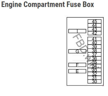

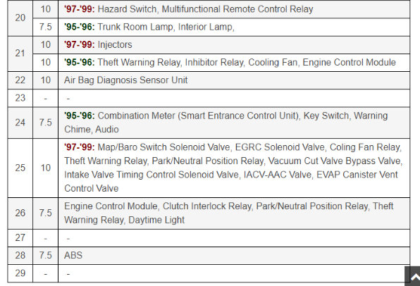

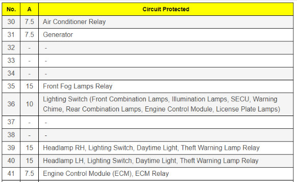

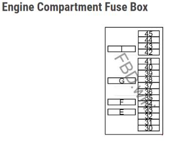

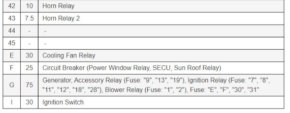

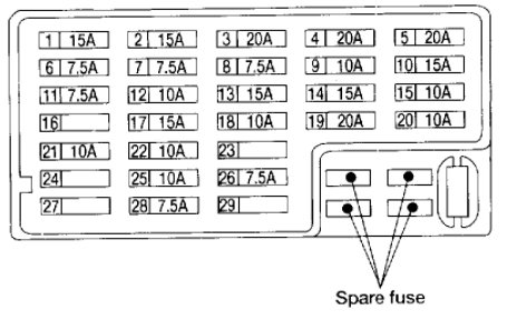

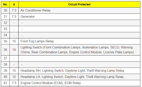

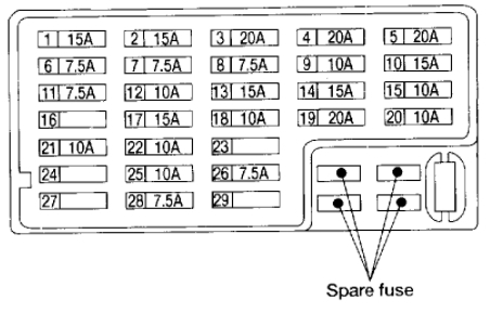

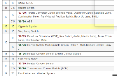

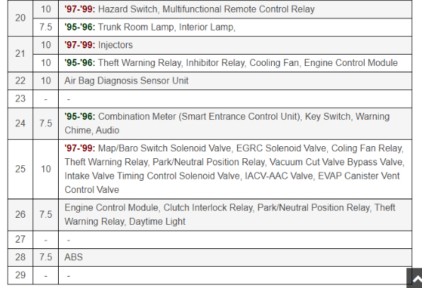

Fuse box in engine compartment faded can you send me a list of fuses and amps ?
232,053 MILES • 1.6L • 4 CYL • 2WD • AUTOMATIC
AZDANNO04
  • 378 POSTS
My fuse box near the battery is faded if you can send me the list of fuses and amps for GA16DE automatic 1.6 liter 1998 Sentra GXE.
Mar 11, 2021 at 8:26 AM
I-SMOGEM
  • 118 POSTS
Hey azdanno04,

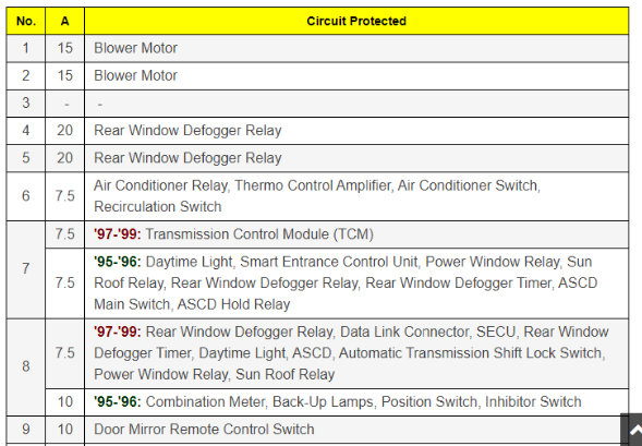

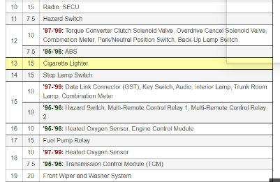

Below is a pic of the fuse block identifying the fuses by number, and the other pics are the descriptions of what the fuses are for the passenger compartment (just in case you needed them too). The next set are for the requested under hood fuse block.
Hope this helps. Glenn
