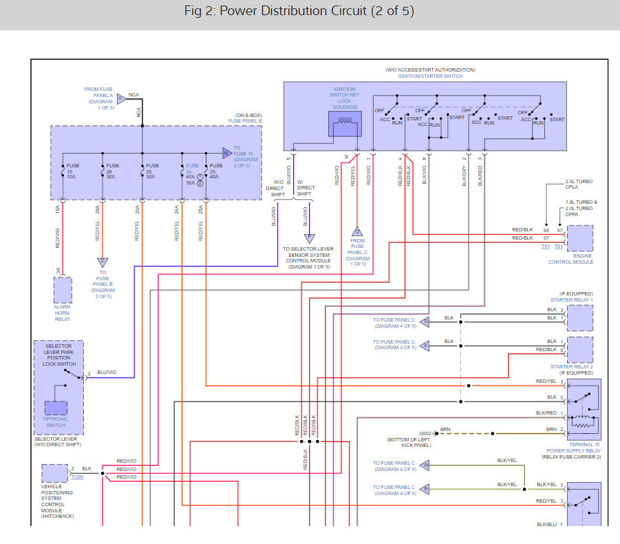

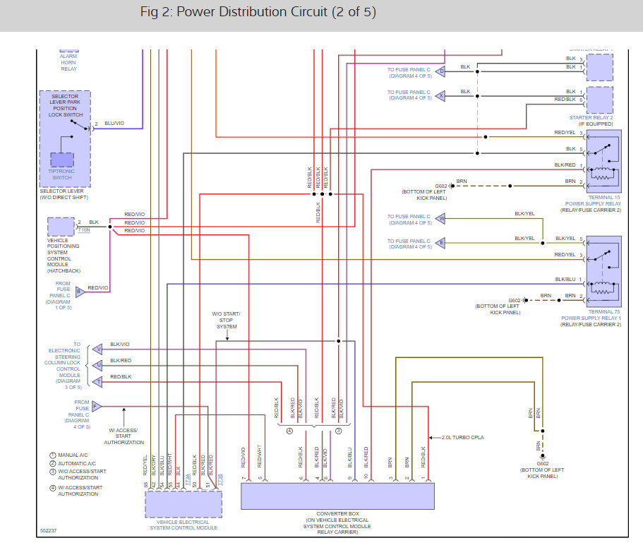

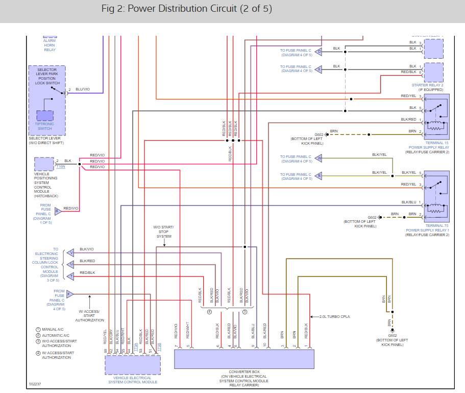

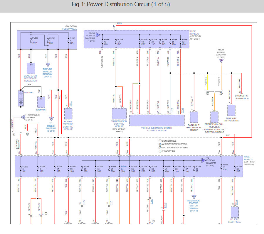

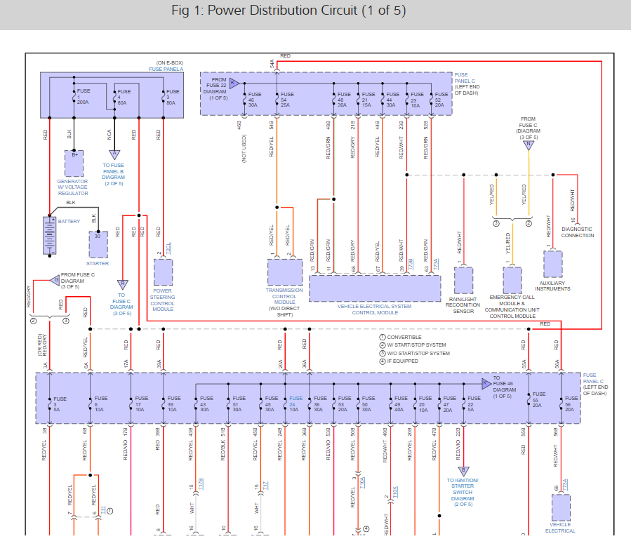

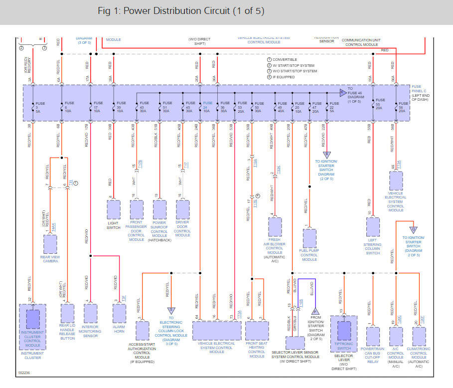

Hello! I am having a hard time installing my dashcam hardwire kit. I need to find a spot to put a two fuses: one that has a constant current and one that has a current when the car is started. They must both be greater than or equal to 10A. Please help!!
Oct 19, 2022 at 11:09 AM
  • 55,421 POSTS
This will depend on how accessible the wiring is, the ignition switch wiring would be best which I have included the wiring diagrams below, if you can connect to the red/violet wire for constant power and the black/red wire for the switched power. Check out the images (below). Let us know what happens and please upload pictures or videos of the problem.
