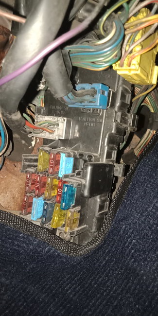

I am trying to find out where exactly the fuse of cigarette lighter? I found the fuse panel although there is no guide to which is which.

Thank you for helping out. Based on my certificate of registration it does says Mitsubishi Lancer 1989 model. I also took a picture of what my fuse box looks like but there is no cover nor any label to guide what fuse belongs to what.

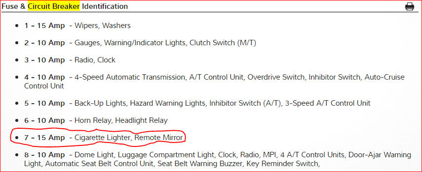

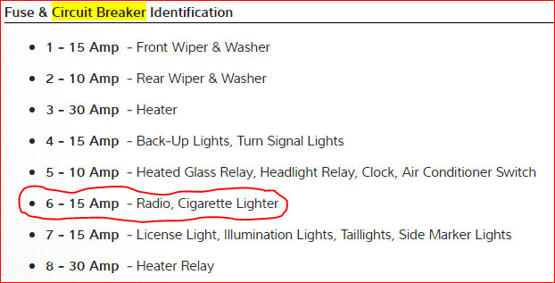

I have attached a few picture as a reference.The first is based on an 1989 Precis which shows fuse for cigarette light as location #6 a 15 AMP fuse. Second picture is based on an 1989 Mirage showing it as location #7 a 15 AMP fuse as well. Hope this helps! Danny-

Thanks for your help Danny. I was able to locate the cigarette lighter although it was a 10 AMP fuse, replaced it with a 10 AMP as well and the lighter was able to work.
